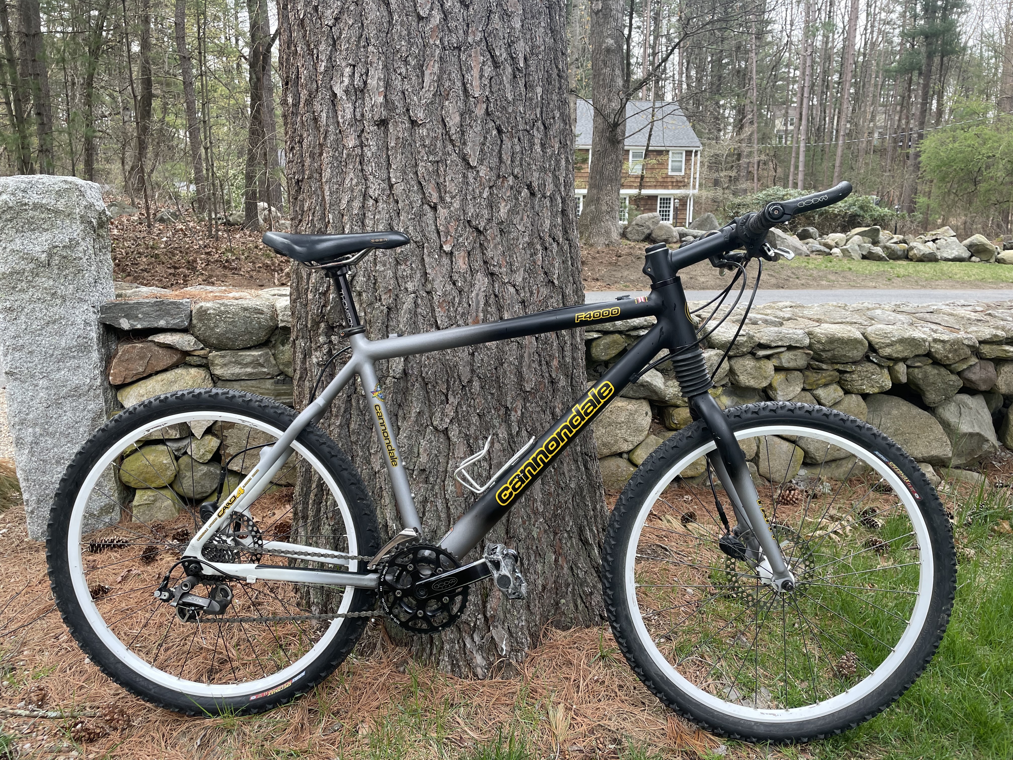

Kicking off a project to bring a 1999 F4000 back to life.
I found it on FB marketplace for $150.
It looks nearly entirely stock, with the exception of the pedals and the stem (the stock stem was included). It has CODA Expert calipers instead of the flaky CODA Compact Discs that would have come on it. Perhaps it came with Expert discs. As I read, Cannondale was replacing the Compacts later in the model year.
Planned work:
Clean
Tune, oil, etc.
Touch-up paint where possible
Rebuild Headshock: Off to Mendon Cyclesmith
Repair Brakes: They are weak now, so I'm hoping a set of pads will straighten it out.
Swap back to stock stem
New Pedals
Remove Dork Disc
Replace Tires: Although, I think it's still rolling on the original rubber!
Any suggestions or insights are appreciated!

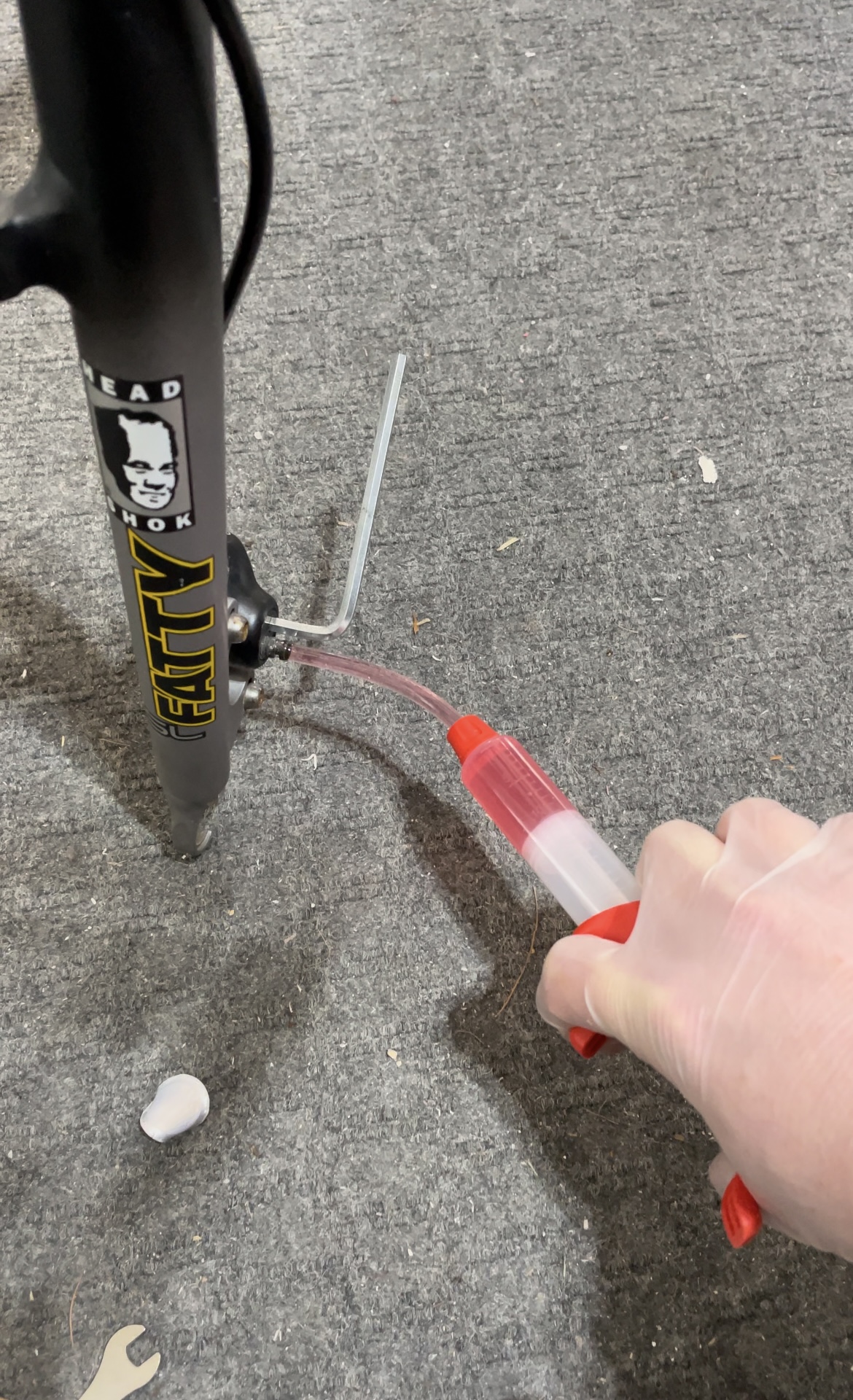

PL4
Fresh brake fluid, there was a considerable amount of air in the lines. Brakes are almost like new, the replacement pads are in the mail.

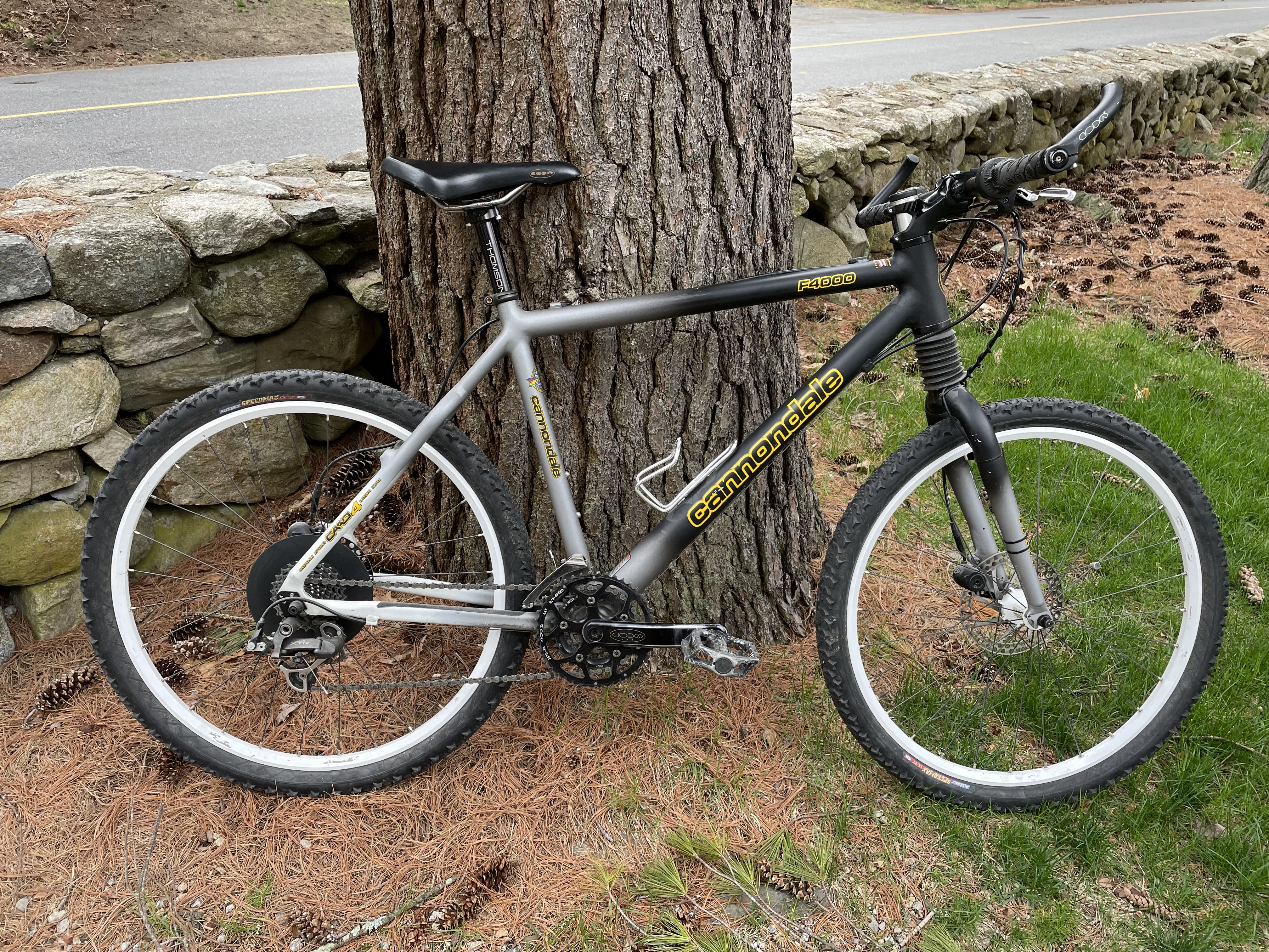

PL4
Degreased, cleaned and a bit of wax today.
New pedals, while not era correct, they match nicely.
Tomorrow the Headshok comes off to send out for rebuild.
Do I ask to try and keep the old style shock boot, or go with the modern boot?
My F1000 has the new style on it after a rebuild.

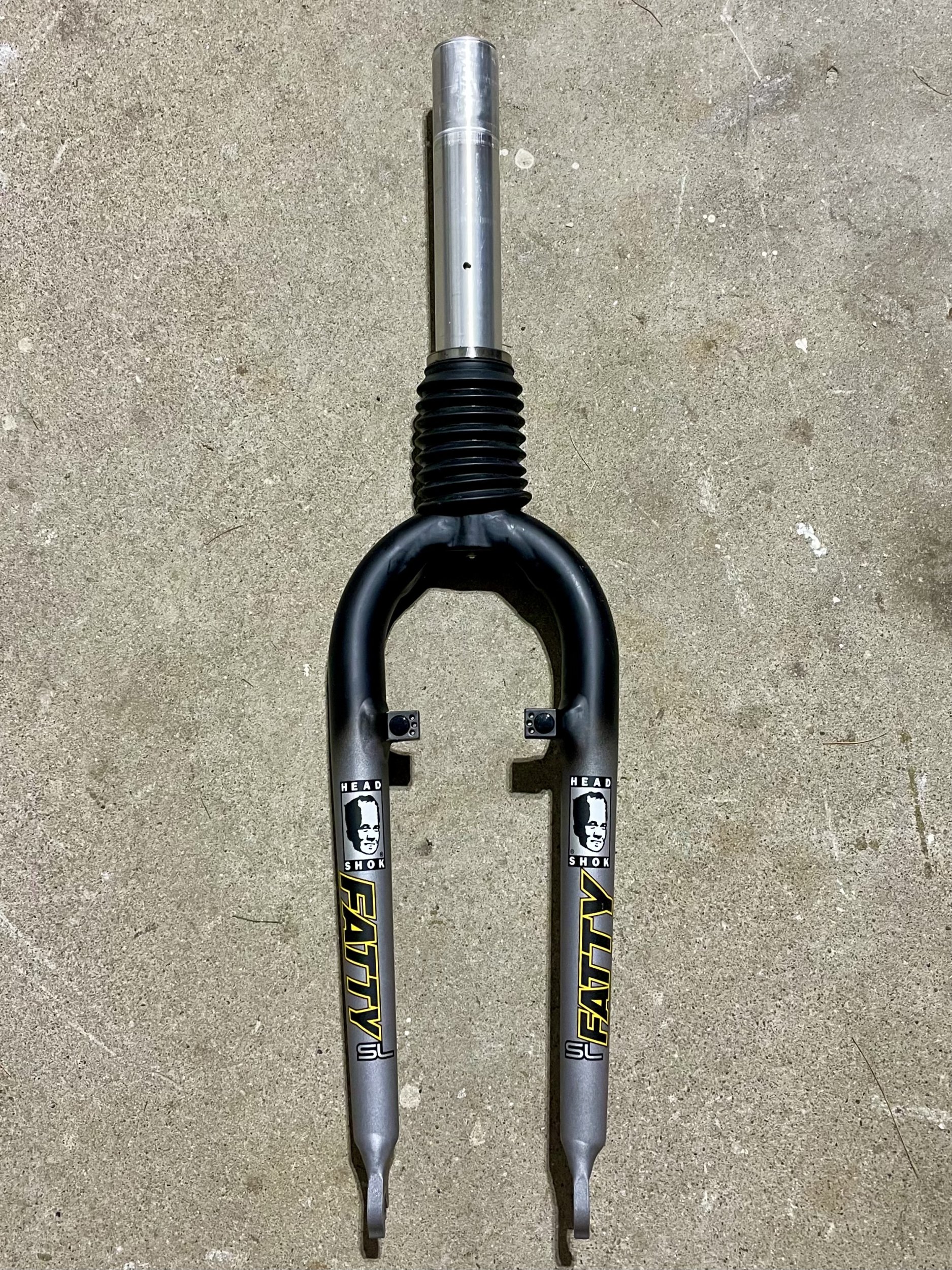

PL4
Finally got around to taking the fork off.
The shock works smoothly, but is soft and the damper control doesn’t do anything. I pumped it up, the previous owner gave me a shock pump with the bike, but adding air didn't make a difference.
Off for a rebuild.

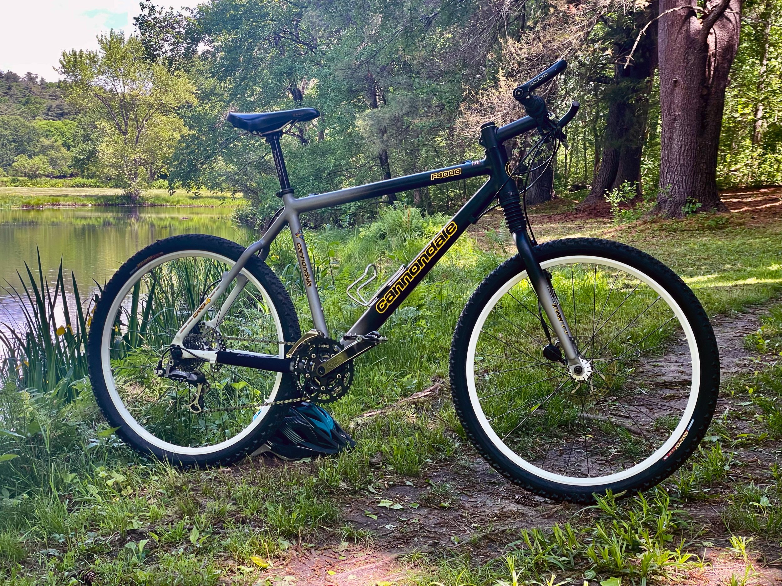

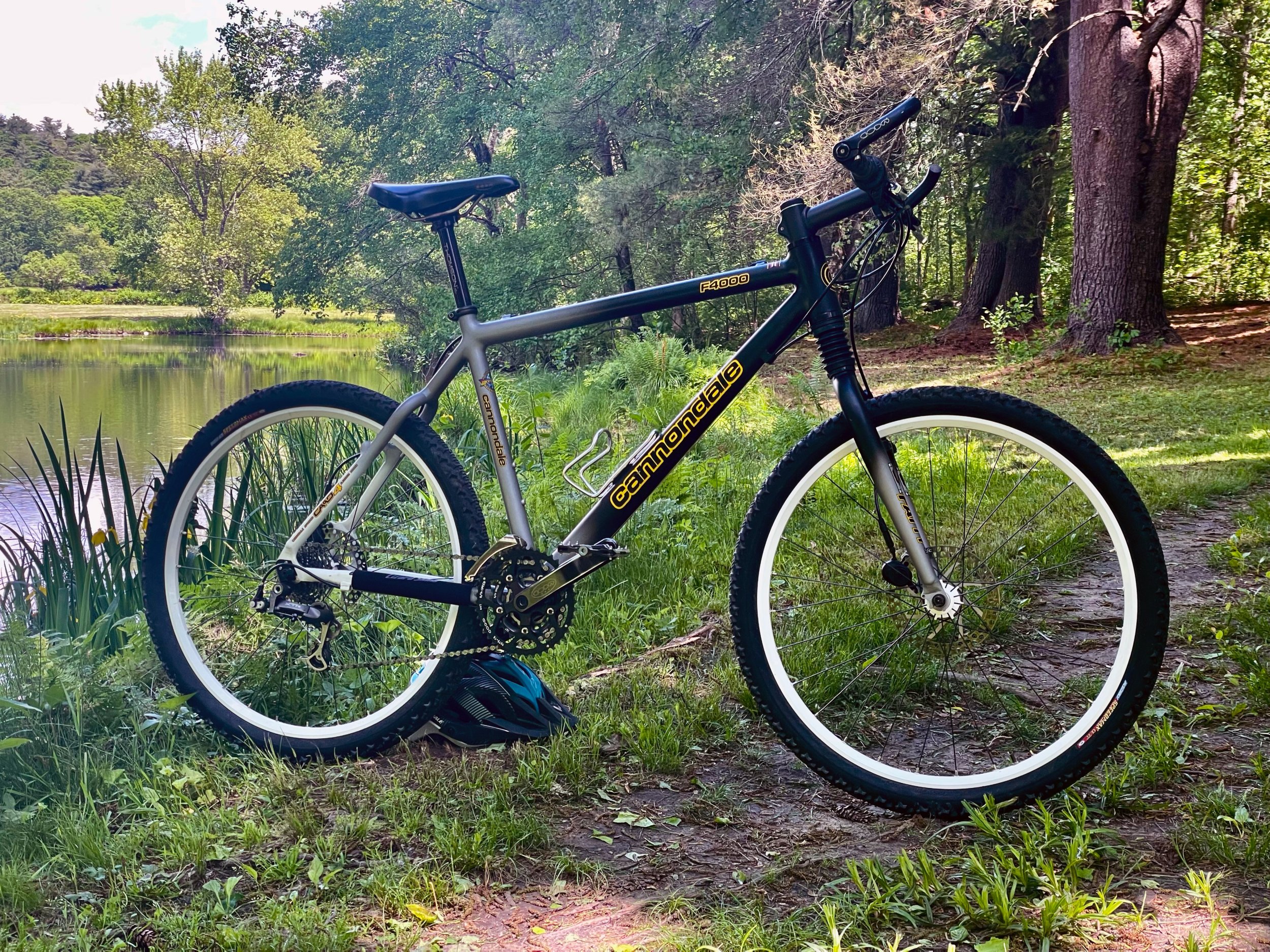

I got the fork back from Mendon. The factory boot had a hole in it and needed to go.
The bike rides great, definitely happy with the rebuild.
Does anyone have any leads on CODA Weave or Calamari grips?
With Gripshift do you typically shorten the grips?
Maybe it's the change of background, but the bike looked nice before. Now it just looks plain awesome!

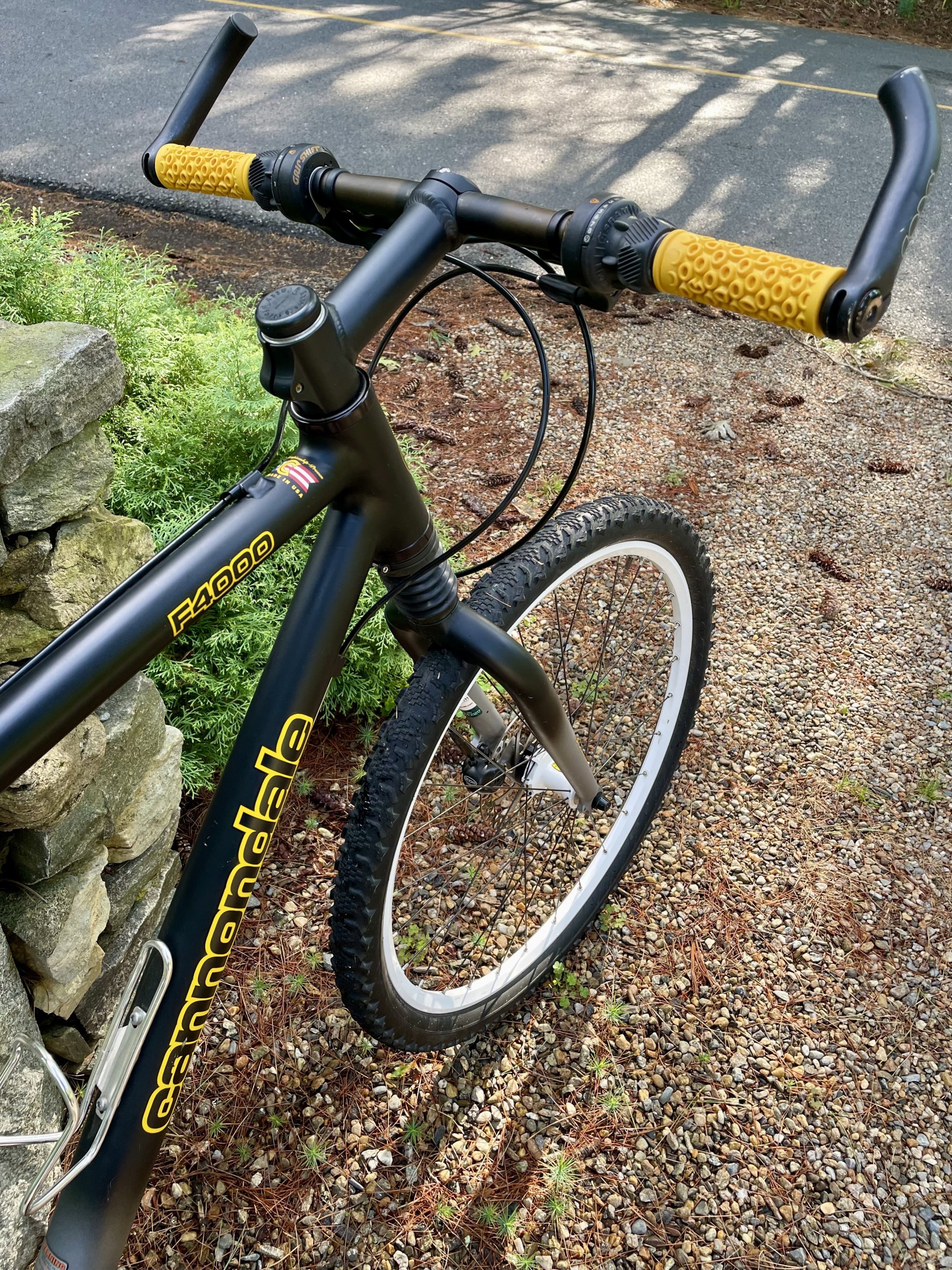

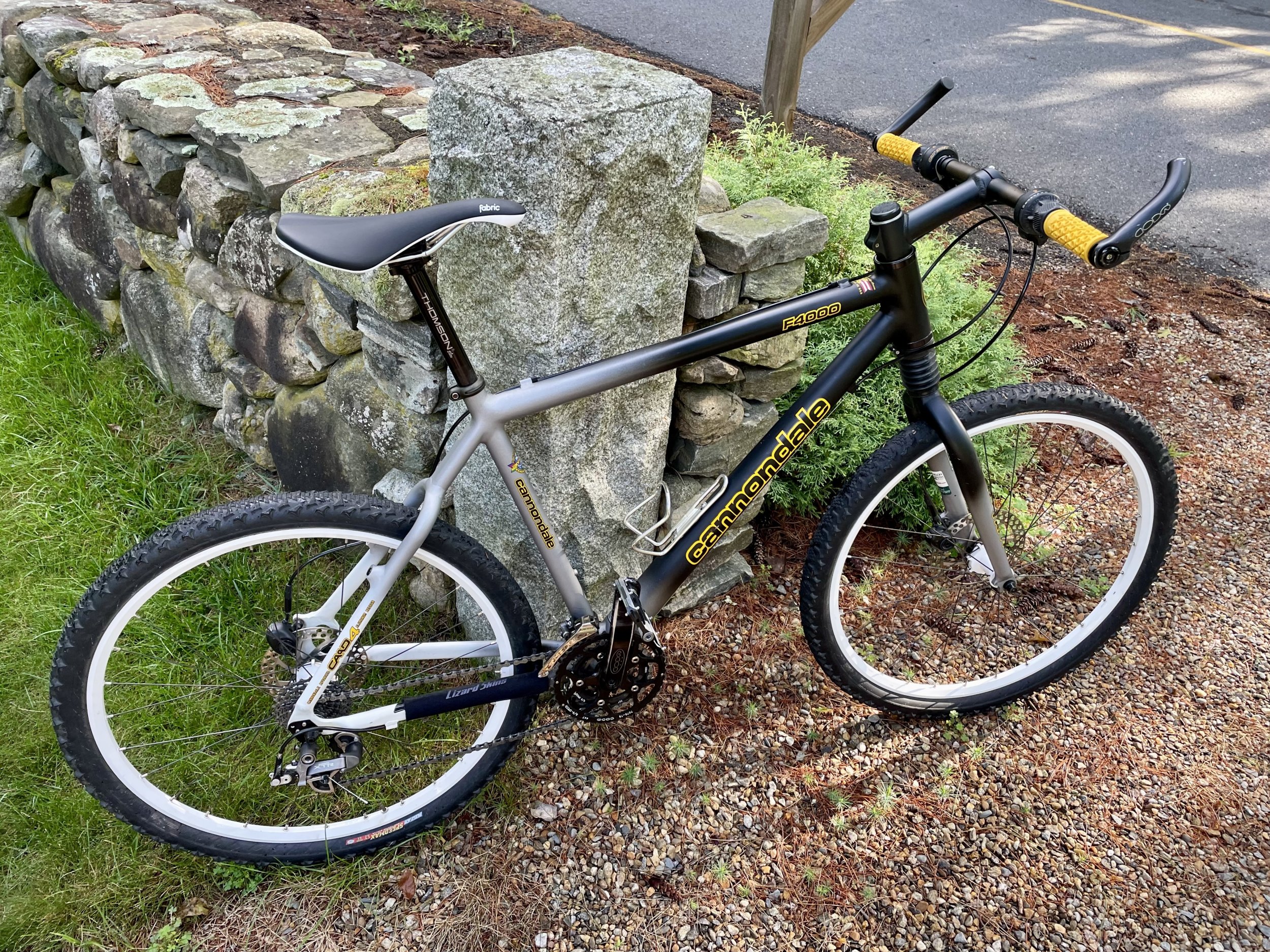

A couple of updates on my F4000.
I found some nice CODA Calimari grips on eBay. The bike would have come with black Calimari grips, but I like the yellow with the graphics.
I also swapped out the saddle for a Fabric Scoop. The original CODA 1000 Saddle is in good shape but not very comfortable; it is stored away for now.
