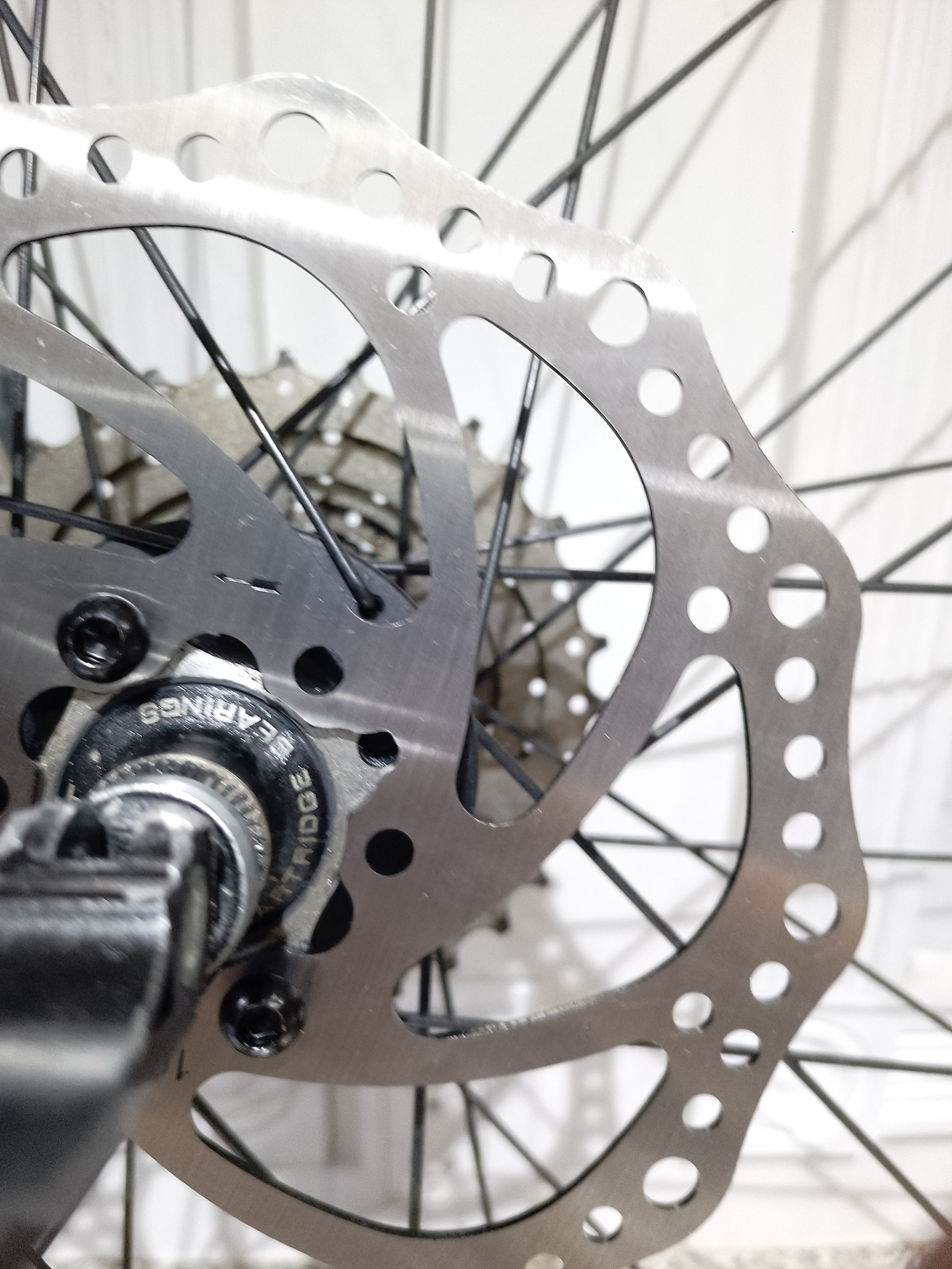

So, here is the result of chosing a disk that had some meat in the center, marking out the missing holes, and grinding material away around the marks.
Unfortunately, I'm now off to figure out the clunking noise that was not the disc brake!
Axle (er skewer, maybe not the same thing?) seems ok.
I assume this is all related to the shoving in the car part after stealing the bike back as it wasn't like this before.

It was the axle.
So, my options are a new wheel, a rebuild kit, or a new hub. Oddly, a set (not a lefty front, but front and back) of coda 4 bolt hubs are up on Ebay for $50 CDN which, given I figured out the rotor issue, seems like perhaps an option that keeps things a little more stock (I have to say that I don't think the actual hydraulic brakes are stock though). I am assuming I could swap out the axle of the Ebay hub and save the hassle of changing the wheel, and have some spare bearings as well.
$30 if I can pickup, so maybe I will try that. Seems like a good option then. At $50 I could just keep an eye out for a decent 26" disc hub.
