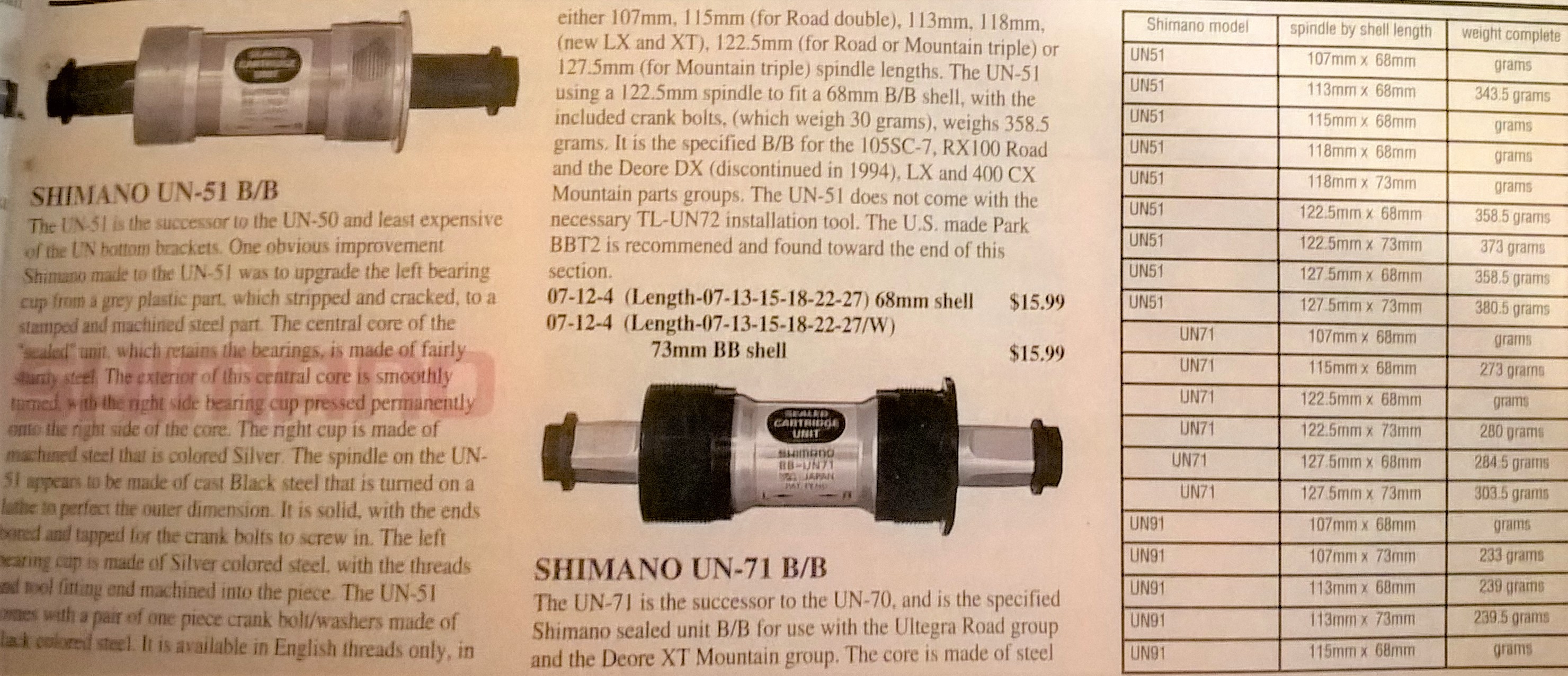

The only explanation I can offer is that the BB shell didn't get faced to the right width during the production process. You haven't provided the year of the bike but I'm guessing that it's 1992-3. Shimano BB-UN70 was the BB that was specified for the XT equipped bikes at the time. The UN70 was replaced by the UN71 around 1994 along with the UN51, which was the contemporary LX bottom bracket. Both the 71 and 51 have a left hand cup that lacks a shoulder, so either should work fine in a wider shell as long as the right hand cup placement gives you a good chainline. I have much later NOS UN26 122.5 BBs on hand but I'm pretty sure that they are made for E type front derailleurs and would require a spacer under the drive side cup if used with a clamp-on front derailleur. Dirt cheap though.

Good call on the year - the seller didn't identify the year but looking through the catalogs shows a match to the 92 M2000s.
FWIW, the serial number is 51801933828, but most important is your clue that the UN71 and UN51 don't have a flange on the left cup to take up the extra room from a 68 cartridge. That means that I can stop looking for a 70x122 BC cartridge and modify a 68 to work. Shouldn't be hard - either find a cup from a 71/51, or trim off the shoulder from the one I have.
