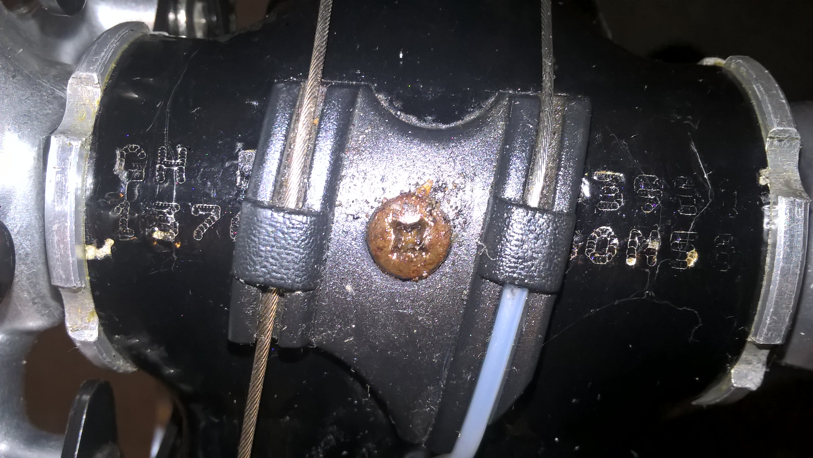

I have a CAAD4 that has a very unusual serial number configuration. I realize the fairlead is in the way, but it reads:
585 <fairlead> 451 (all of these are numbers, not letters)
2RR <Fairlead> ? 56

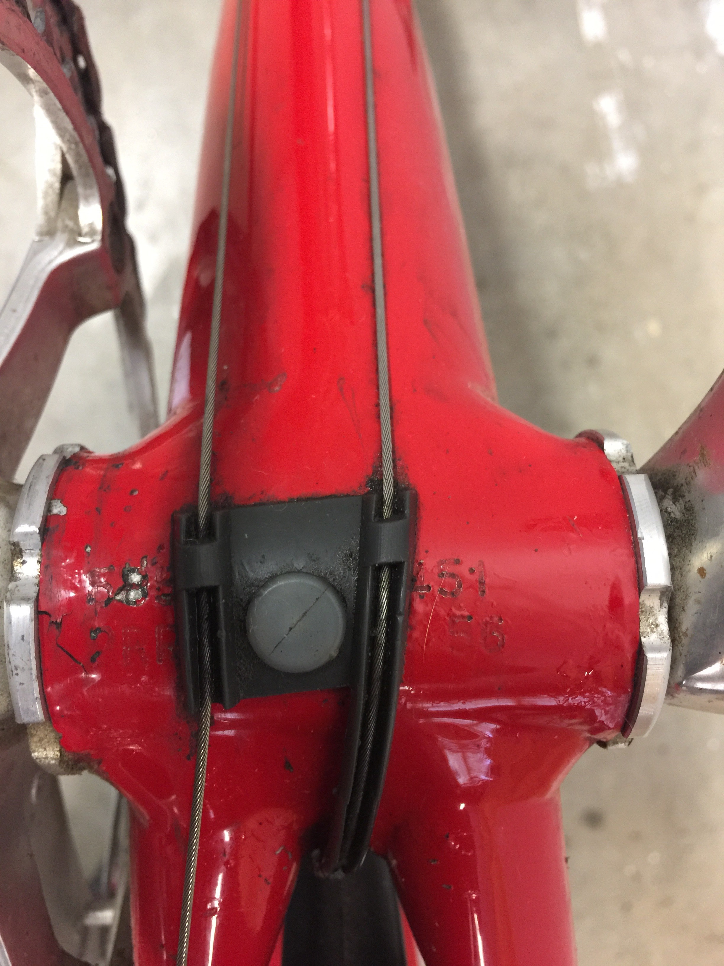

I'll post a pic, but a couple of things. The frame appears to be no earlier than 1999 and it is probably no later than 2001...
The 56 in the lower right appears to be hanging out on its own.
I'll post a pic. Let me know what you all think this is. The frame seems to measure as a 56 likely... I get 21.25" from center of BB to top of top tube. That's 53.975 cm or 54cm. According to all the geometry charts I can find for CAAD, generally it appears that you add 2 cm to the measurement referenced for the final frame size = 56cm.
So I am hoping this is some kind of weird alternate serial with the frame size being on the lower right. However, beyond figuring out the size, I'd also like to understand what kind of weird alternate this is and what people can tell me about the bike based on it?

Cannondale had drama in switch from 1989 to 1990 and from 1999 to 2000.. Do you have a full photo? or is there another SN? There would usually be 2 letters to determine the year. They might be under the guide.

No other serial. It's all under the guide. Interested more in frame size than year, but it is so weird that I am intrigued and trying to figure out what gives. I do think the isolated "56" in lower right corresponds to the frame size. My measurements pretty much confirm that, and frankly it fits higher than my CAAD10 54 and about the same as my SuperX 56.
It's just weird, because it should either conform to this for 1993-1999
Notice in this figure that there is a
1. long, ie not short, string of numbers lower right, and;
2. the two letter year/month, upper left.
A. Mine has a long string on the upper left starting with a number, not a letter - "585" as far as I can tell, and
B. Only two digits, not letters lower right, ie: "56"
Then there is this for 2000-2001
This LOOKS more promising and it is. However, here we have the year and month codes in lower right and it should be a letter followed by a number. Valid letters are: L= 2000, M = 2001;
Mine is very clearly a "56"
It's not a 1986-1992 for sure and it is not a 2002-Current. See reference here: https://vintagecannondale.com/info/serial_numbers/
This is some kind of odd variant Serial number.
I am guessing it is at the 2000 boundary. There are things about the bike that clearly date it to 2000 to 2001. It has a complete Campy Daytona group set. Daytona seem to have replaced the former group set at that level in 2000, and was itself renamed to Centaur in 2002. The fork is very clearly a 2001 based on its paint scheme...
Thoughts? Were there other schemes? Transitional schemes?

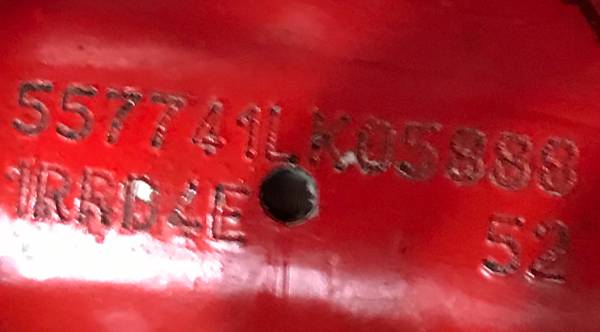

This is not my serial number. It comes from a red R600 CAAD4
However, I am very clear that this is the FORMAT of my serial number. This format does not conform to any of the formats presented here on Vintage Cannondale.
If this is indeed a 1993-1999, then the only pair of letters that make sense are "LK." In this case the letters would have to be revered. The diagram shows the order as Year and Month. If "LK" were the letters it would have to be Month and Year or November of 1999.
E = 1993, F = 1994, G = 1995, H = 1996, I = 1997, J = 1998, K = 1999
A = January, B = February, C = March, D = April, E = May, F = June, G = July, H= August, I = September, J = October, K = November, L = December

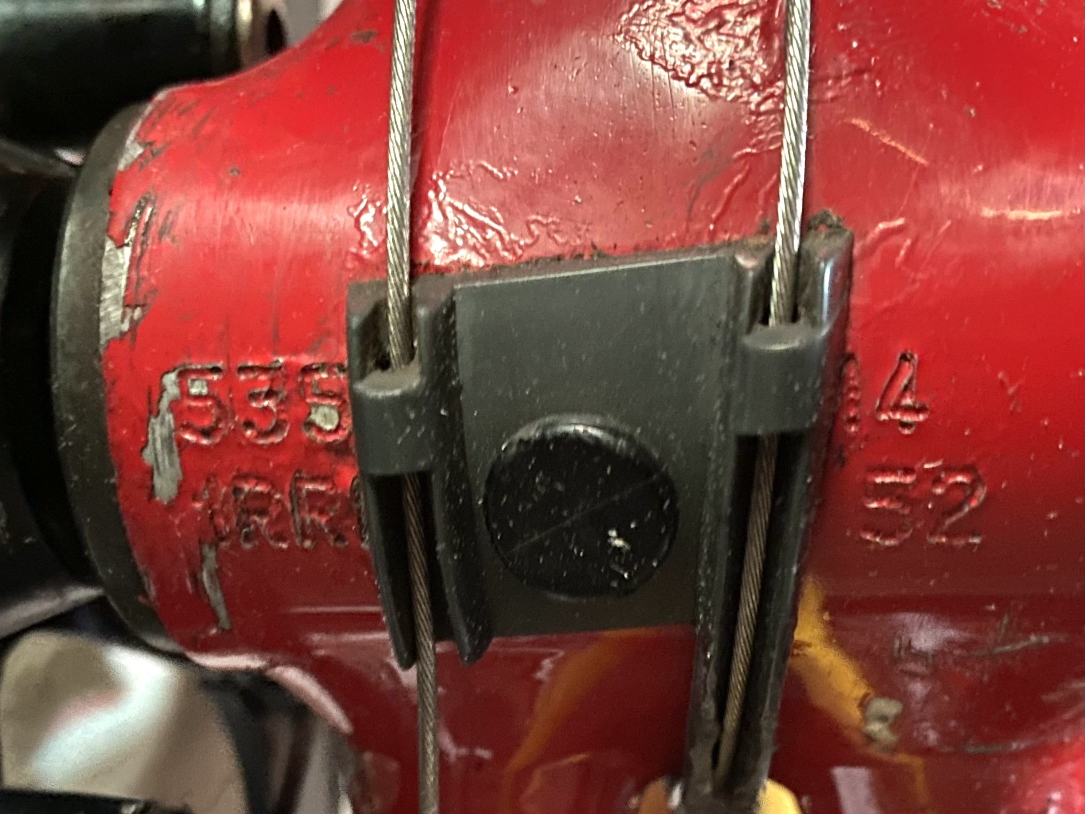

Did you take the serial number picture of the 52 cm frame? Since it doesn't show the whole width of the BB shell, I'm not convinced that there is no separate two letter code. The two letter codes on my frames are well to the left of the frame code. Does the 52 cm bike conform to a 1999 model? Will be interesting to see if there's a two letter code in your frame number that puts it in the 2001 model year window.
Great question... No. The 52cm is clearly marked as an R600 CAAD4. In 1999 the R600 was a CAAD3. Good point! So this is not a 1999 format. In format it looks most like 2000-2001, but the two letter code is missing.

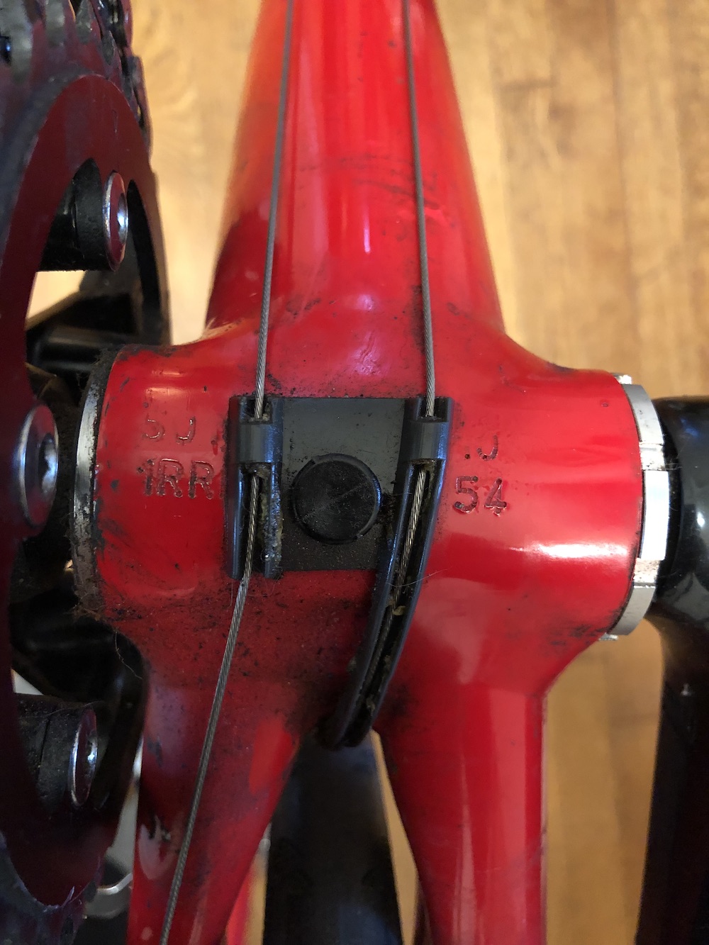

I just bought a very similar used Cannondale and am trying to identify the serial as well. Pic below. Sorry for the novice question but is there any way to identify the full serial without removing the fairlead?
What I can read is
50 <fairlead> 10
1RR <fairlead> 54
I do not think so. I will say this. I remain convinced that this format is not accounted for in the literature I have seen.
Based on having seen this format quite a few times now and based on sizing the bikes I have seen, I know that 54 is the size. I have additional theories but cannot prove them.
Matt Lewkowicz
Damn. So, if I wanted to register with the bike index, or the local police, how would I do that then? I live in Brooklyn and have had 2 bikes stolen so I'm trying to behave with only best practices from now on.
If I was going to register it, I'd remove the cable guide and photograph all the numbers. You don't have to disconnect cables: just shift to the big chainring and big cog while turning the crank - then shift all the way in the opposite directions without turning the crank. Should result in plenty of cable slack to move the cable guide far enough out of the way to photo all the numbers. I would also photograph the bike in a location that isn't a public place - identifiable as your house, your parents, etc.

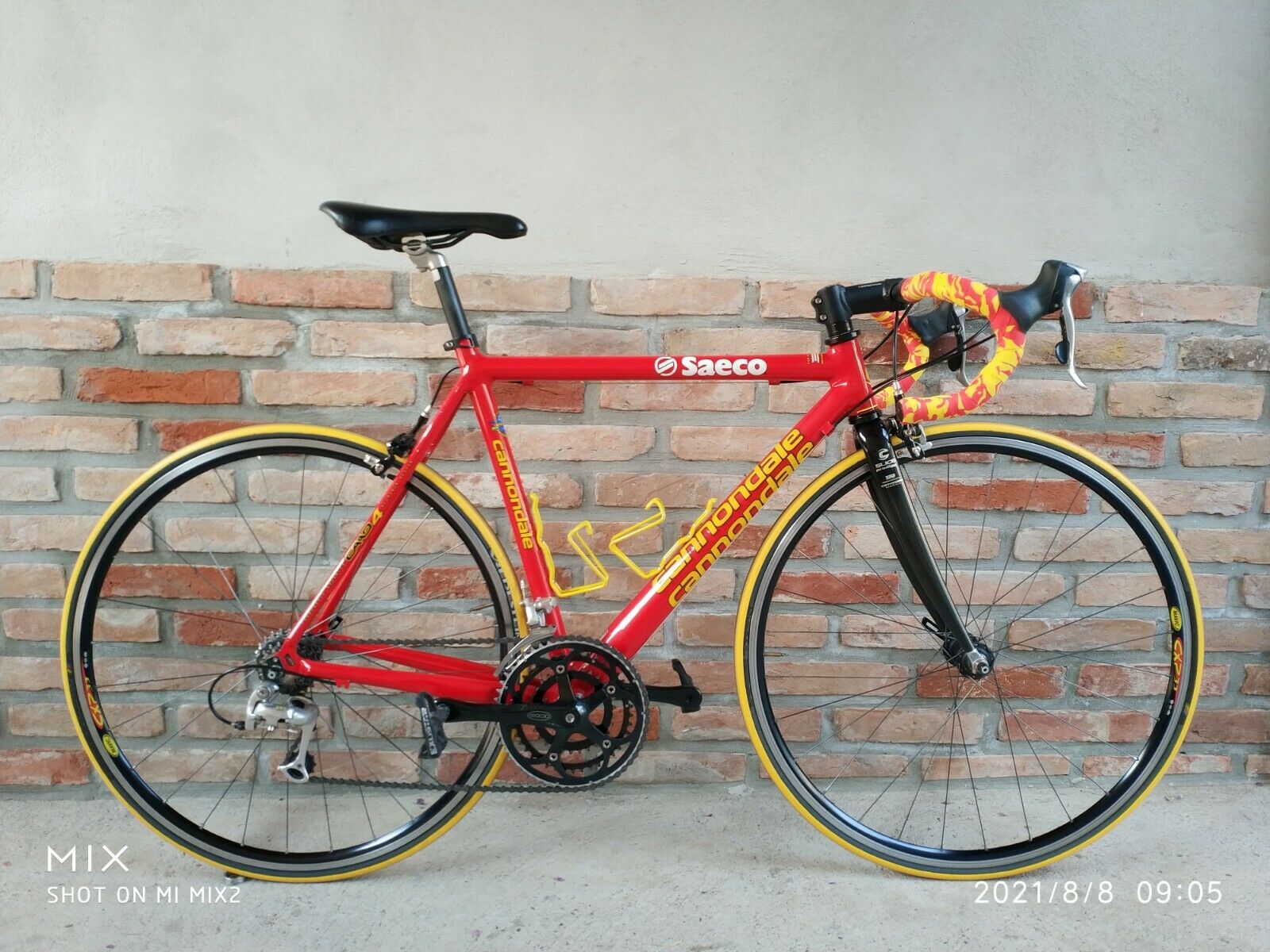

Reviving this as I got into the same issue; Could it be a Silk Frame (by looking at the very short head tube) with road fork?
With the exception that it's a CAAD4 frame, that looks like it could be a 2000 Silk Road 400 - which is shown as a CAAD3 in the catalog. The 400 had mostly Tiagra components with Coda crank and brake calipers and CXP11 rims. CAAD4s originally had 1" head tubes (35 mm OD), but later ones may have had 1 1/8" (43 mm OD) head tubes. The Headshok Silk Road head tubes measure 54 mm. Your frame is a 52 cm frame. If the head tube measures 54 mm, it's definitely a Silk Road. My guess is that they may have quit making the CAAD3 Silk Road frames at some point during the model year, after the catalog was printed. The only difference between the two frames was that the CAAD3 had straight seat stays, and the CAAD4 had the S bend stays. It was likely cheaper to make all the Silk Roads CAAD4 than to continue to produce both.
