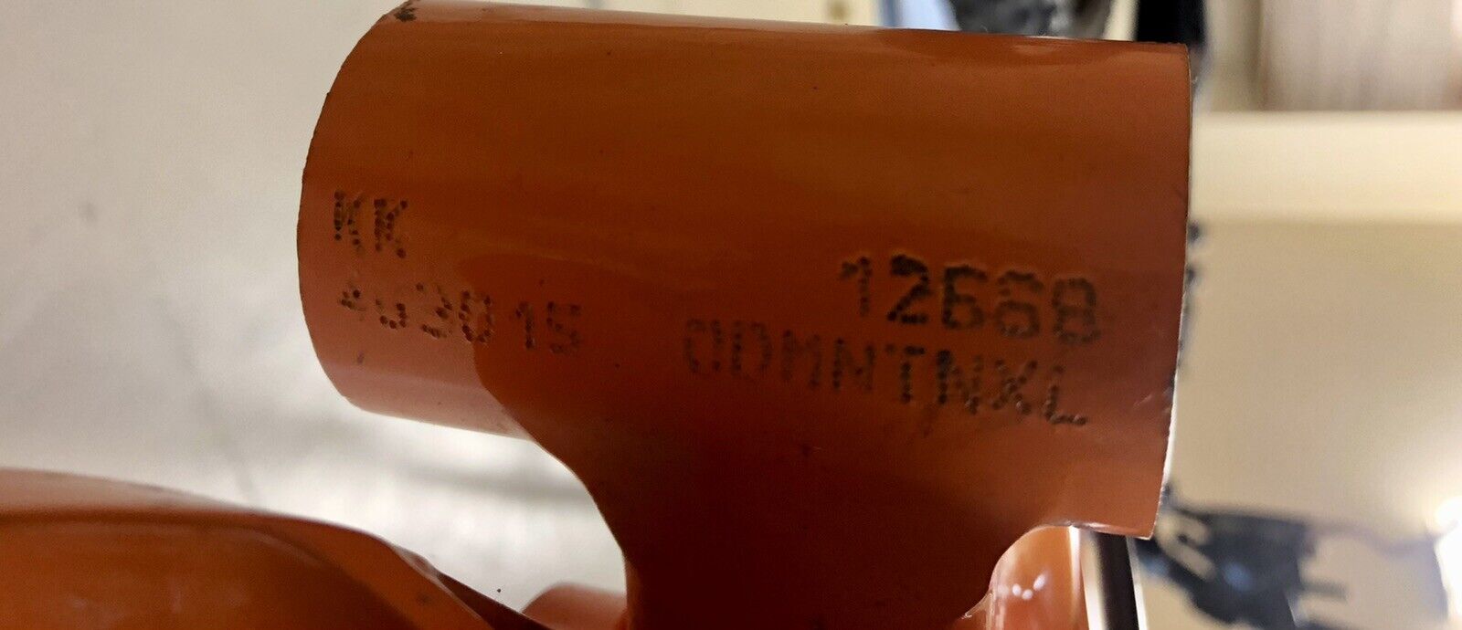

serial numbers: need to track down the year for sure:
4FCR30 LG
932343PA01739
bar code 204154

serials on the bb shell
tag says '04

Hub shell stamped 100 703 ( july 2003?)

And I thumbed through the owners manuals for the hub and the bike. I found these in the back of the manual. Pretty clear this is a 2004 model. Right down to the second the label was printed. Located in the 2004 catalog only in this configuration. They identify the serial number as the sticker on the frame, not any of the numbers stamped into the frame. Not a good practice as a sticker is too easy to remove. I had a carbon Cannondale Synapse that had a similar sticker (and no numbers in the frame) but I found many others at bike index with the same serial number. Is "LG" the frame size and not the year/month?
I thought it looked like full length housing. I was trying to make sense of the frame build date as well. The only thing I can think of is that there might have been a delay getting the 3 x 9 components. Perhaps the frames did sit around for over a year before being built.
It wasn't uncommon for Cannondale to do that. My 2001 Jekyll has a build date of 1999! It almost makes me wonder if Cannondale was thinking of releasing the Jekyll as a 2000 model but for some reason decided that 2001 would be the first year.
