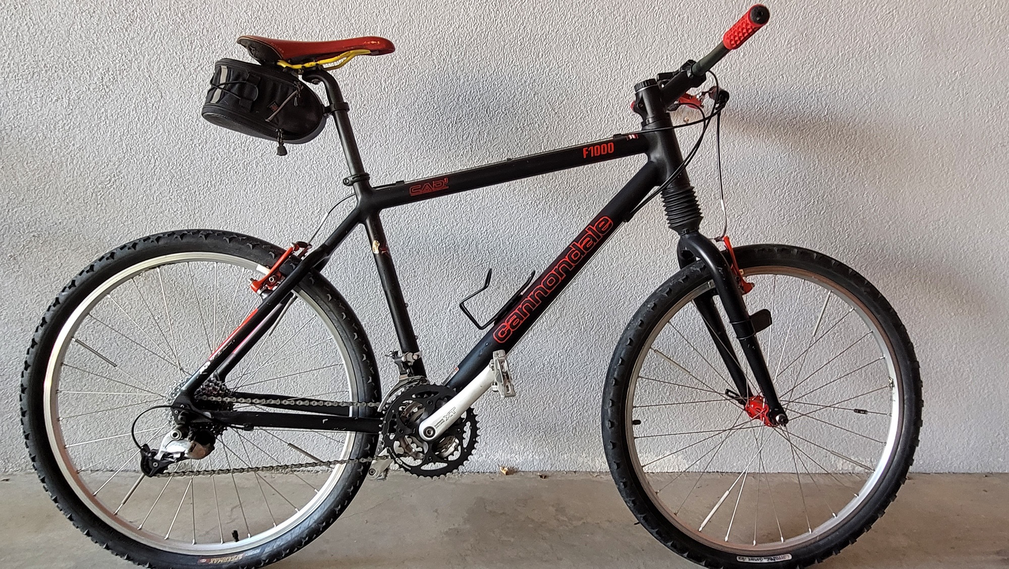

Bought this one for $130.
It's not in best shape, but it rides great and the components work great as well.

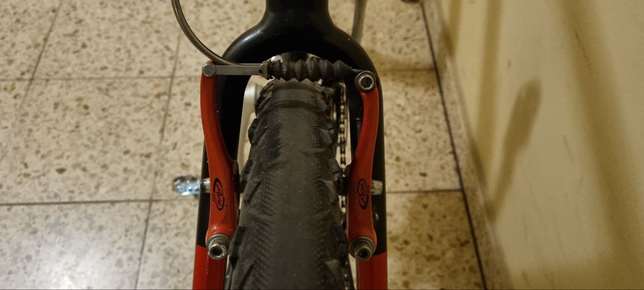

There are components missing, as you can see in the pictures.
Both shifters for the front- and back-derailleur, as well as the only break lever are on the left hand side of the handlebar.
I am planning on swapping both shifters for two Shimano XTs and I've been looking online for an additional Avid SD-2.0L (red) for the right hand side.
What do you think about this Cannondale?
What year was it made?
What's the name of the edition?
Which parts would you suggest me to acquire in order to restore/improve it?

Guessing it's a 1998 though black isn't shown in the catalog on an F1000. Believe the F1000 only had the CAAD3 frame in 1997 and 1998. Check the two letter code stamped in the BB shell for the build date. I would just try to find the matching brake lever and XT shifters and ride it as is. Great find for $130.

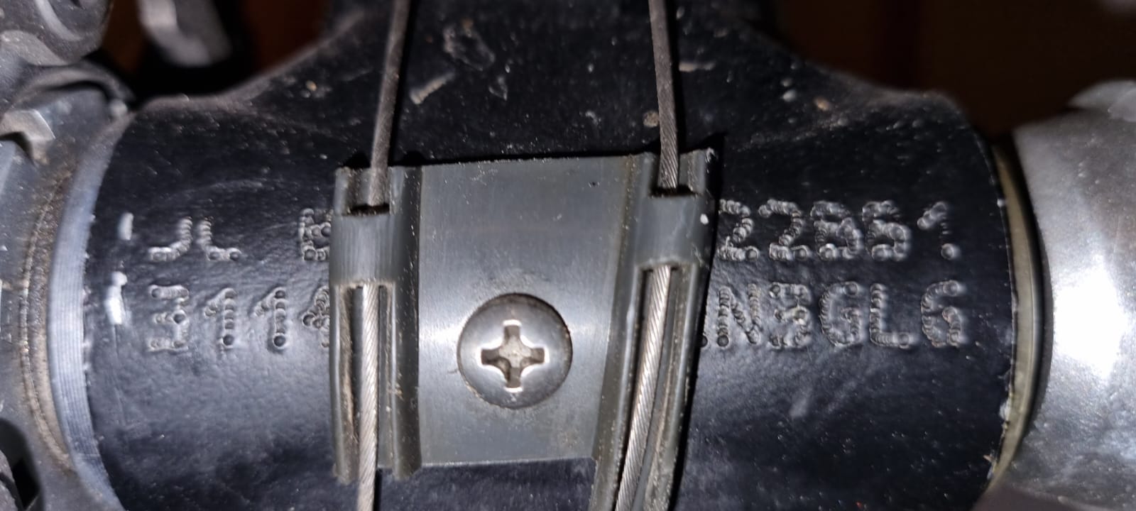

It appears to be a Dember 1998 Frame (J/L)

Probably would be easier to find a pair of Shimano V brake levers. I have plenty of inexpensive new Tektro levers, which work fine.

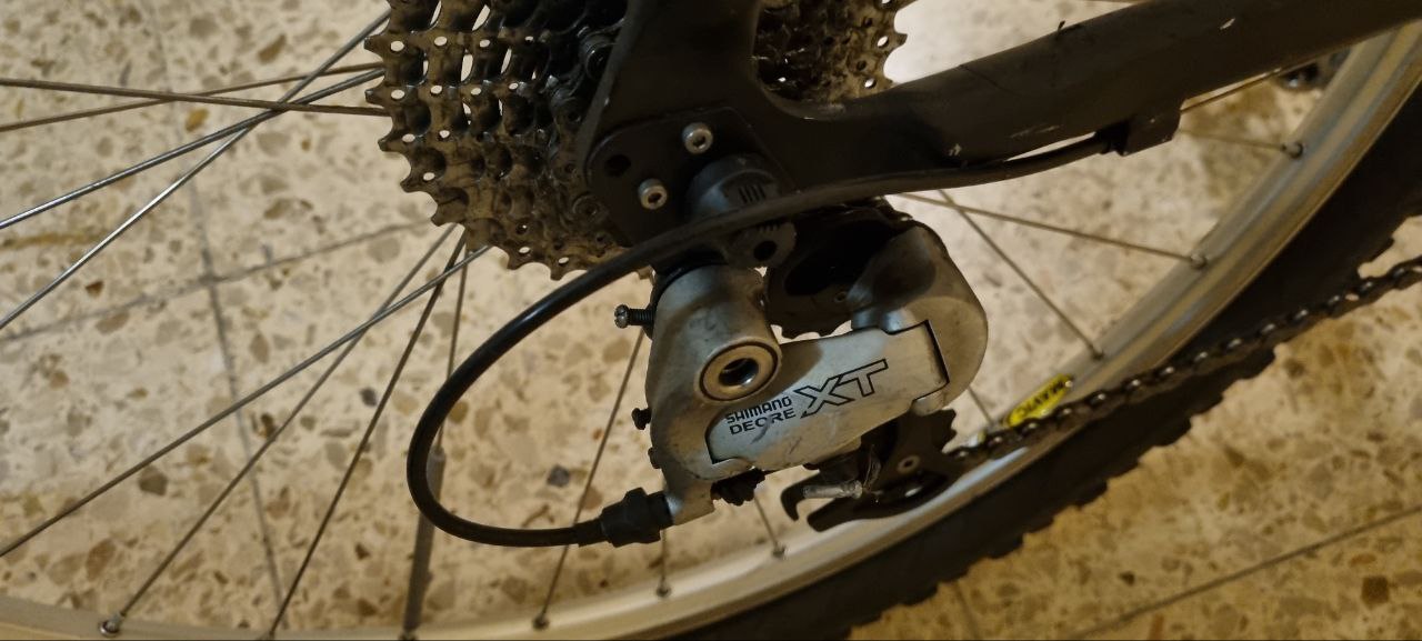

The Back Derailleur reads RD M750 VIA
The Front Derailleur reads RM M738 VIA
Don't know what to make of this setup.
They don't appear to be from the same set.
