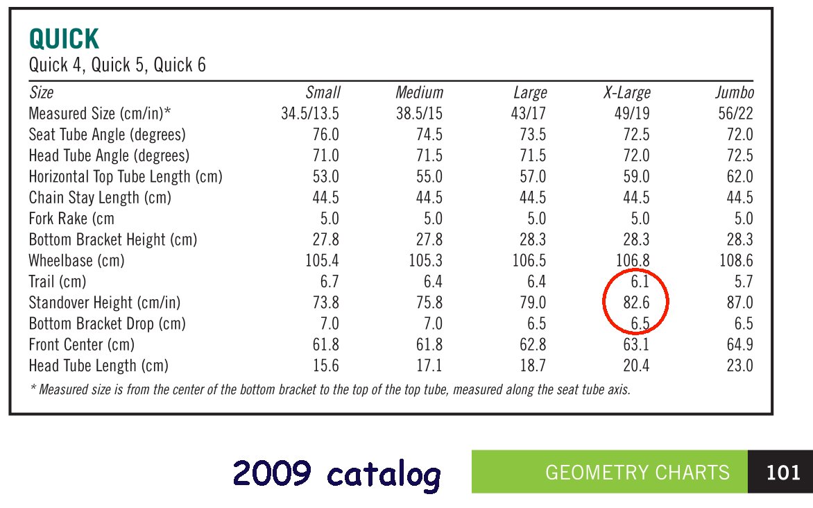

The frame looks like a 2009 Quick 5 but the fork doesn't match the tig welded steel fork shown in the catalog. Fork looks like the 2010 Fatty. V on the bar code sticker translates to 2010 production. So it's perhaps a 2010 Quick that somehow got 2009 decals.
What's the standover height?
rickpaulos
XL frame decal. So here is the 2009 catalog geometry chart. With a sloping top tube I suppose you measure the standover mid-top tube. The bike is in storage for the time being. I'll try to get some closeups of the fork and measure it next time. Broken spoke in the rear wheel and the rim is bent. Crazy gearing. Kenda 700 x 42cm tires.

I think it would make a nice gravel bike, not like I need another. I might be interested though. Top tubes seem really long on these frames. Normally I like the largest MTB/hybrid size but the 62 cm top tube on the Jumbo sounds like a stretch.
