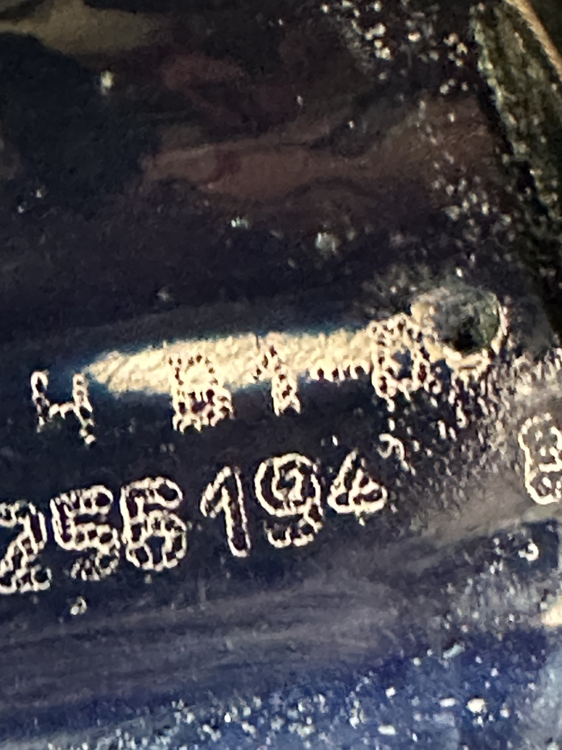

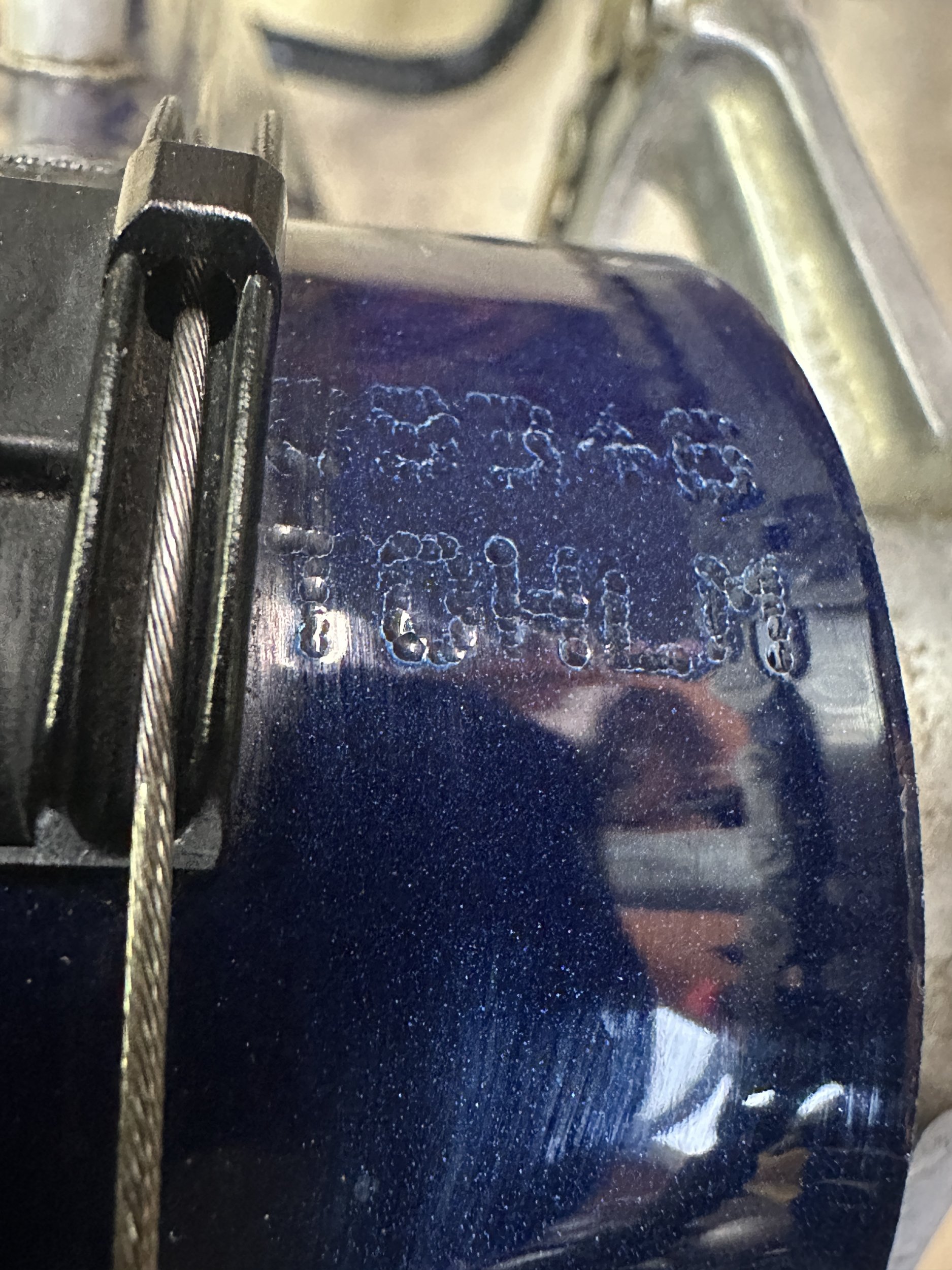

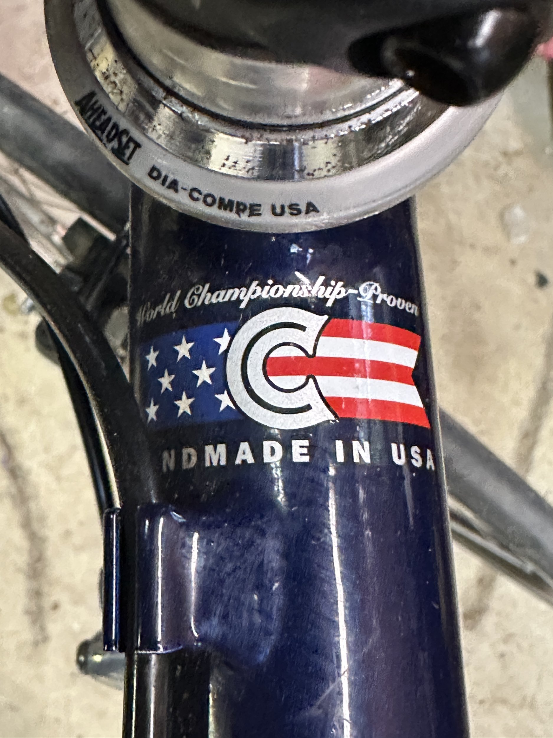

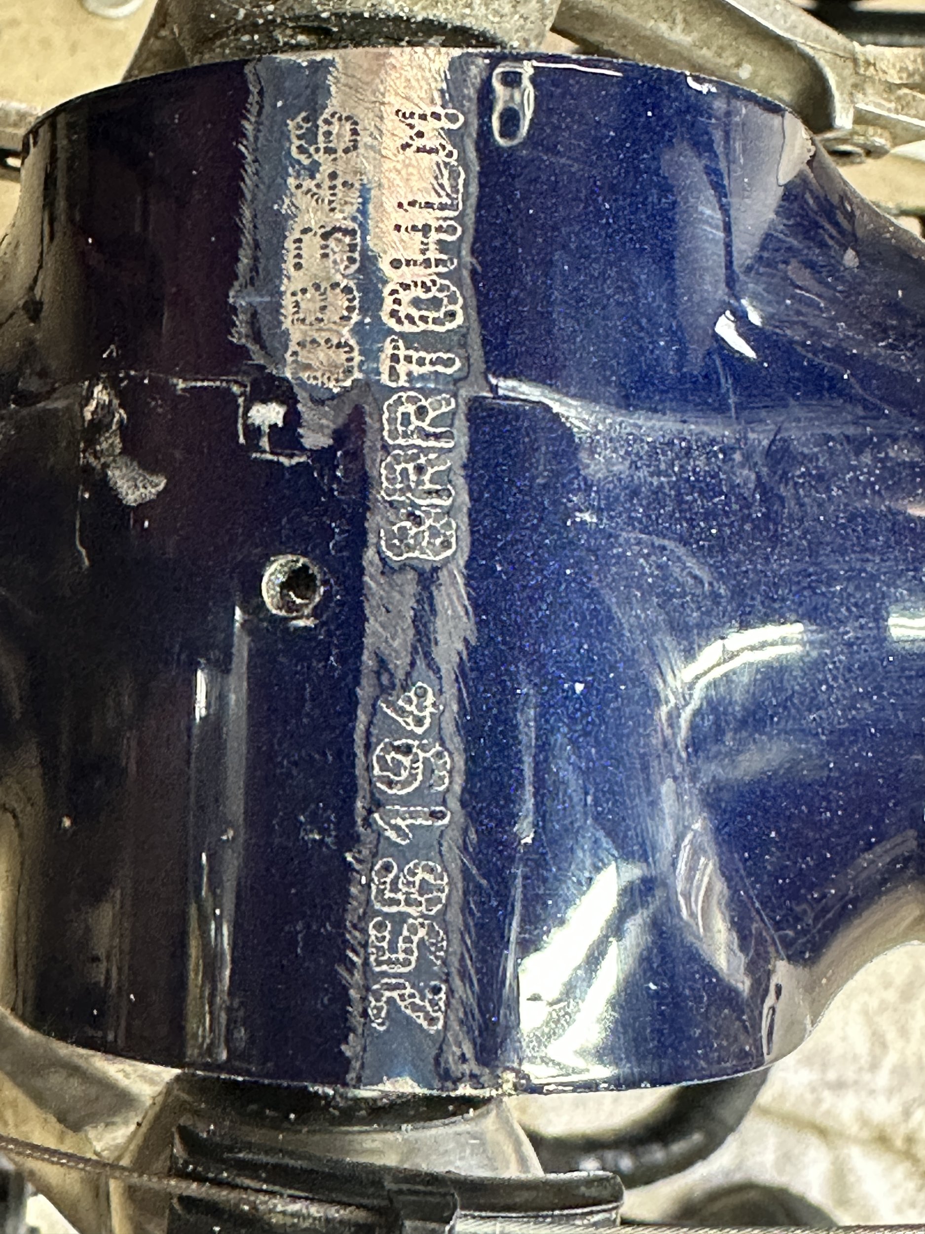

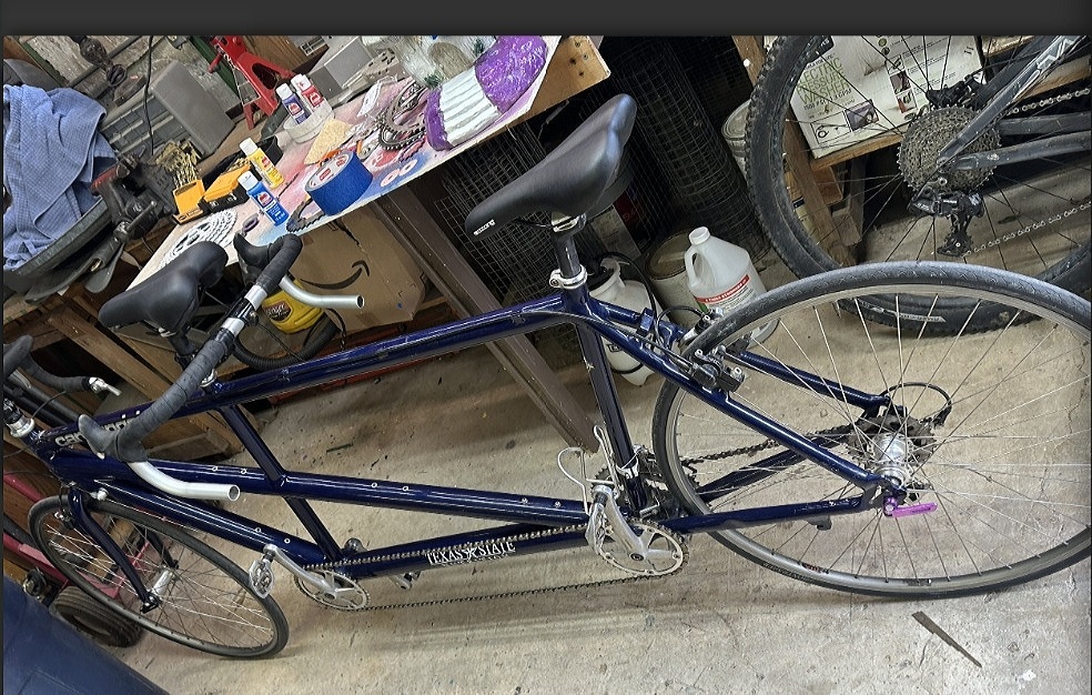

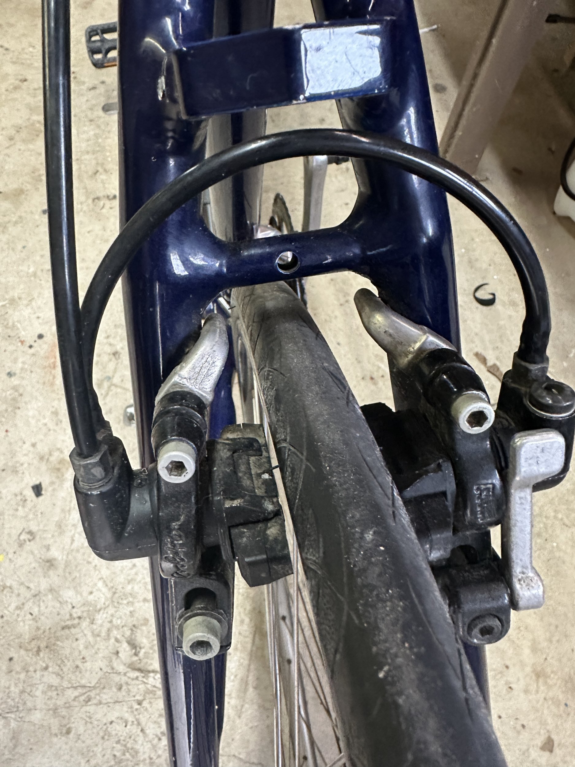

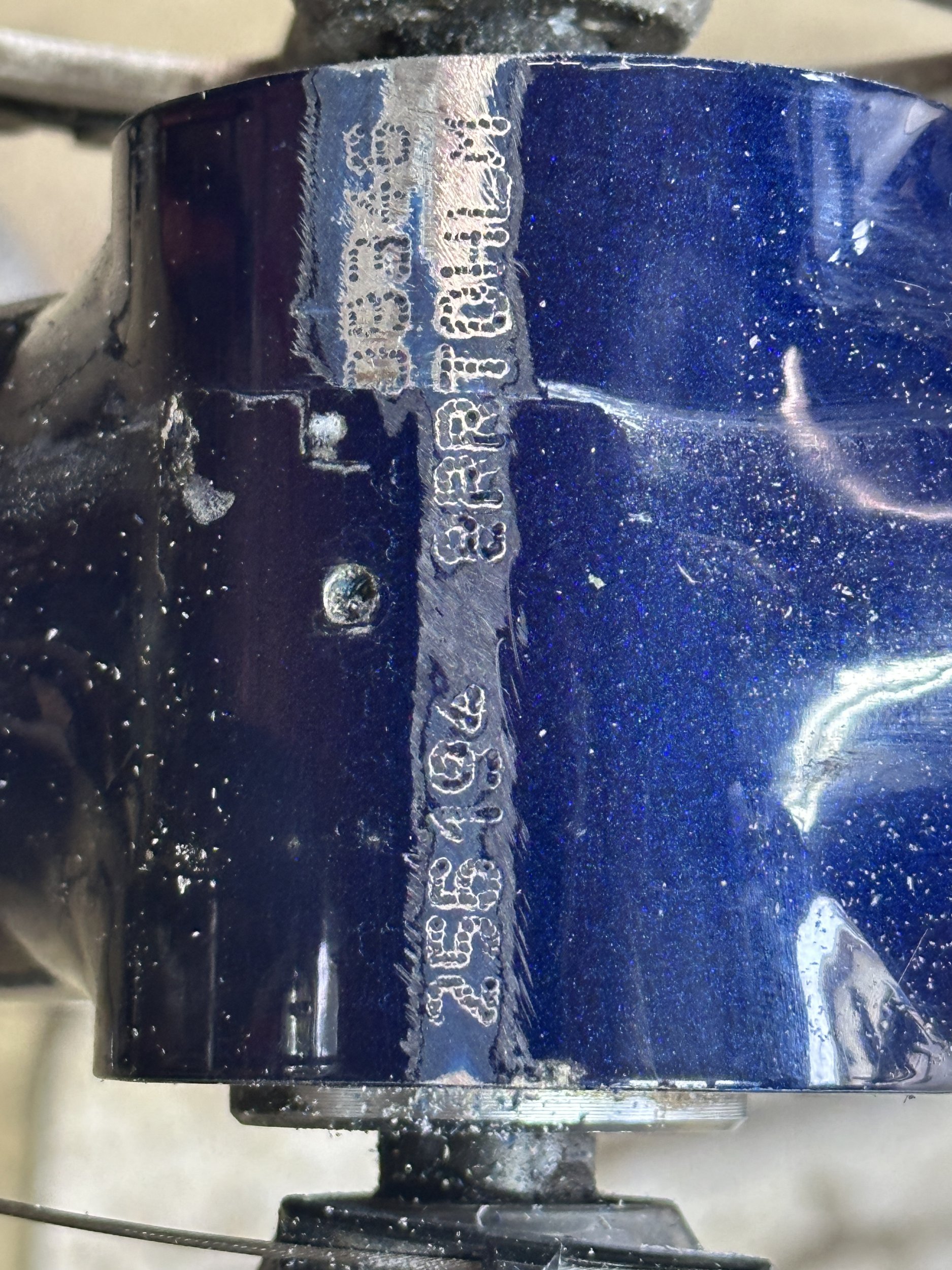

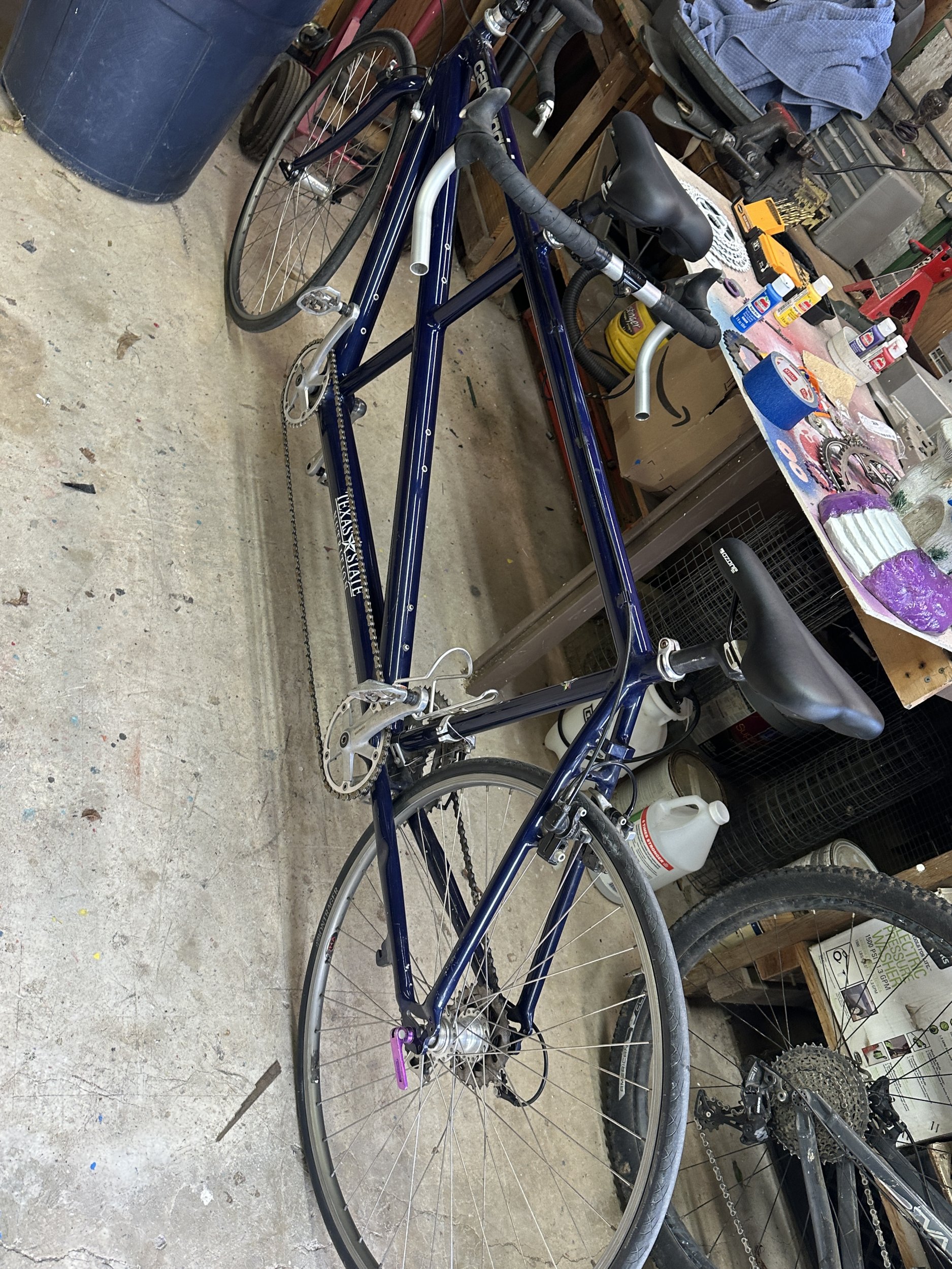

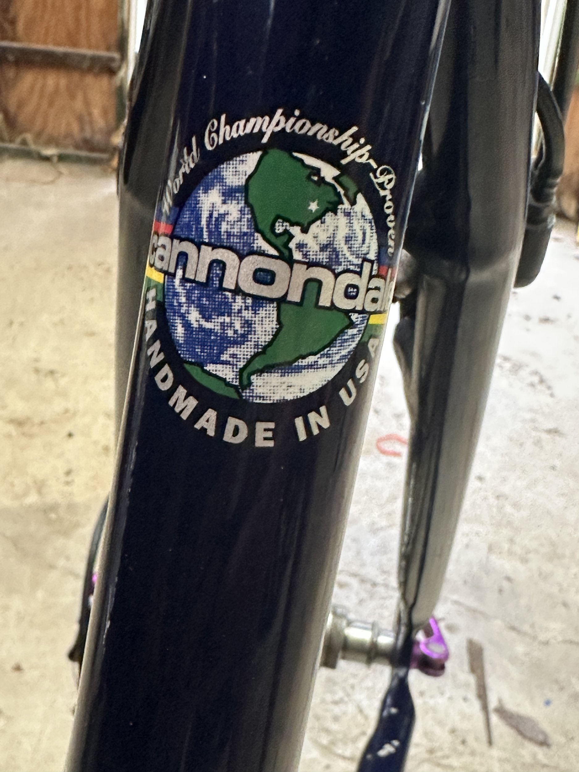

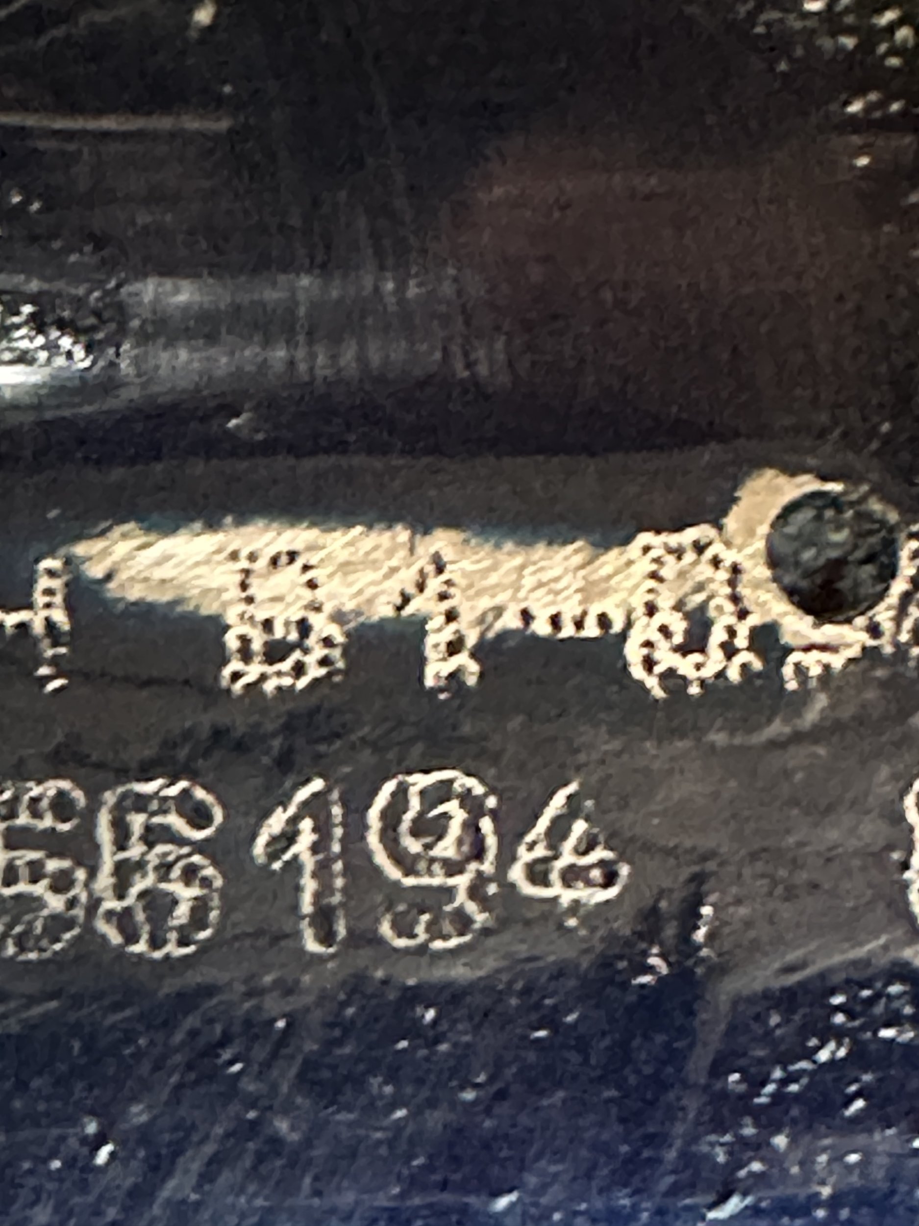

Can you help identify any specific information on this bike from the serial number please. I believe it's a 1997-1999 from the head decal. Thanks!

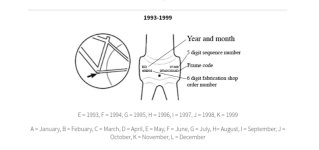

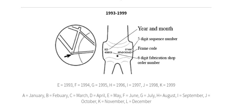

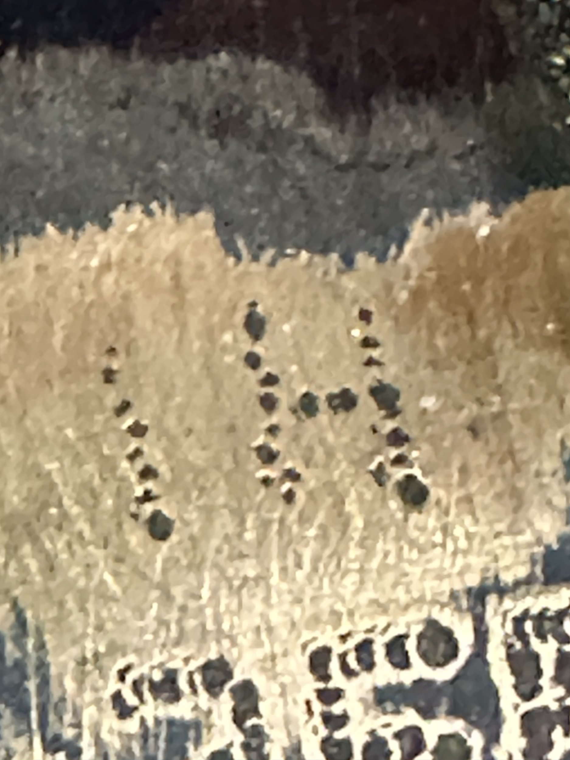

Your pictures are not showing the complete serial number. Remove the Philips head screw that is holding the cable guide in place to reveal the whole bottom bracket shell. The serial number will look like the attached picture.
Please let us know what you find.

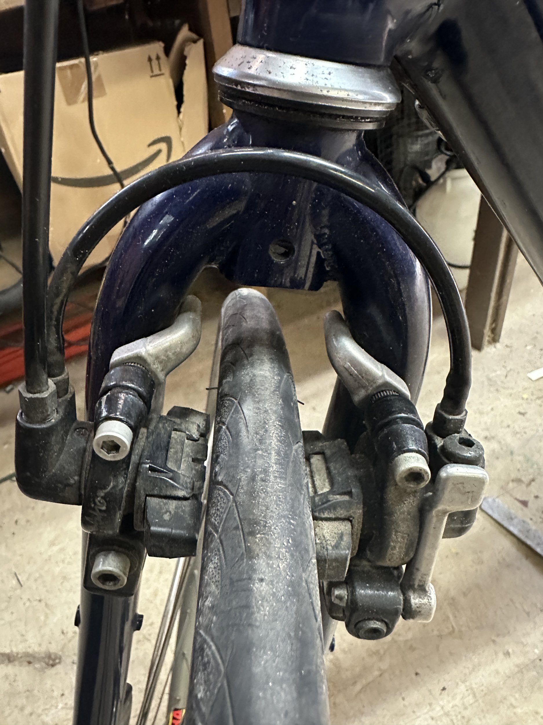

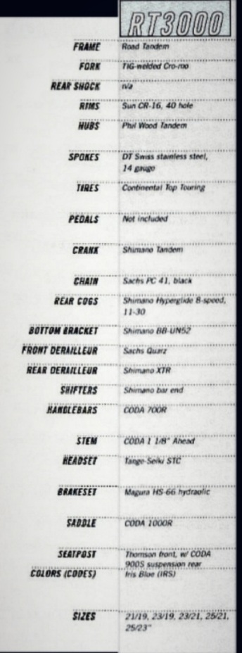

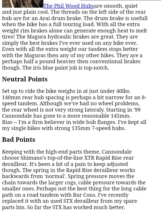

Based on the color (Iris Blue) and those distinctive hydraulic brakes I'd say you have a 1998 RT3000.

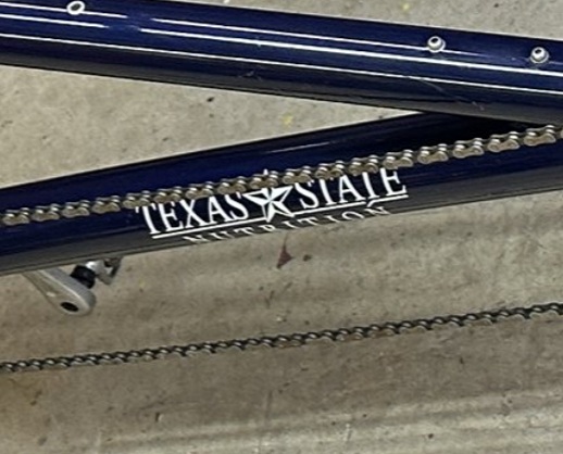

Do you know anything about the Texas State (college I presume) decal on the bike?

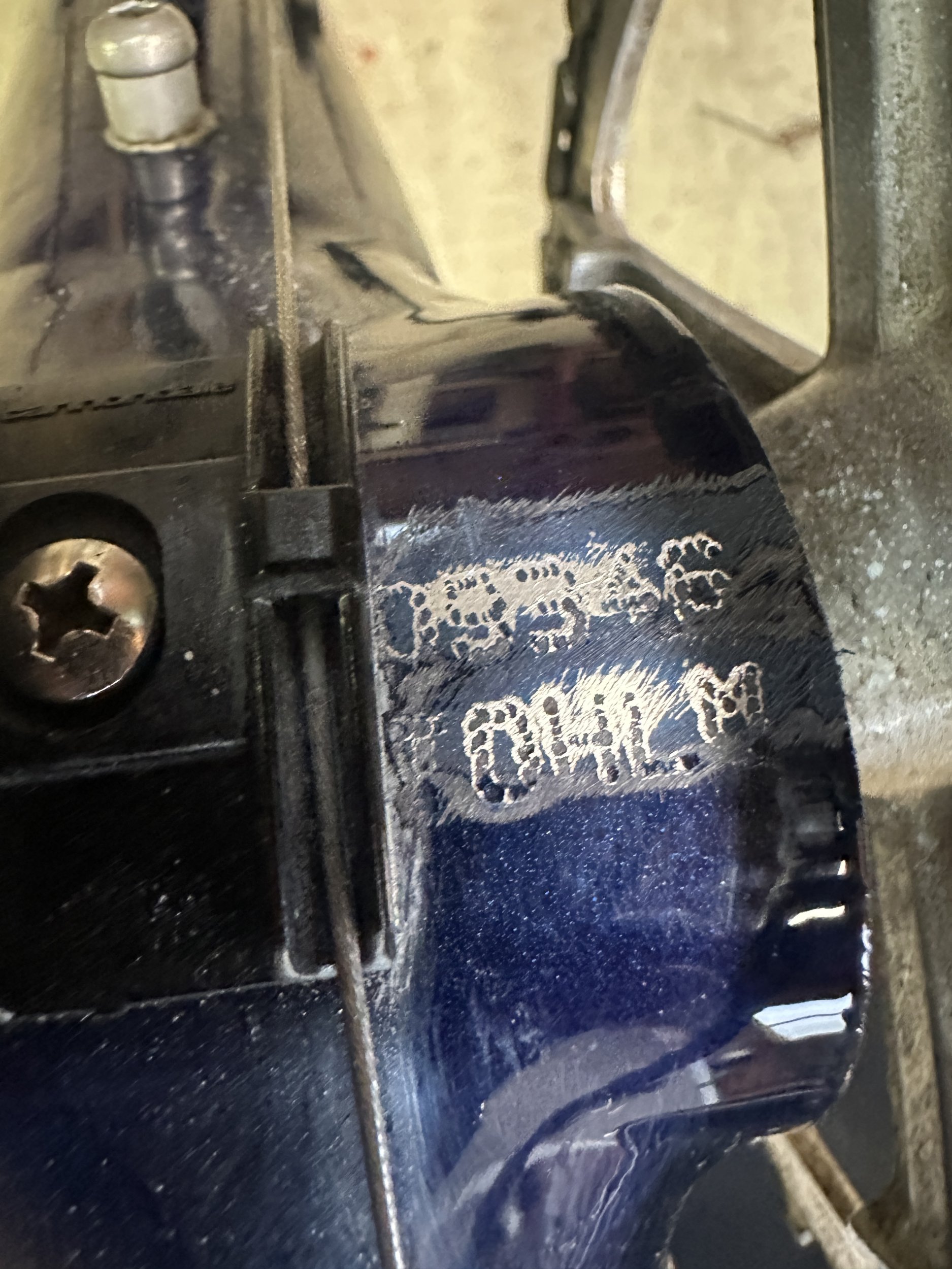

Excellent information. Exactly what I’m looking for. Thanks so much. I’ll pull that screw and post pictures.
estjguardin
Active Member
First! I am IMPRESSED! I searched all over for the information you gave me already. Thank you. Next, can't believe I didn't know to remove the cable guide to find more serial numbers. Kind of embarrassed! I'll download the complete serial numbers following this post, although I'm still not absolutely positive what one of the digits is. Apparently in 1998, they didn't have a machine to stamp the serial numbers legibly, lol. So about the "Texas State University Nutrition" decal. The guy I bought it from said his son raced for Texas State University Racing Team. I contacted TSU and asked for information, specifically, if they had a TANDEM Race Team, but haven't heard back from them. Their current website does show both a current road and mountain bike racing team, but not Tandem. If/when I hear back, I'll update you. If you can decipher the actual serial number from the pictures, please add it, so I can keep it for my records.
estjguardin
Active Member

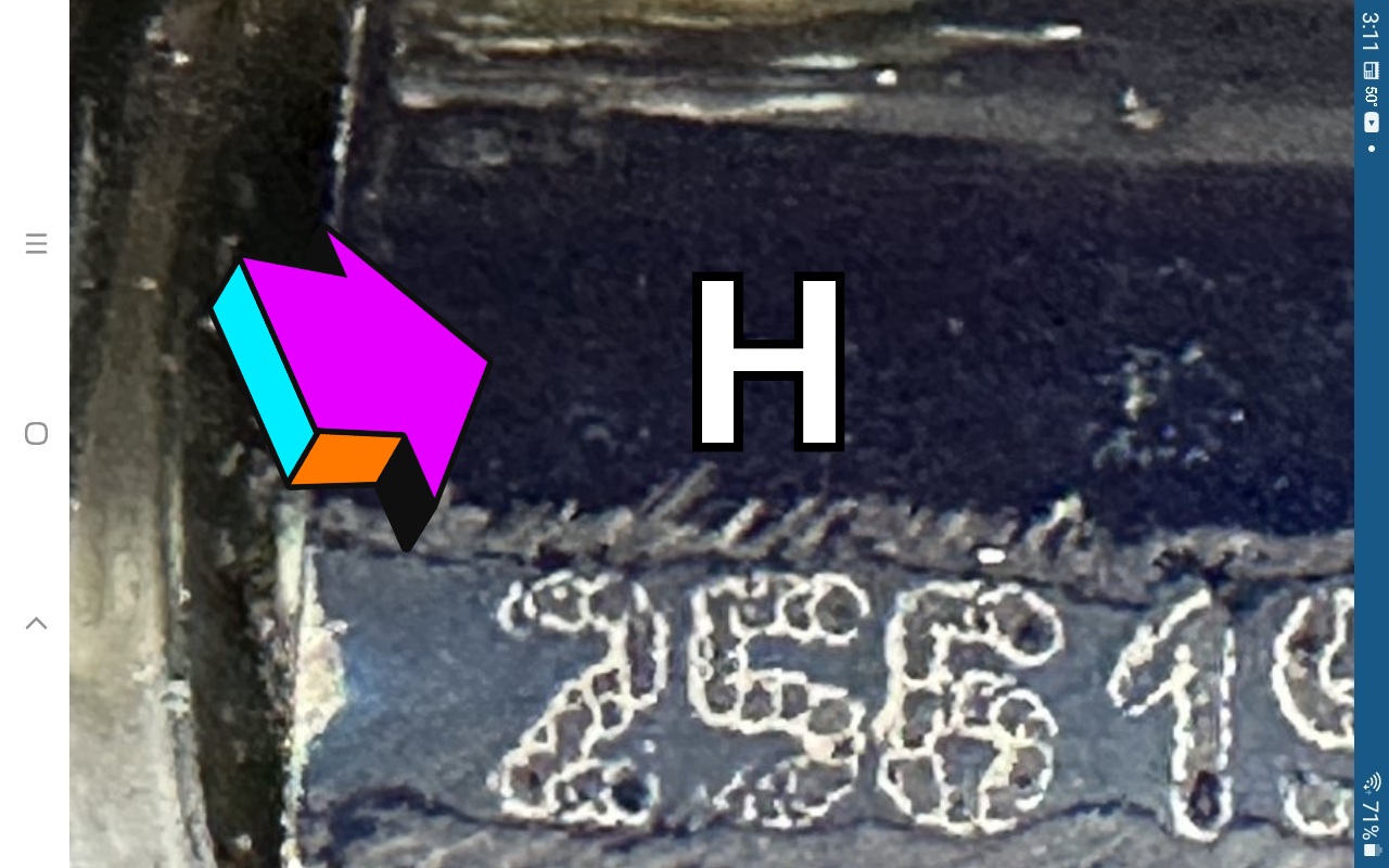

Looks like the numbers/letters on the left side top are... "H B1 0". (H (space) B1 (space) 0)

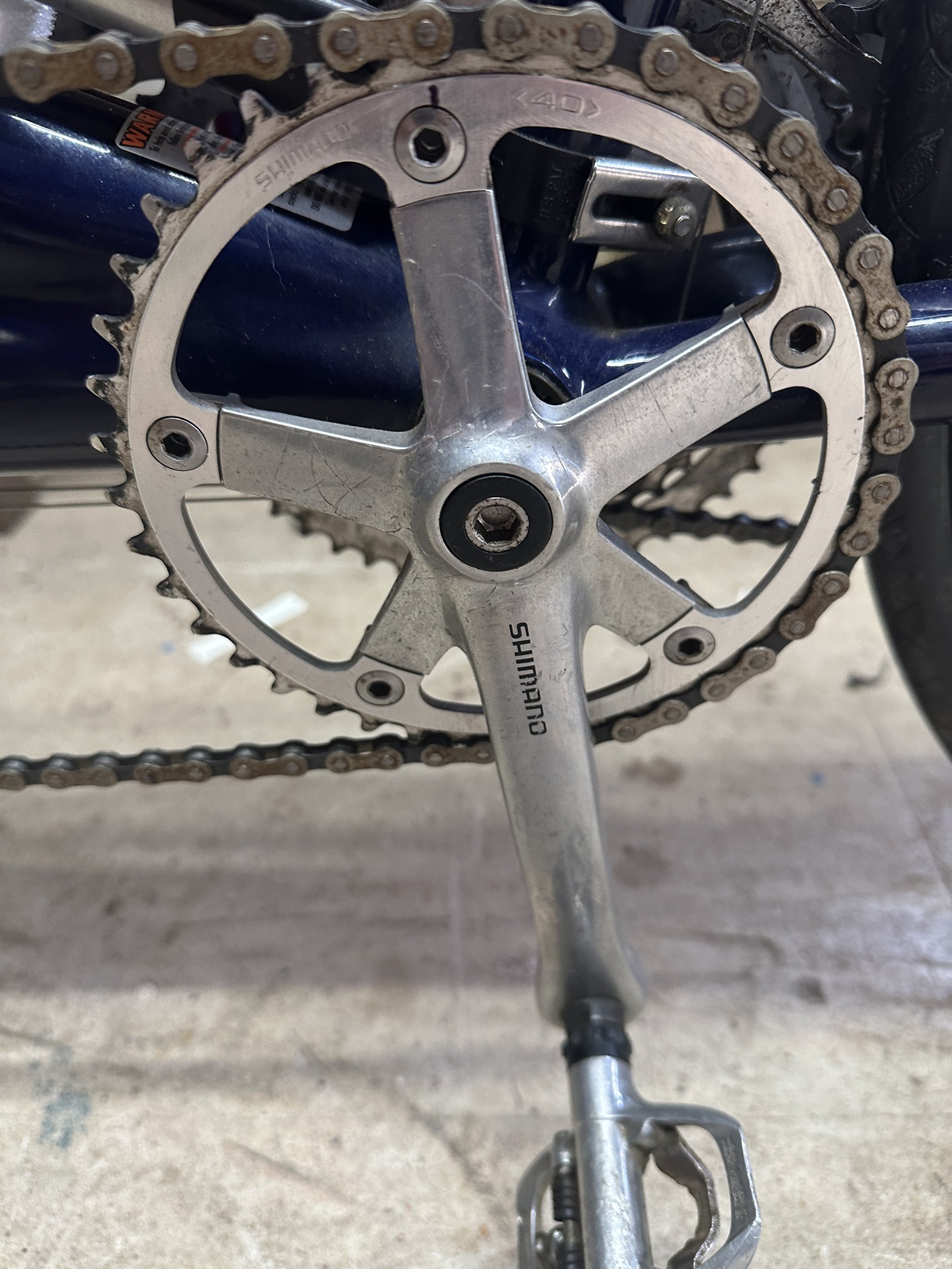

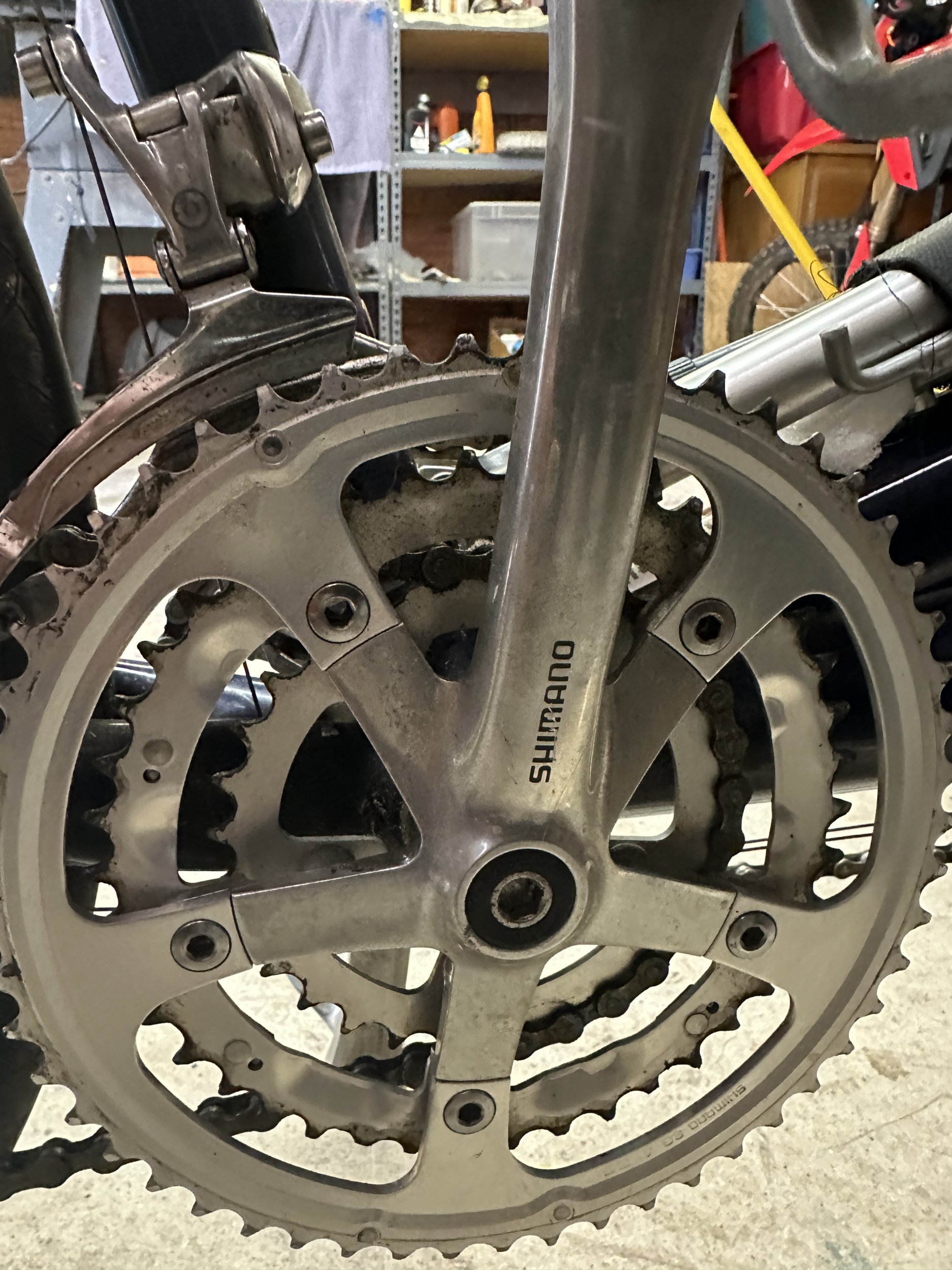

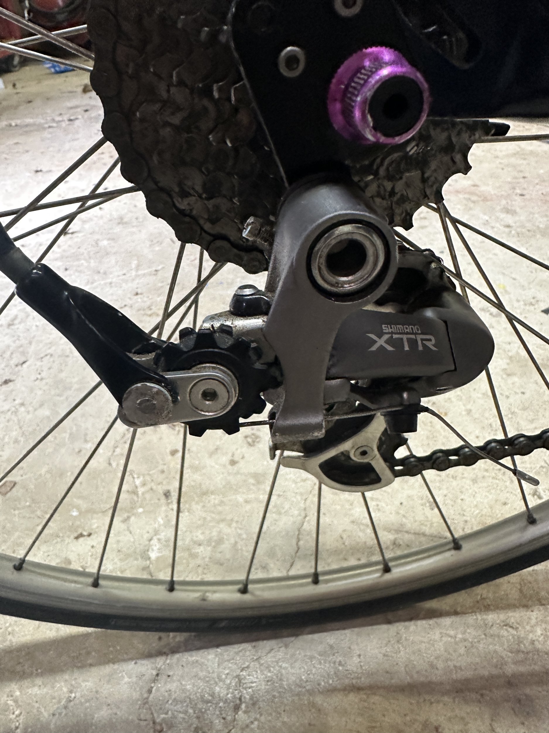

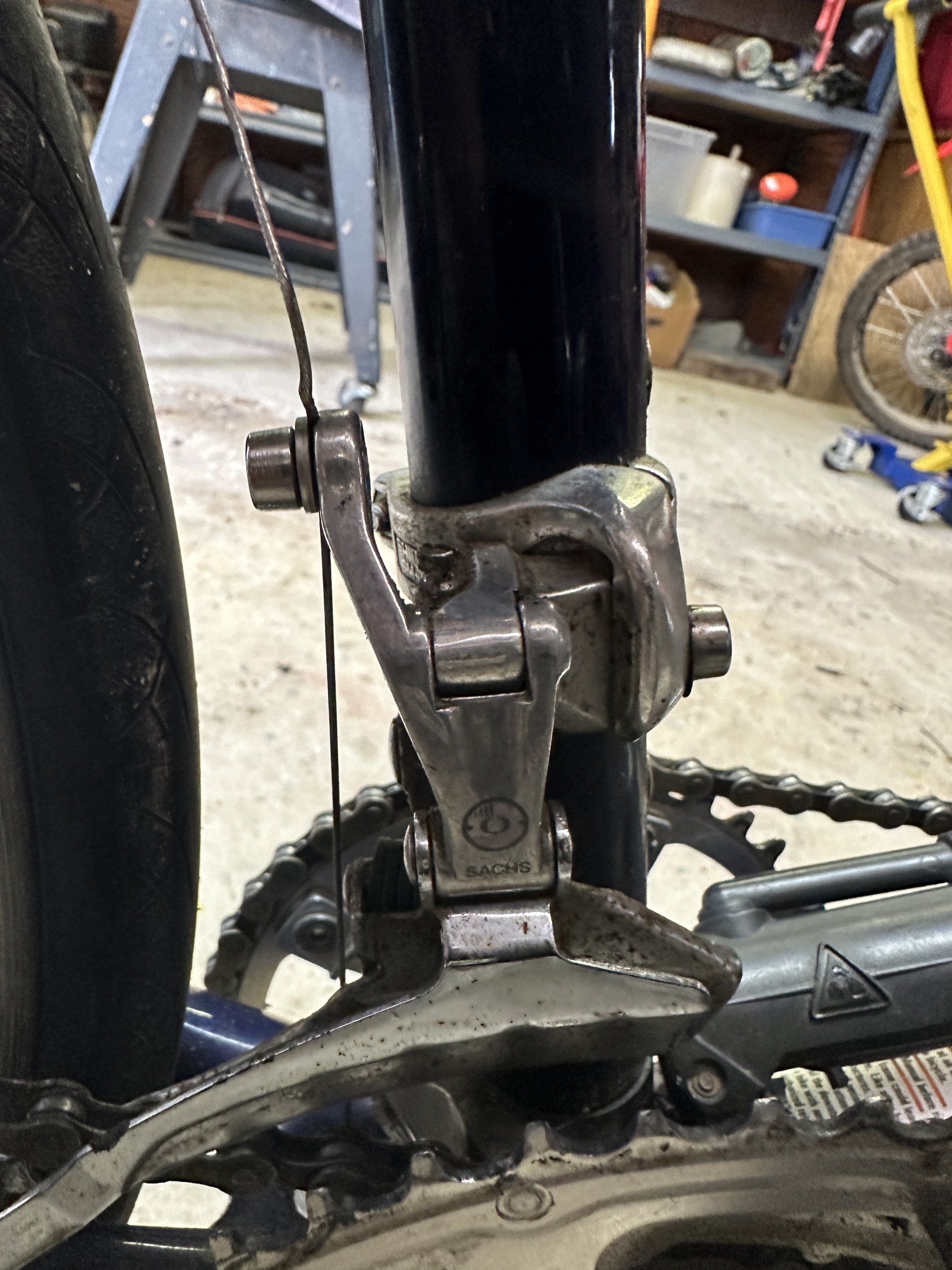

Ha, ha. Sometimes the easy ones aren't so easy. Could you provide a picture of the bike's drivetrain? I am still thinking that it is a 1998 build. Go to the home page, look up the 1998 catalog and go to the end for bike specifications. If your components mostly match what the catalog says, it's a 1998. Meanwhile look to the left of the "H" for another letter. I'm thinking that there is one yet unseen.

Ha, ha. Sometimes the easy ones aren't so easy. Could you provide a picture of the bike's drivetrain? I am still thinking that it is a 1998 build. I once bought a three year old NOS tandem from Trek that the factory just couldn't sell without discounting it 50%.
lol. I missed ANOTHER ONE! lol. Posting drivetrain pictures now. Sheesh. Looks like they used a hammer and chisel to stamp these numbers. We’ve come a long way some then. It’s an ”I” or a “1”, prolly an “I”, my guess.

Looks like I have a 1997 built in August. Not sure the other numbers really mean much. FYI, I paid $650 for it. Its in GREAT shape and everything works perfectly. Thanks so much for your guidance. If you know/find more please send it my direction. I’ve really enjoyed the journey so far. I’ve ridden my old Santana Sovereign from the San Francisco Golden Gate Bridge to Victorville 3 times. Once with my daughter, once with my ex, and once by myself. (the first time with my with, she wasn't ready and blew out her knee, so I sent the back seat assemby, her pedals AND HER home on a plane! That was the fastest trip. lol.
Yes, a August 1997 frame built for a 1998 model.

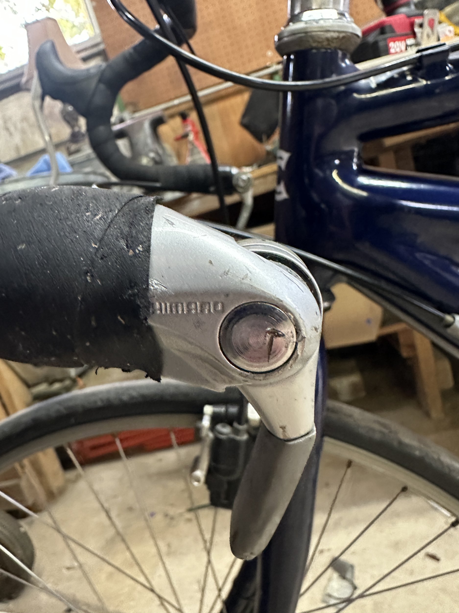

That is really a funky rear derailleur. Innovation, good and bad, really abounds in the bike industry.

Thanks for all the information! Another question, back then, did they still measure frame sizes from the center of the crank bolt to the top of the top tube, just in front of where the top tube meets to seat tube? I get a 22/20" measurement. Or is it to the very TOP of the seat tube? Inquiring minds want to know!
Since the catalog lists a 23/21 size, I'd say that's your answer.
