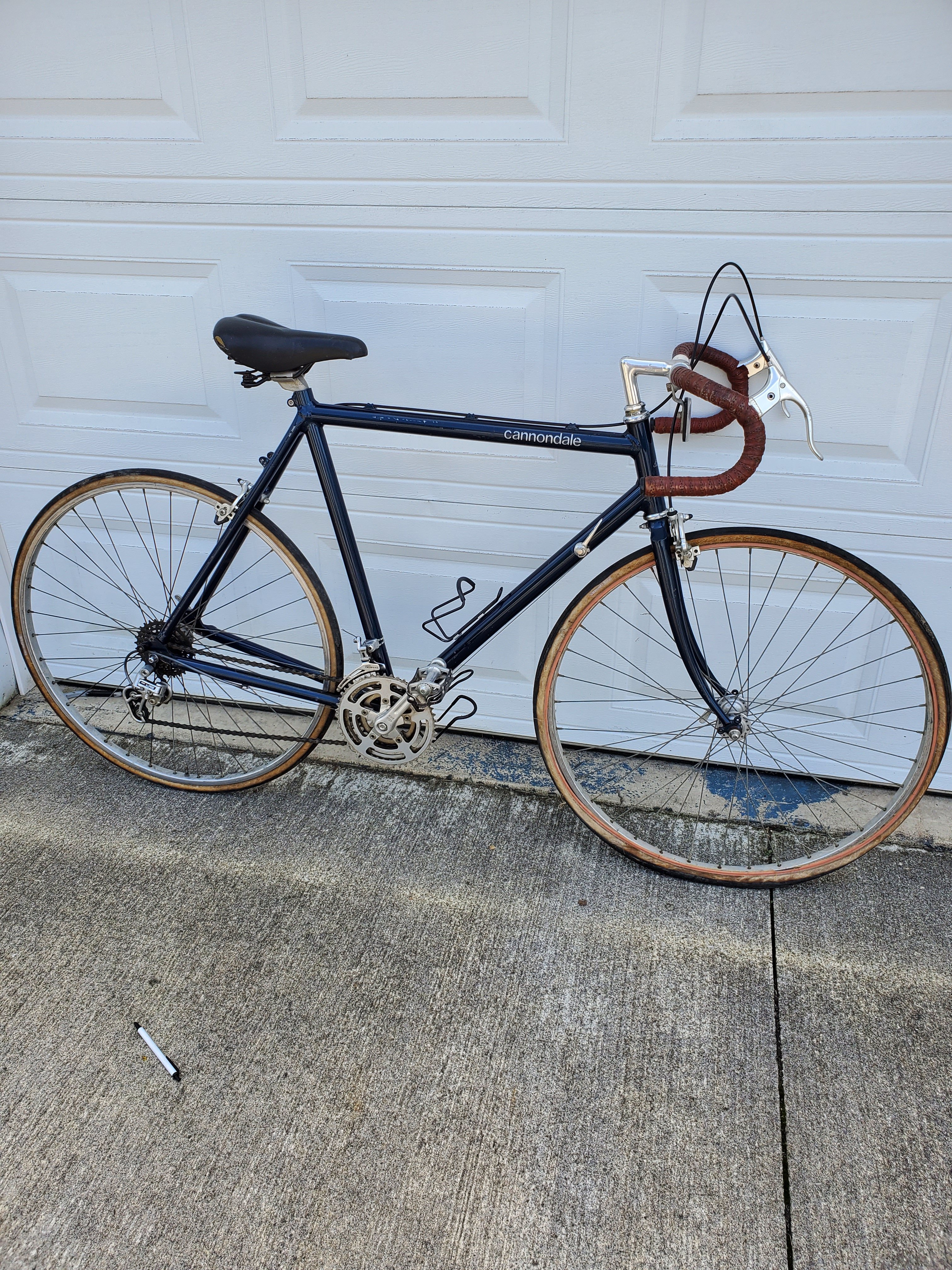

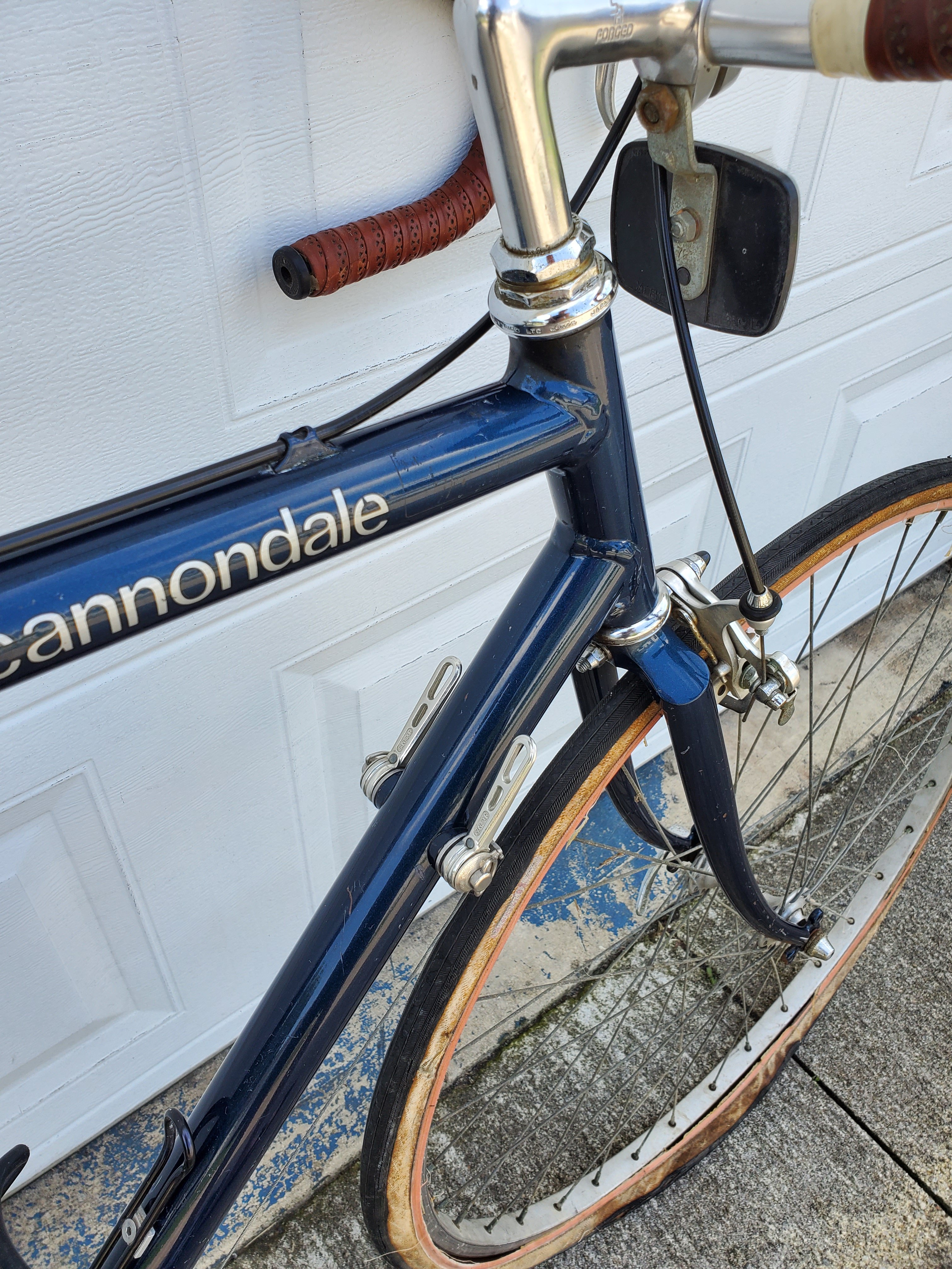

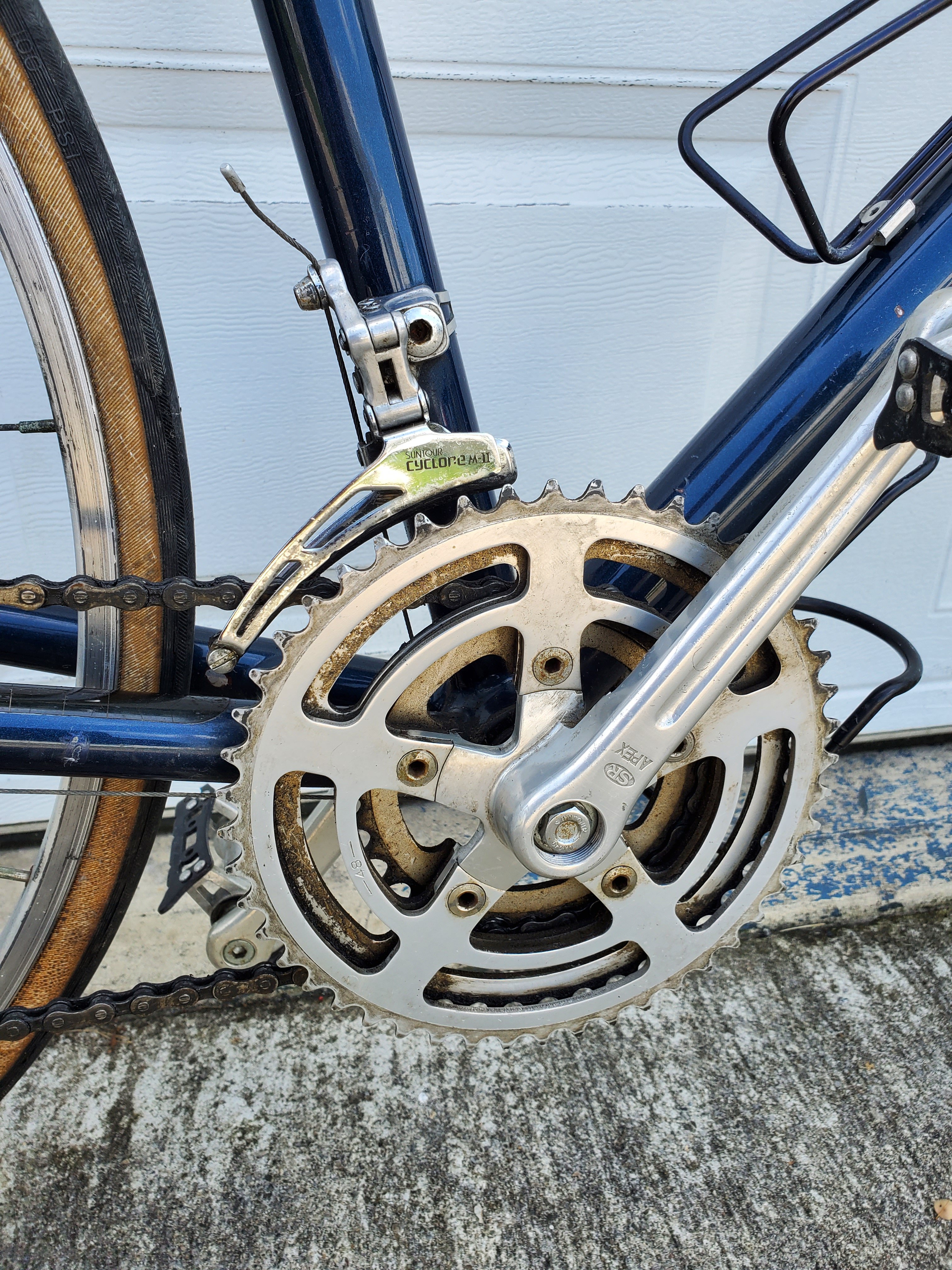

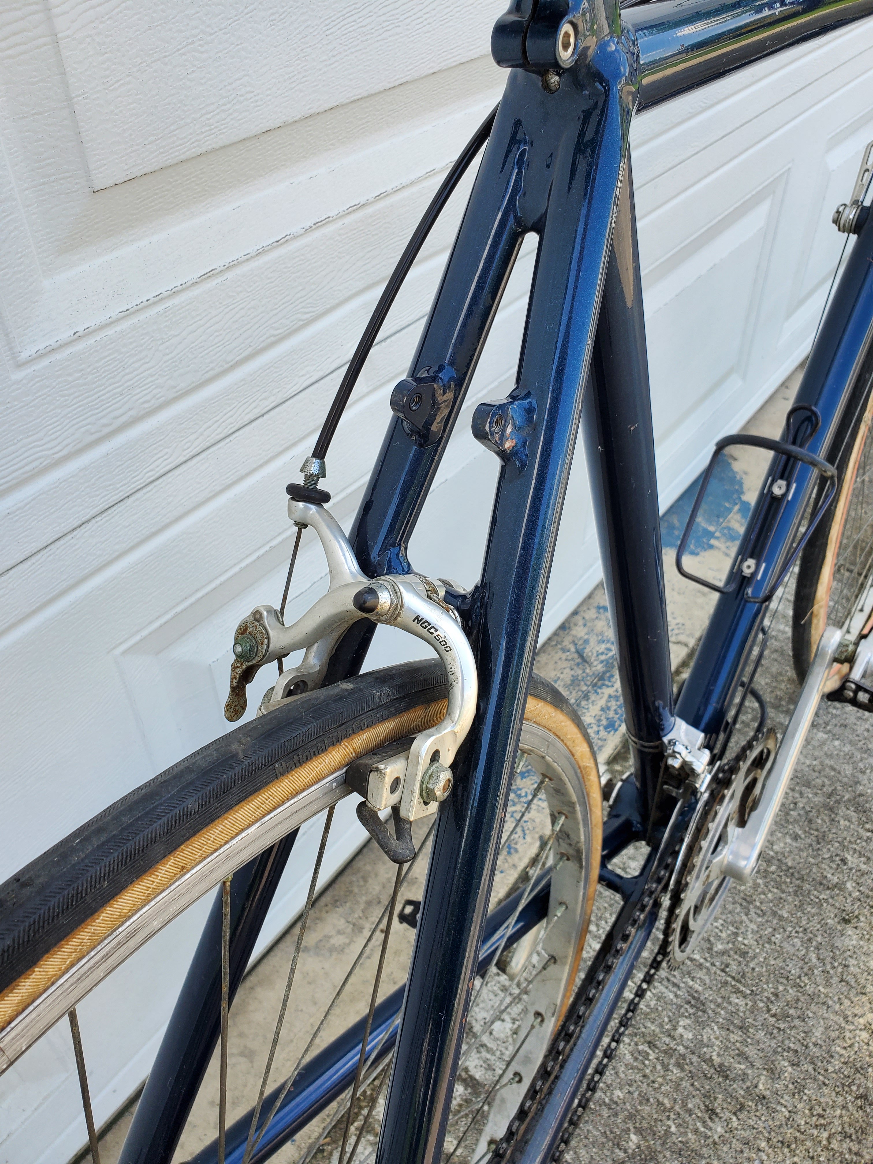

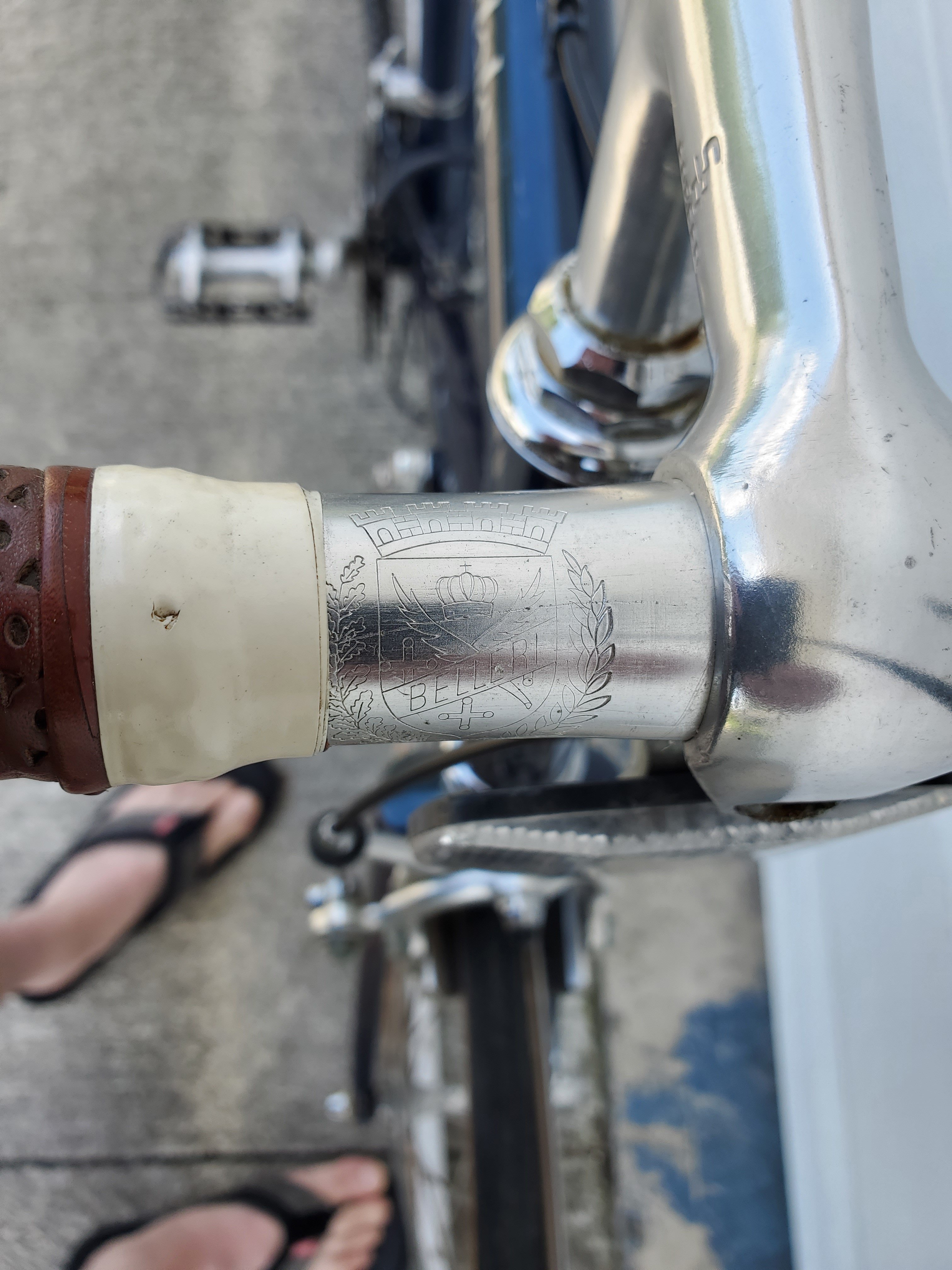

Thanks for the reply! Here are some pics. Seems to me only the seat is not original?
Brake calipers, crank, front derailleur, bar, stem, look right for an ST500. Rims/hubs: I can't tell but they look original. Rear derailleur is not the Superbe Tech that the catalog specifies.

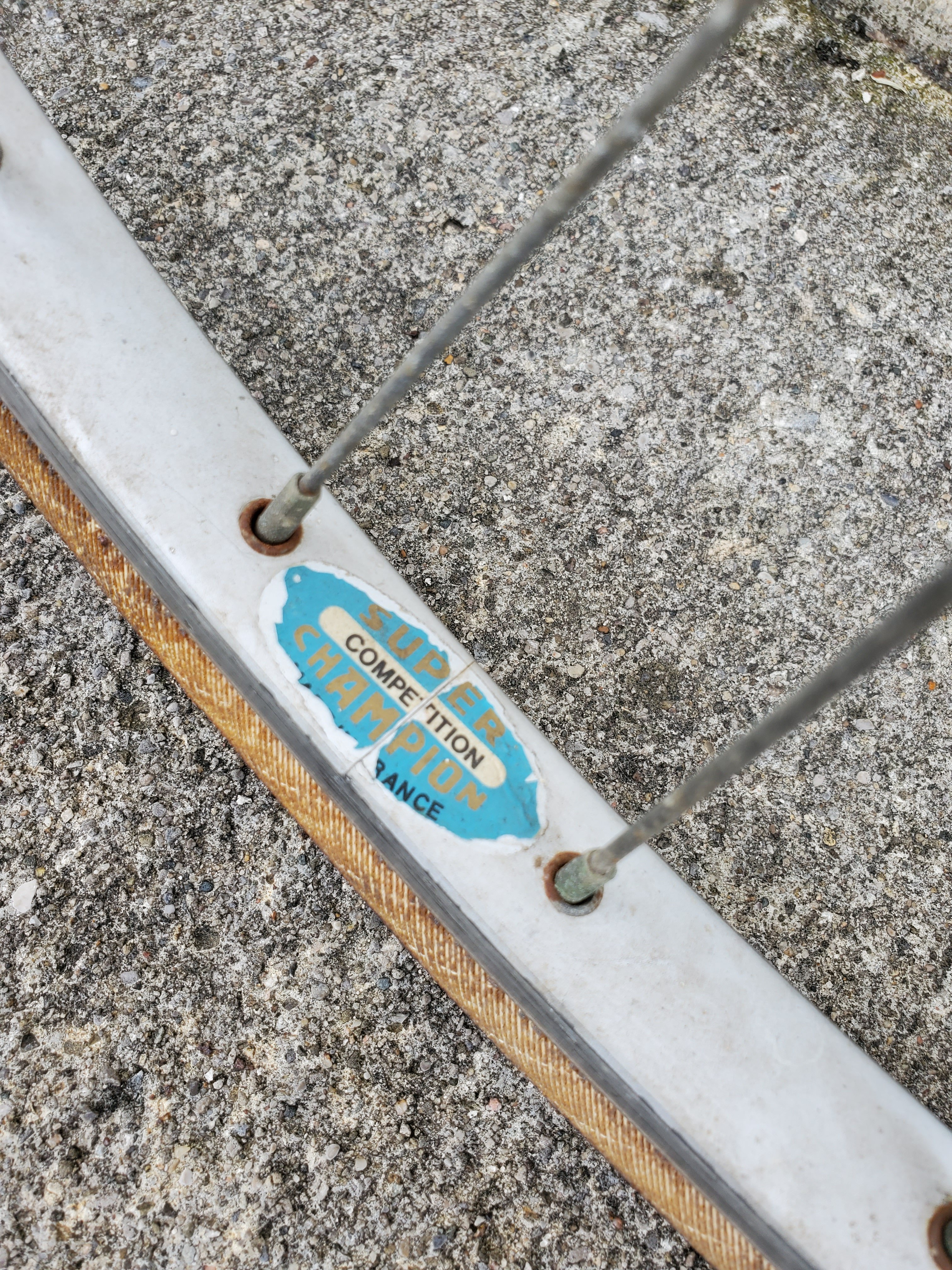

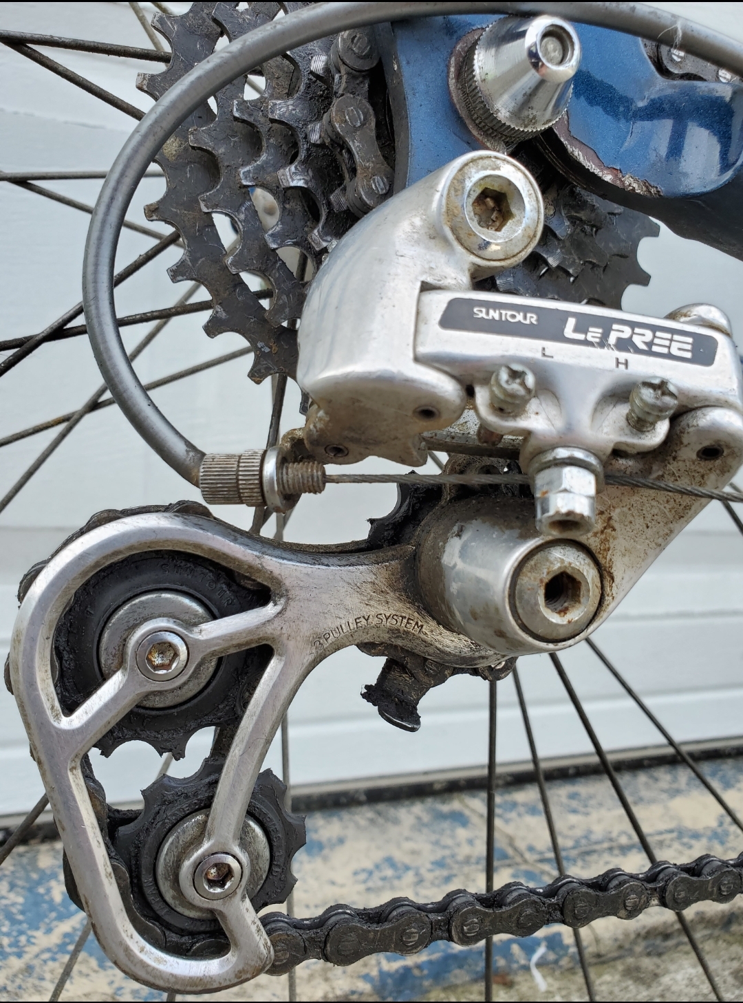

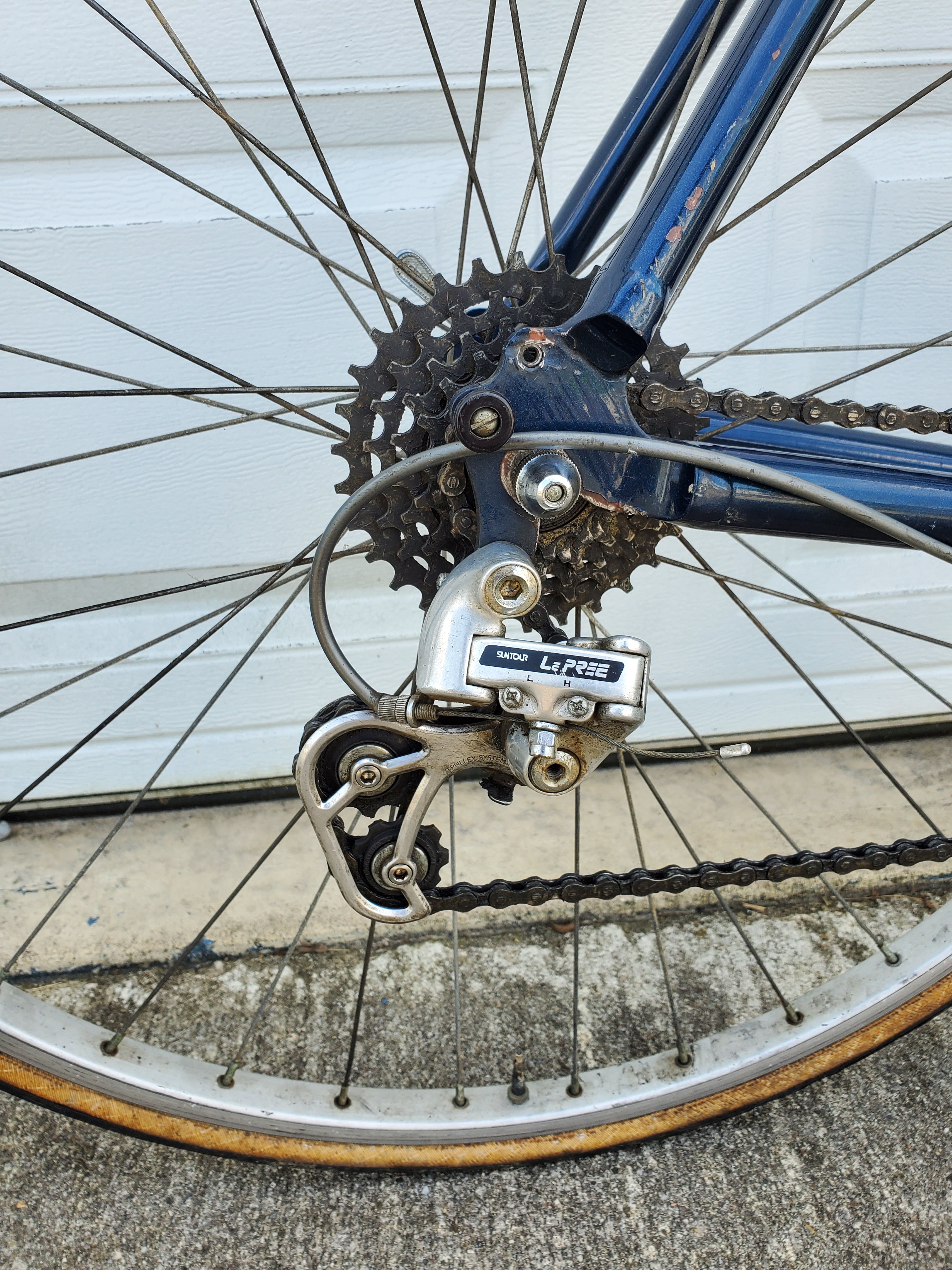

You're right, I see that now. My rear derailleur says Le Pree. Here is a pic of the sticker on wheel. They have the Super Champ sticker. So my rear derailleur appears to be the only thing not stock... and seat.

The LePree is also unusual as it has three jockey wheels instead of the usual two. It looks like a nicely made and finished part but I'm not sure where it fits in SunTour line.
