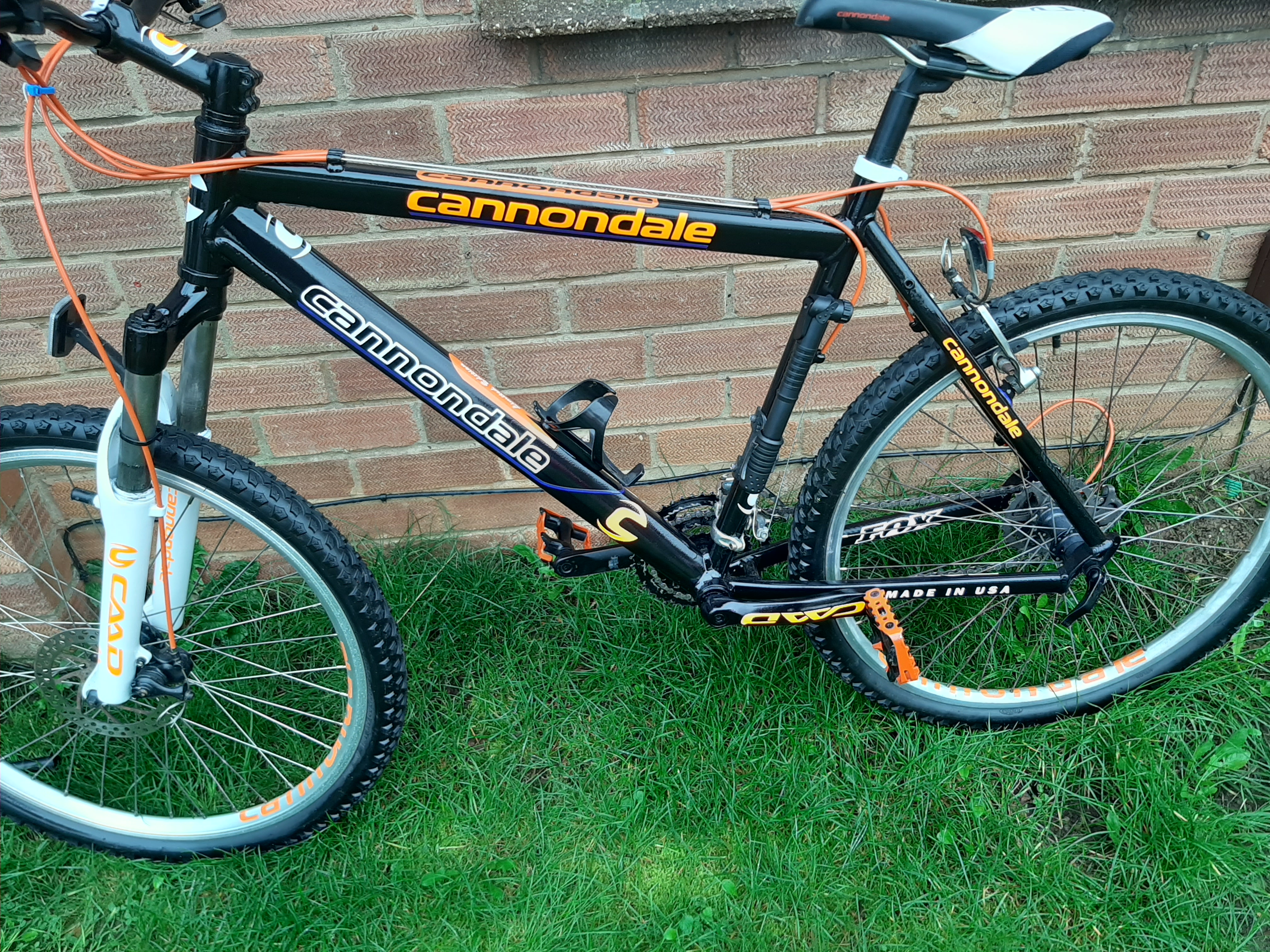

Hi, could anyone help pls identify?
Nick Beale
Hi
Picked this up and wondered if anybody could identify or authentic?
It's been painted by the looks of things so I cant find serial numbers etc?
Brought from Market Place lastnight.
Many thanks in advance.

Nick Beale
Hi
it's been painted over, I'm starting to doubt it's a cannondale frame tbh, I have the option of refund, so might take that and keep a look here.
Nick Beale

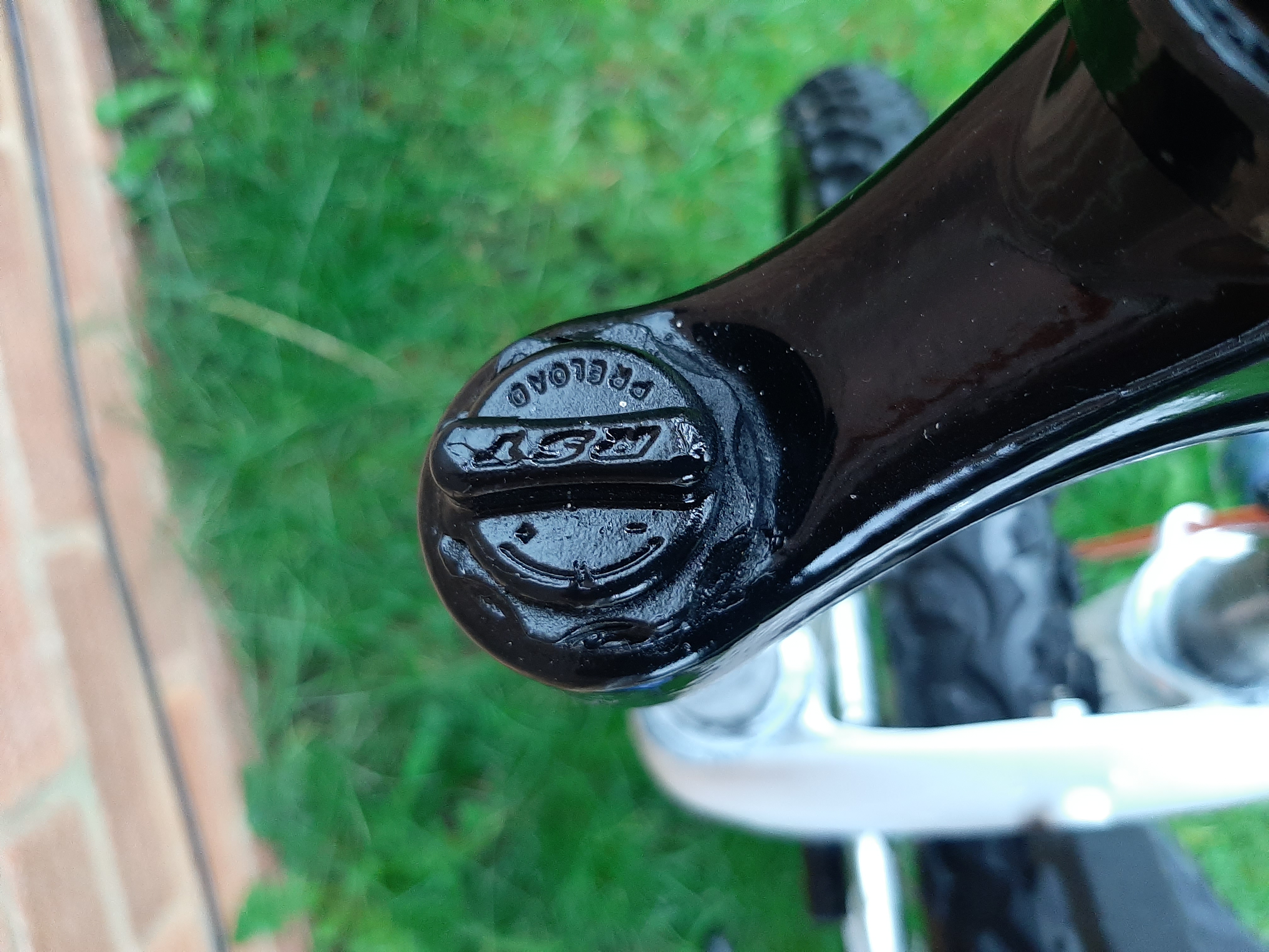

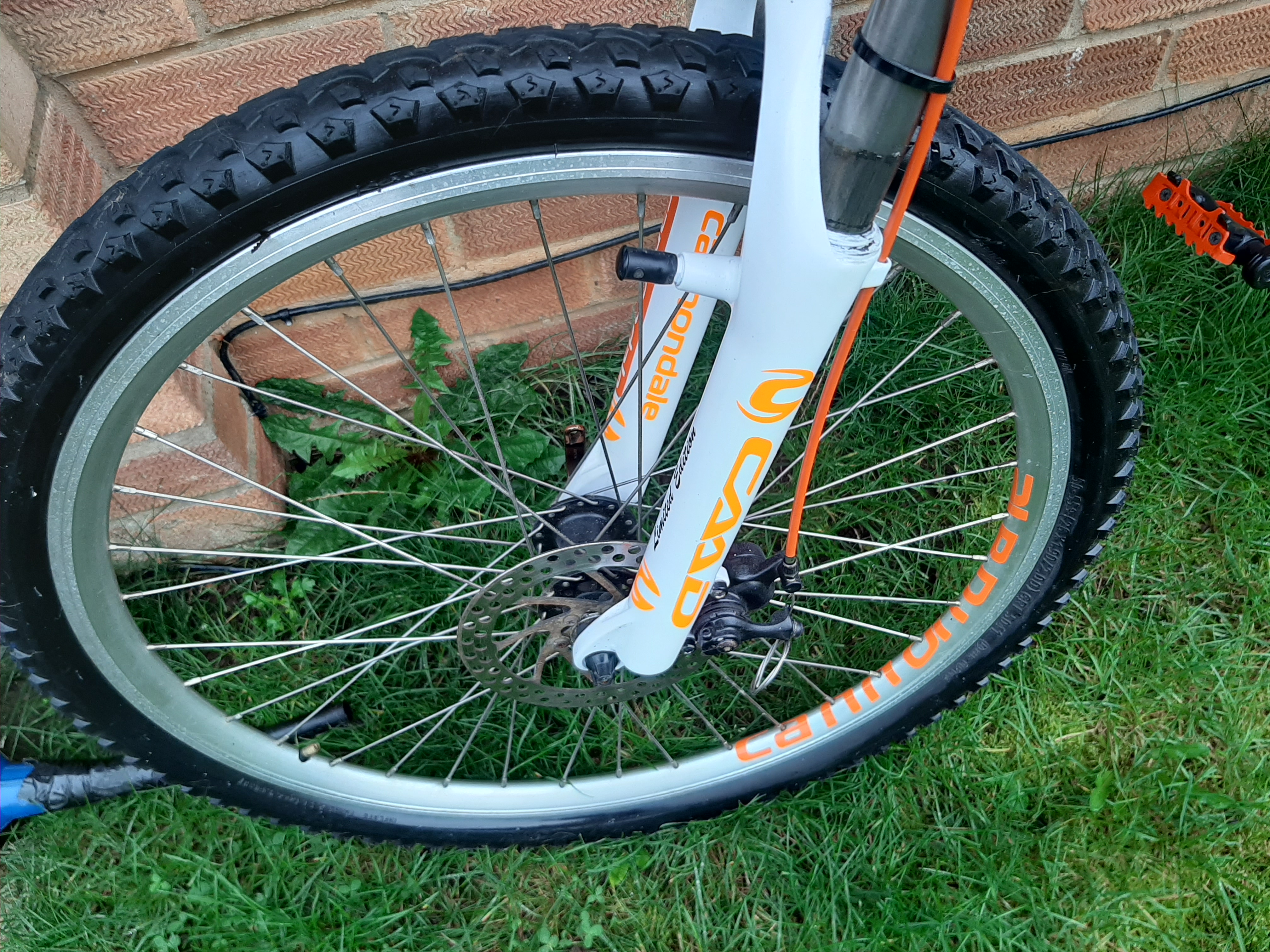

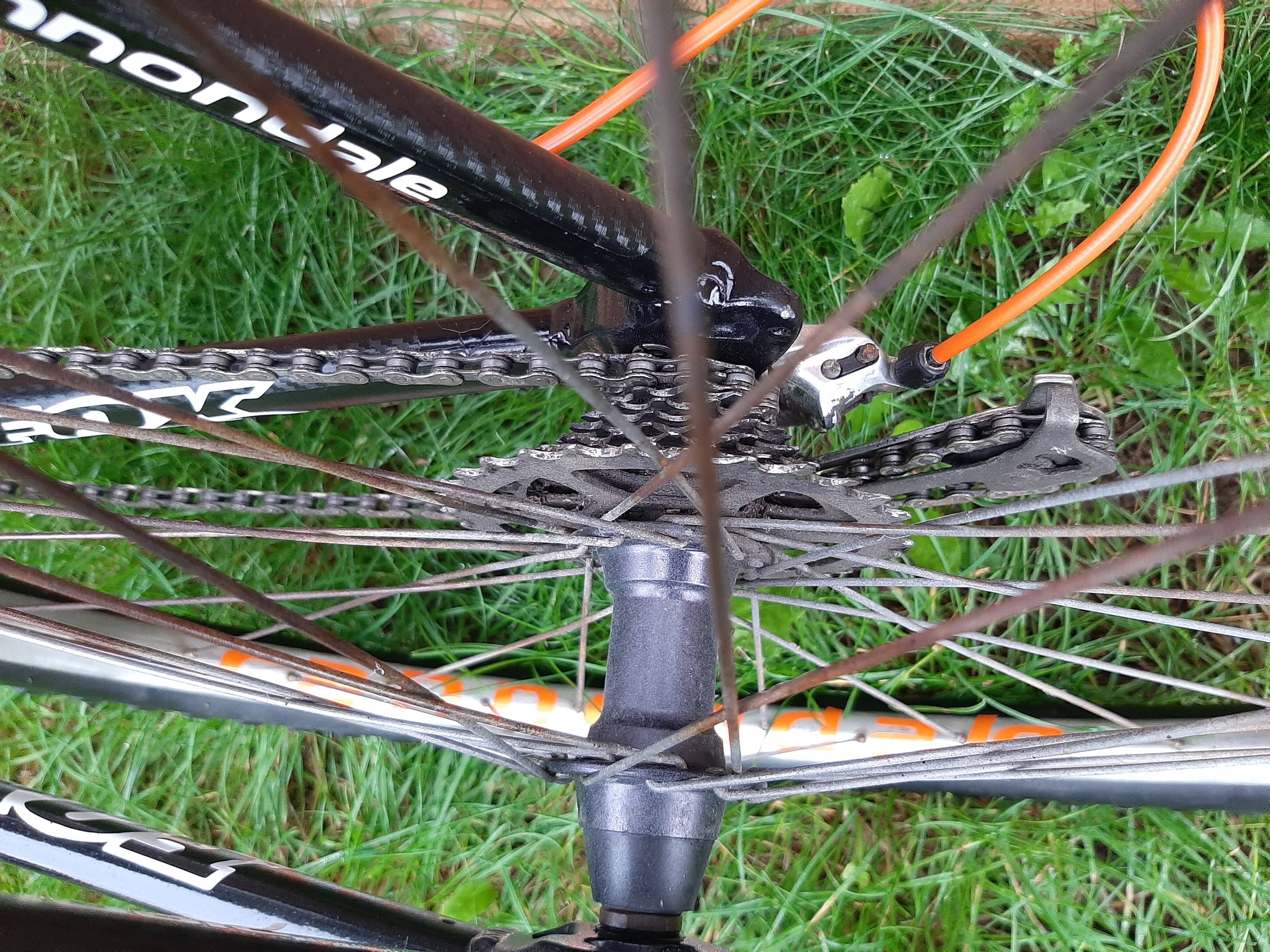

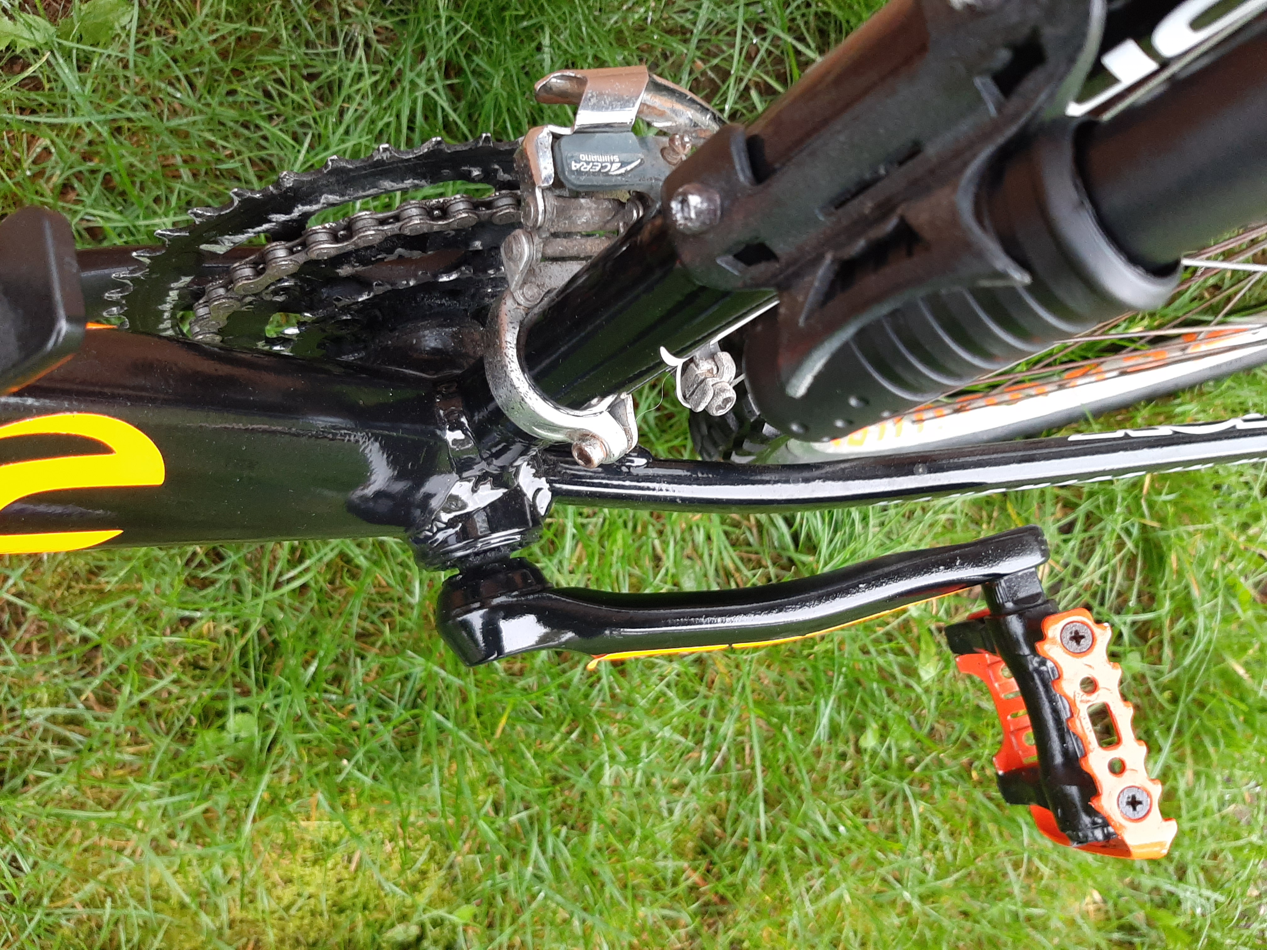

Oh dear, me thinks No. A really bad fake.
Thank you, while that's bad to hear it's also good in other respects as I'm able to return it, its obviously been painted recently and the stickers added, I was just unsure if the frame its self could be cannondale, but it's not looking so, a friend of mine is into MTB and he said it might be but hes never seen a Cannondale like it.
Many thanks
Nick Beale
After taking a closer look, I agree with roKWiz. The unfinished welds are enough evidence that it is not a Cannondale.
Thank you all so much for taking the time to clarify, I returned it this evening.
Hopefully I'll find one here as I've lost faith in buying from elsewhere and set my heart on owning one now.
Thanks again for all the help!

Just out of curiosity, was it a heavy bike ? It looks like a steel frame.
Cannondale was most famous for Hand building 6061T6 aircraft aluminium frames and hence why Cannondale frame are so much sort after now due to the hand finished smooth welded process only a handmade frame could achieve.
Something to keep in mind if you are still looking for one.
Look for oversize tubing, swaged down tubes, super lightweight and above all the way the tubing is joined together even if there are no identifying numbers, paint or decals.
Nick Beale
It was a really light bike, definitely aluminium frame.
A few things I questioned was the frame looked relatively new with cable layout, but the head stem was an old 2 bolt and rst forks which are bottom of range as far as I know, I'm no expert just guess work tbh.
