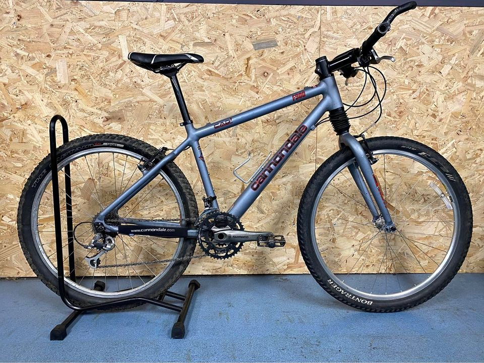

Hi Folks. Ive got a couple of the go but i thought i'd share this one first.
No build pics yet as I'm still in the process of hunting parts down but I've a few taster/teaser pictures!
The bike in question is a 10 foot F900. looks great from 10 feet away but its a bit of a dog up close. Decals on order and going away to be painted Viper red

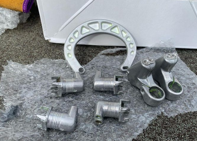

Strip down the chipped/faded/scratched maguras..
Got these in primer yesterday, scotch tonight and then paint and await new decals
I've always loved that color on Magura's. It's going to look so good on a Viper Red bike.

Davecara
Martyn still professes his love for Cannondale bikes whenever they do a bike vault segment on the GMBN Dirt Shed show. He is the main reason I watch it too.

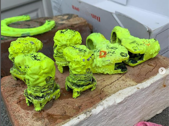

purpurite
For what it's worth, if you are painting them in fluorescent yellow like the originals and not having them powdercoated, you need to use a white primer basecoat before the fluorescent coat if you want the color to really POP. Otherwise, it's a dingy color with no "glow."
