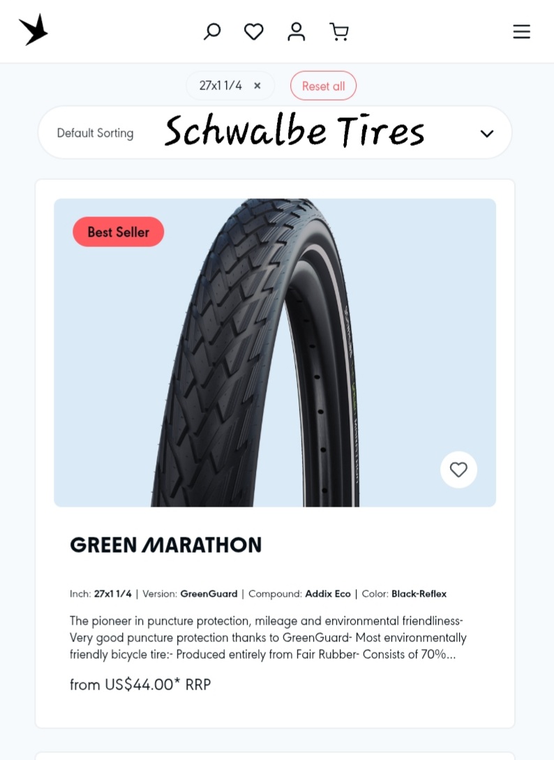

If you want to keep those original wheels, you are going to be severely limited in tire choices, since 27" is almost extinct. Especially if you want a quality tire, which I assume you do. For what purpose do you want a large tire? A 27×1-1/4 will certainly fit, I think, although there is always variation depending on the manufacturer. (1-1/8 being the original size) I have used the metric equivalent (700×32) on a touring tandem that had a combined rider weight of over 300 pounds plus small panniers and a trailer, riding dirt trails and occasional gravel roads, with no problems. Your biggest limiting factor will be the brake caliper clearance.

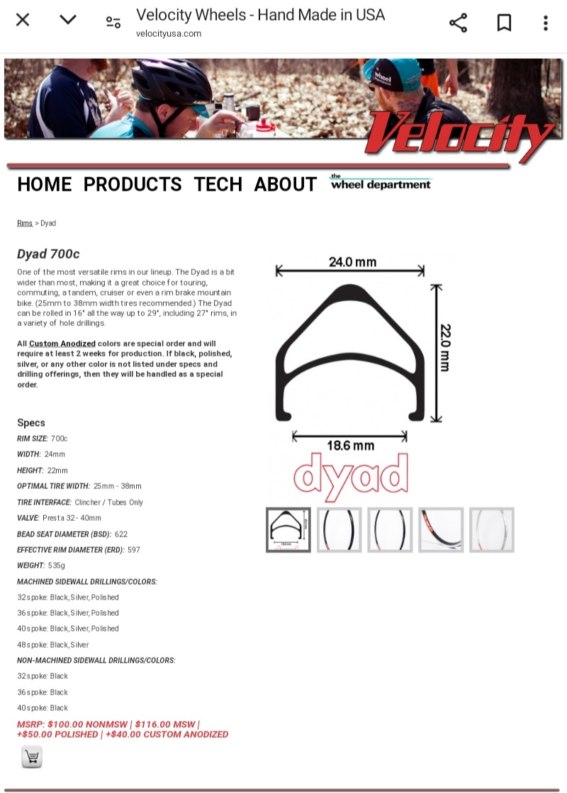

You may consider buying a new 700c wheelset. It would be of better quality, if you plan to use the bicycle a lot, and give you way more tire options. Plan B could be to have your current hubs re-laced to 700c rims, strong ones, if you plan to tour or ride gravel routes.

Best way to get wider tires will be to switch to 700C wheels. Let me know if that's an option and I'll see what will clear on your frame. I have a couple of mid 80s touring frames here. I'm running 32-35 mm tubulars on two of them, haven't tried anything wider. Note that switching to 700C is likely going to require longer reach brake calipers also.

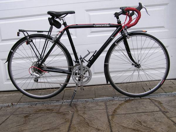

Your bike appears to be a 1985 model, post a pic of the serial number and I can tell you. Anyway, the answer to your question is not an easy one. Early ST frames did not have the dimples on the inside of the chainstays so the condition of your rear wheel and variances in brand/model will be important. Make sure your rear wheel is as true as possible.
I have successfully used 1 1/4 Panaracer Paselas (standard version with no puncture protection) on non-dimpled frames with a very true rear rim. The standard Pasela, in my experience, tends to run 1-3mm larger than the TourGuard/PT version which runs 1-2mm larger than the UrbanMax/TServ/Somafab NewExpress-(basically all the tires running a Hypertex casing) so if the standard Pasela fits then chances are good that the other versions will fit too.
Now for the frames. IIRC, the dimples appeared around late September-early October of 1987 for the 1988 production year. I have a few 88s with the non-dimpled stays but most will have them. On these frames I have used 1 3/8 tires like the Swift Sand Canyon or the Kenda knobby (can’t remember the model) with no problem.
