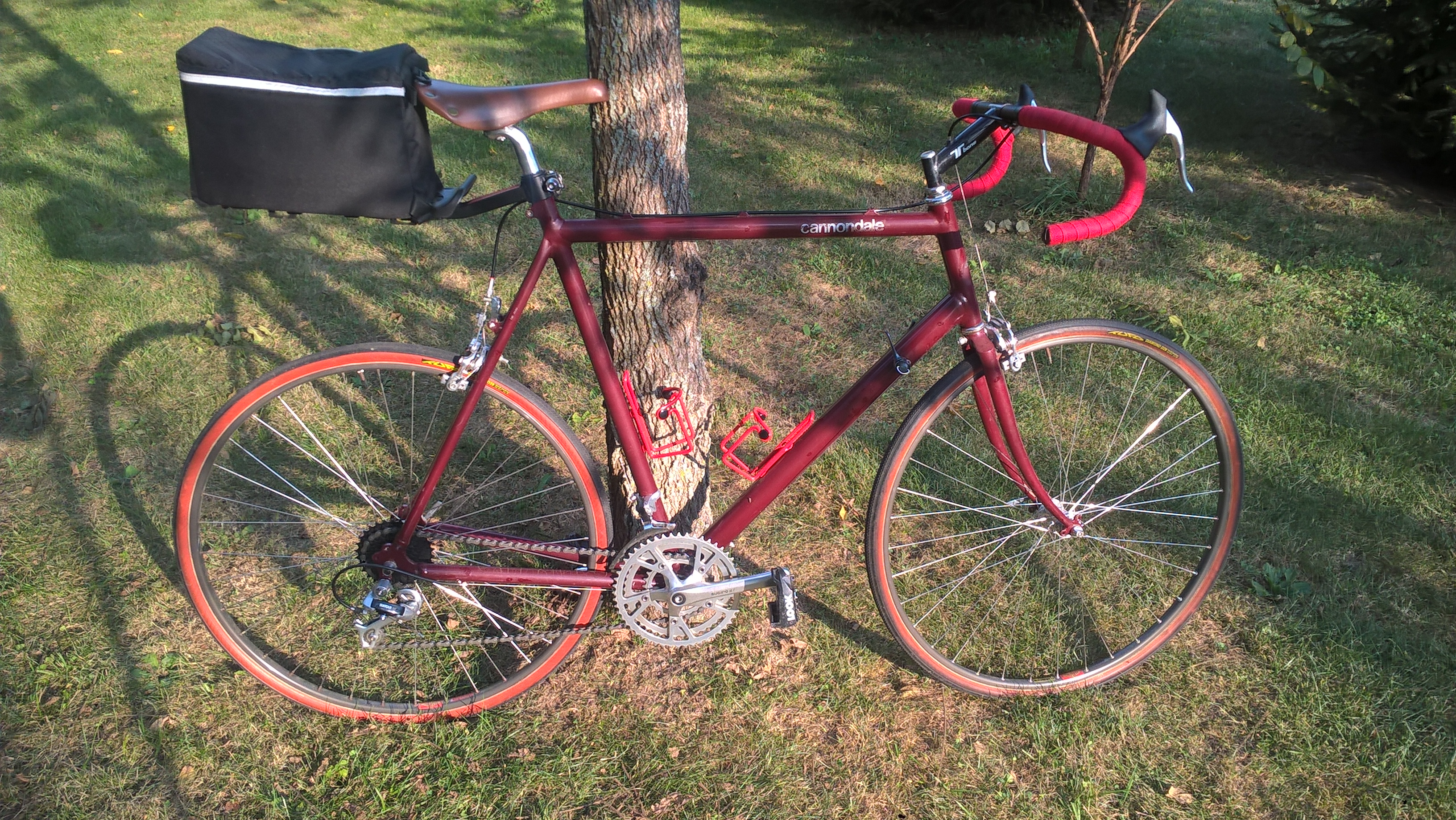

The touring bikes in the mid 1990s came with tires as wide as 38 mm. My guess is that some models of 40 mm tires might fit but I'd feel safer recommending 38s. Let us know if you try 40s. I'm running 33ish tires on a couple of older Cannondale touring frames for gravel and get along fine with that setup. Perhaps the newer frames will fit wider tires than the old ones. Here's the 1985 ST500 with Tufo tubulars.

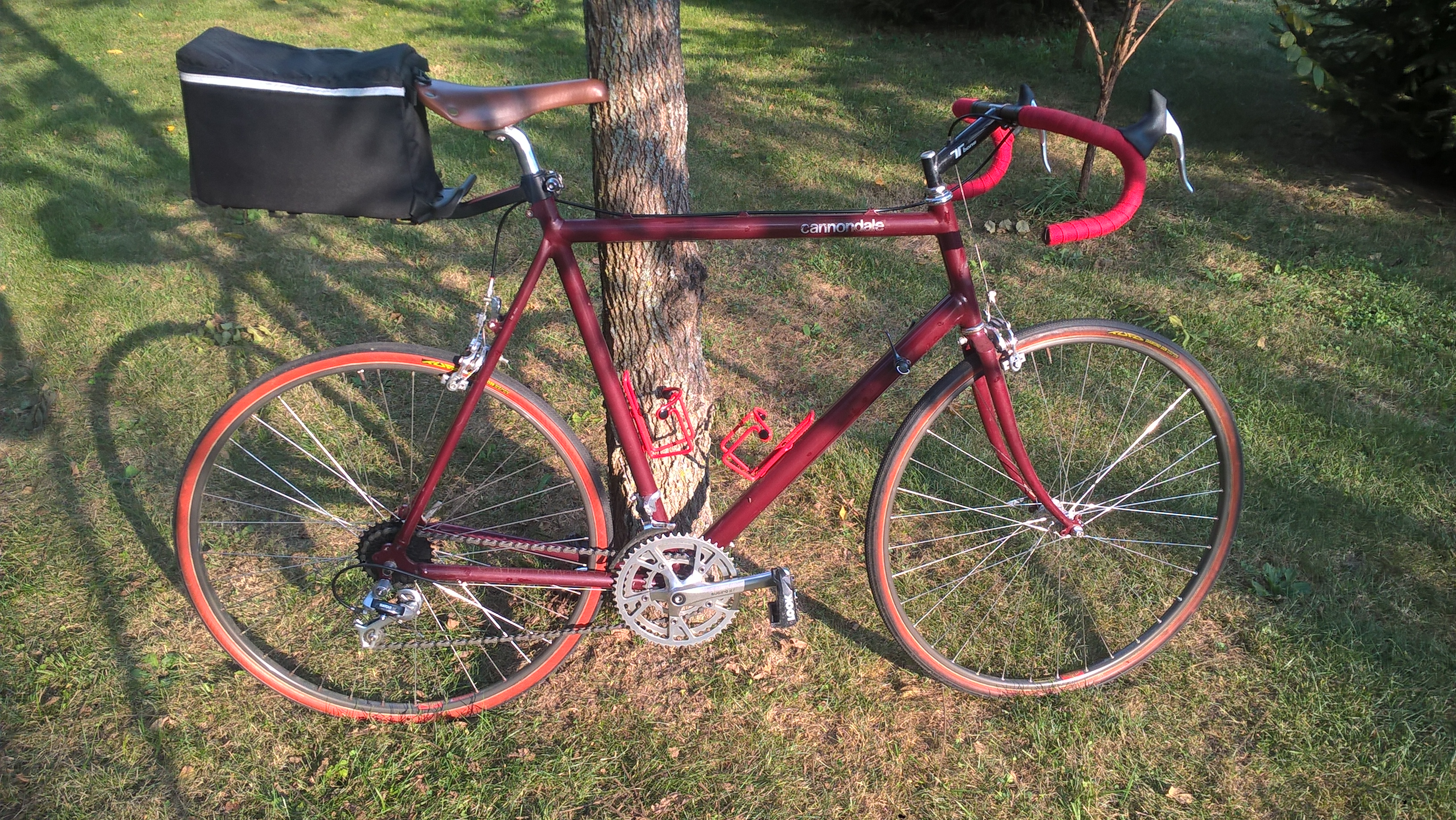

The touring bikes in the mid 1990s came with tires as wide as 38 mm. My guess is that some models of 40 mm tires might fit but I'd feel safer recommending 38s. Let us know if you try 40s. I'm running 33ish tires on a couple of older Cannondale touring frames for gravel and get along fine with that setup. Perhaps the newer frames will fit wider tires than the old ones. Here's the 1985 ST500 with Tufo tubulars.View attachment 5227
