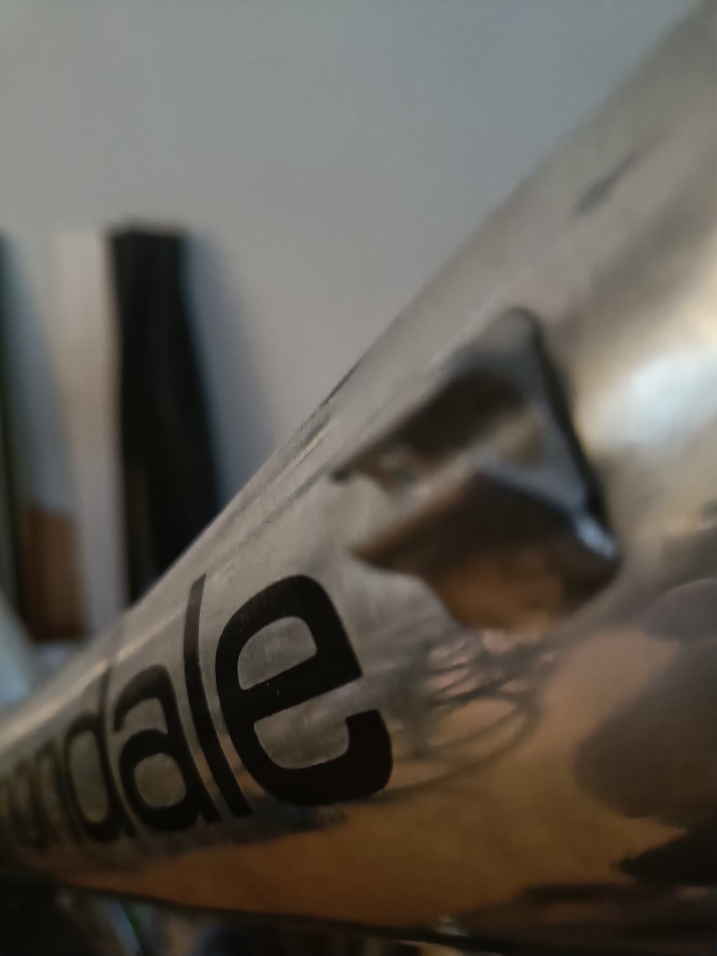

Currently I am working on the restoration of a Super V 1000 polish.
I would like to bring it back to original state as best as possible.
As with a lot of bikes from this era, after market Magura hydraulic brakes were installed.
To guide the brake lines the cable stops were drilled out to make place for the plastic tube.
Because I want to reinstall the original cantilever brakes I need to have some kind of cable stop.
Does any one of you have an DIY idea how to fix this?
I would probably epoxy some inserts into the original stops. They would likely need to be made on a lathe but would be easy to make. They would just be a cylinder of the same diameter as the drilled out guides with a hole for the cable to pass through. A version could be made that wouldn't require bonding. It would have a smaller outside diameter that slips into the drilled out guide and a larger outside diameter that seats against the end of the existing stop. The 2nd type wouldn't look as original as the first but wouldn't rely on the bond to take the load on the cable. I could make either type if you can't find someone to make them locally. What is the inside diameter of the drilled out guides? I have lots of these 6 mm outside diameter ferrules that might work.

Ok, crisis averted.
I found a ferule that exactly fits the cable stopper. It is big enough for another cable including an extra smaller cable stopper. So it is a nice tight fit.
What also helped is that I figured out by looking at a lot of images from SV's, mainly on this website, that the brake line is on the left and the rear derry is on the right.
The drilled out stopper were on the right side so now the brake line follows to original path and thus untouched cable stoppers.
