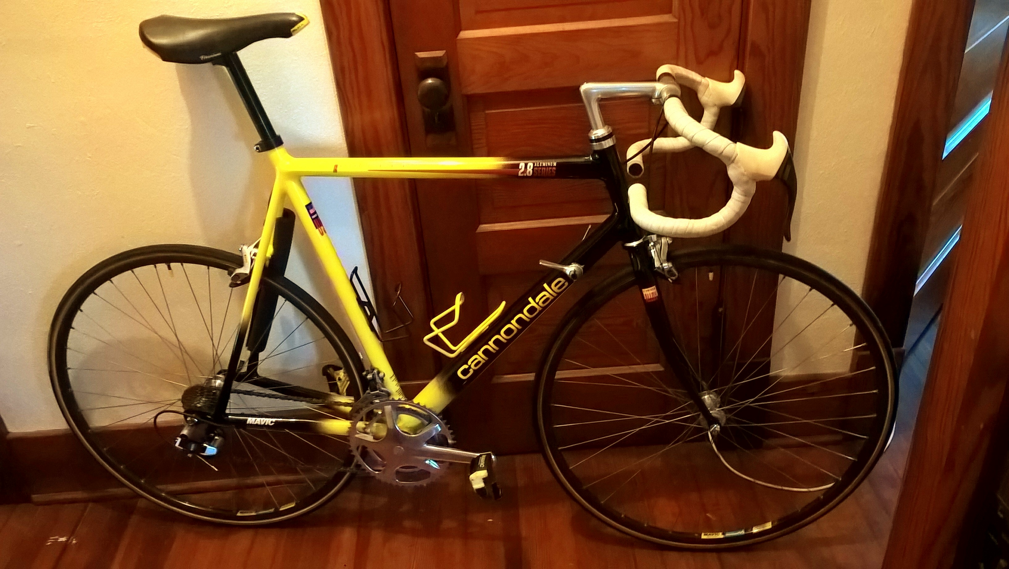

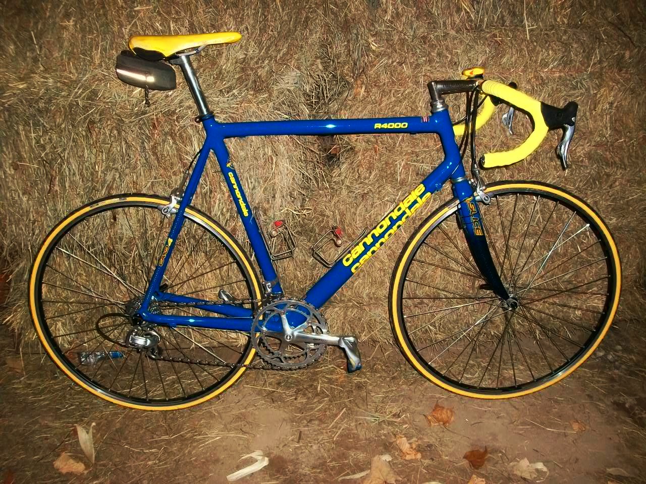

Here's my Mavic Equipped 1992 R1000 and my team blue CAAD4 1999 R4000.

Yours are some fine-looking examples! Thanks, again for sharing your wisdom on the topic.
I wondered about the yellow as I only remembered the Mavic bikes and a TT bike being yellow in the 2.8 era.
