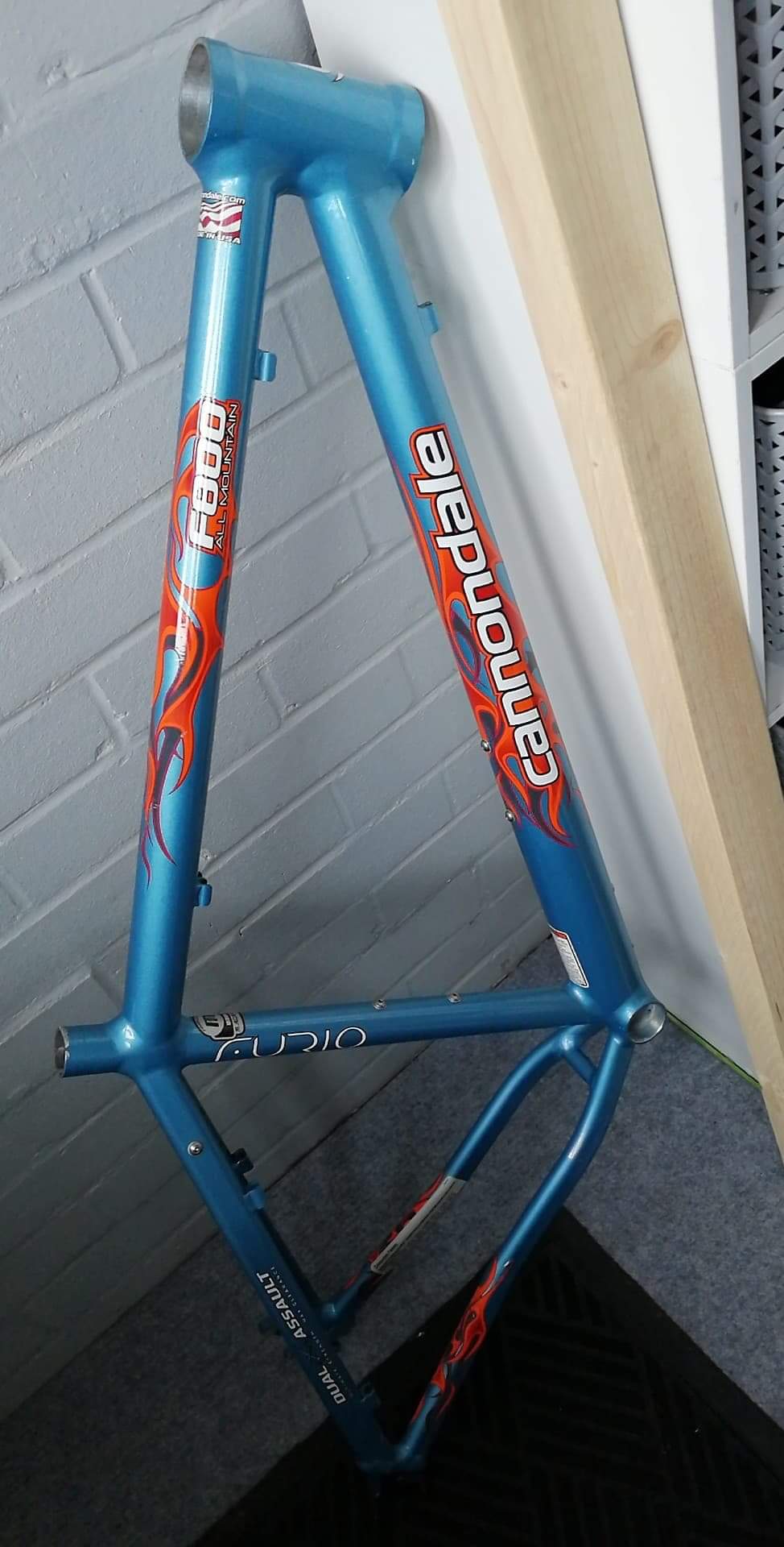

New to cannondale as I normally ride klein, orange or marin.

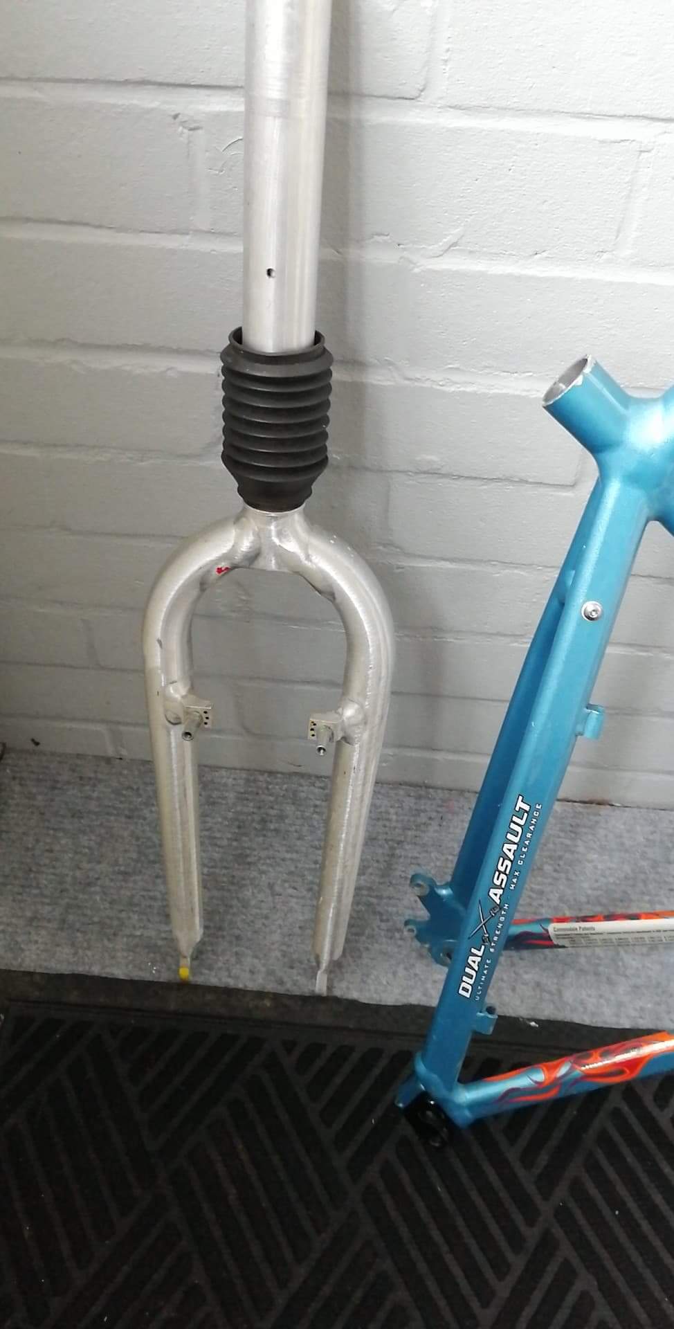

I have just bought a 2004 f800 frame and I think an older headshock fatty fork.
Can anyone help me with what else I need to put the fork onto this frame please.
Regards

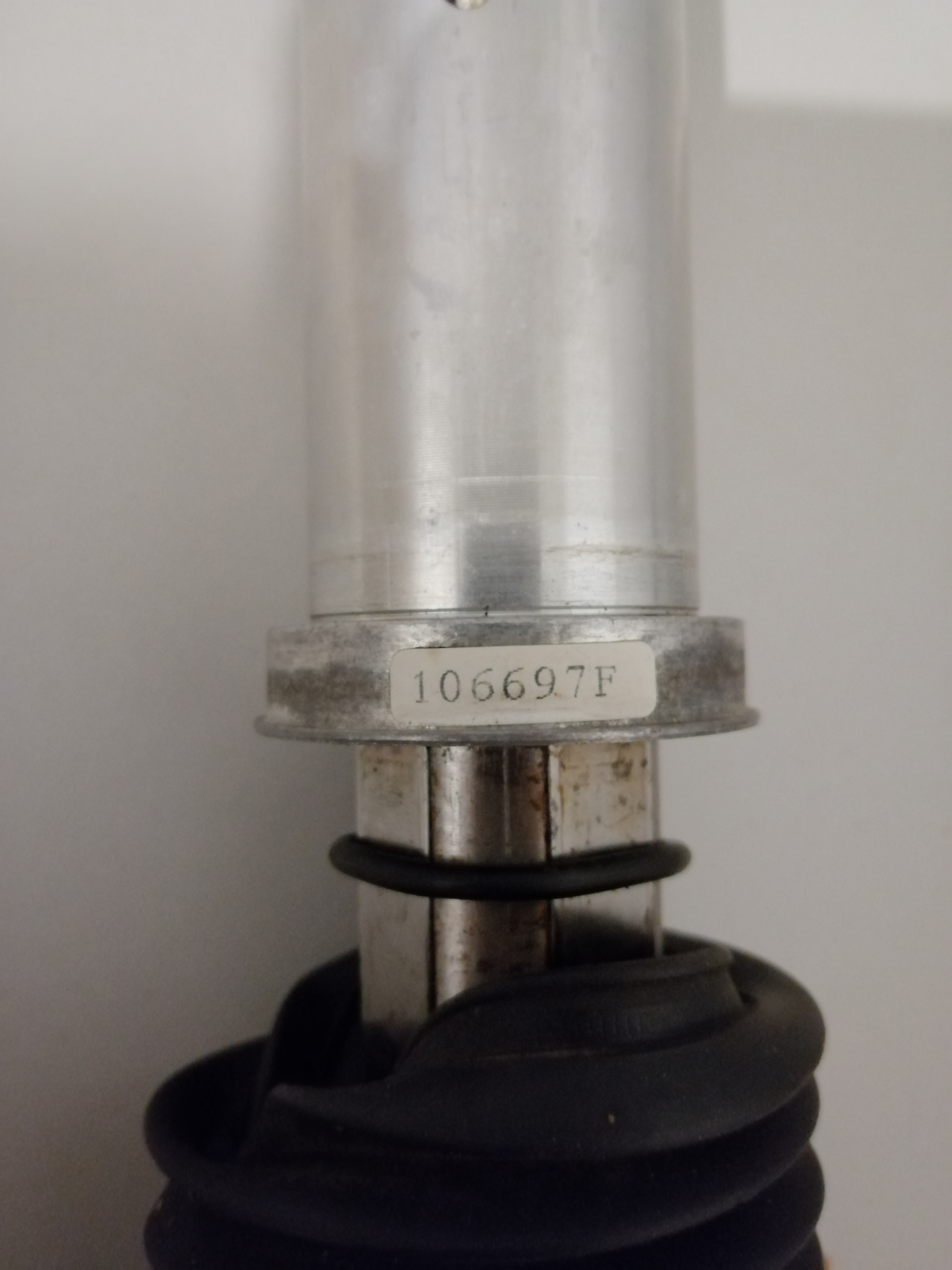

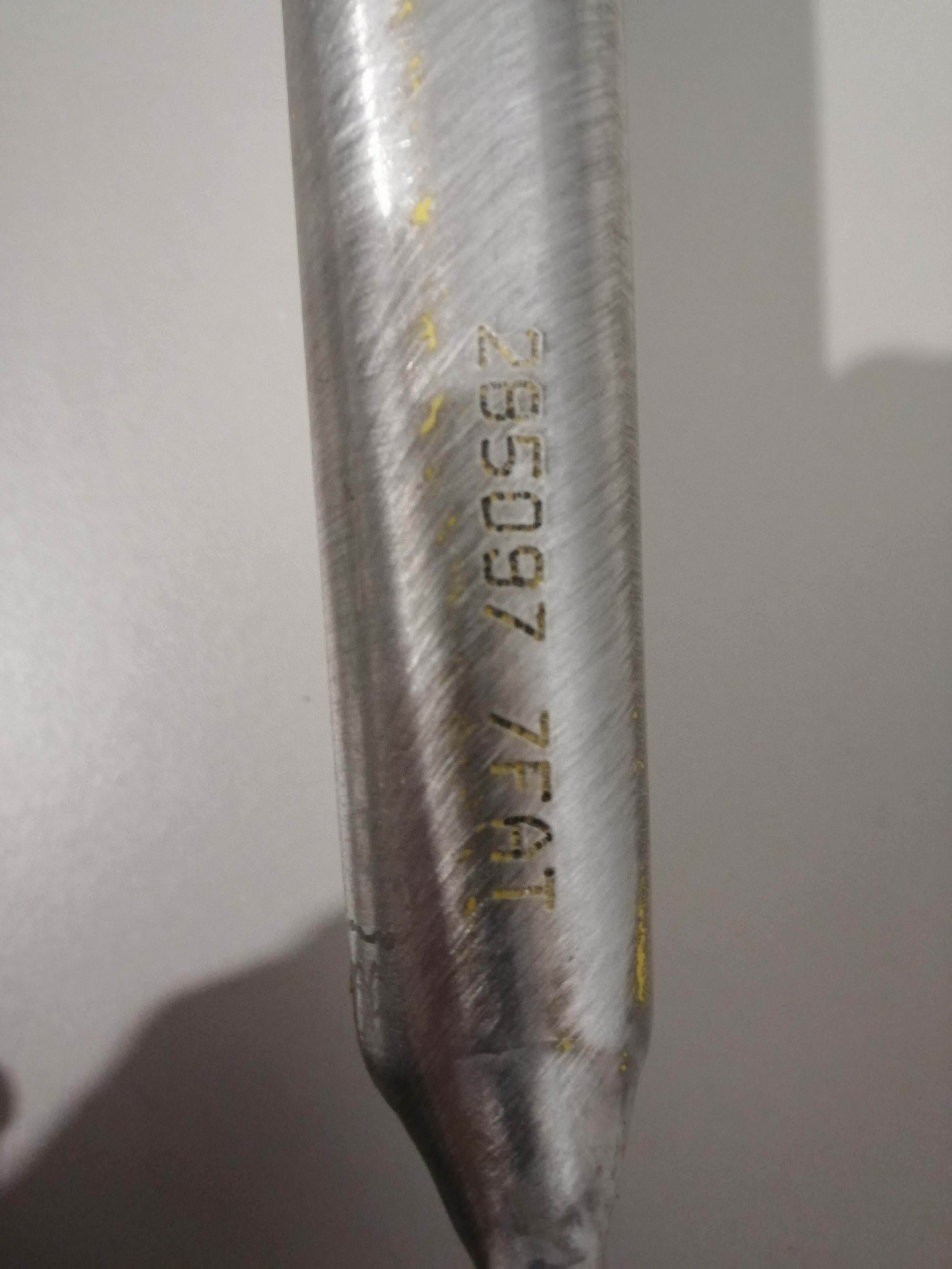

My fork has a serial number do you know what year etc

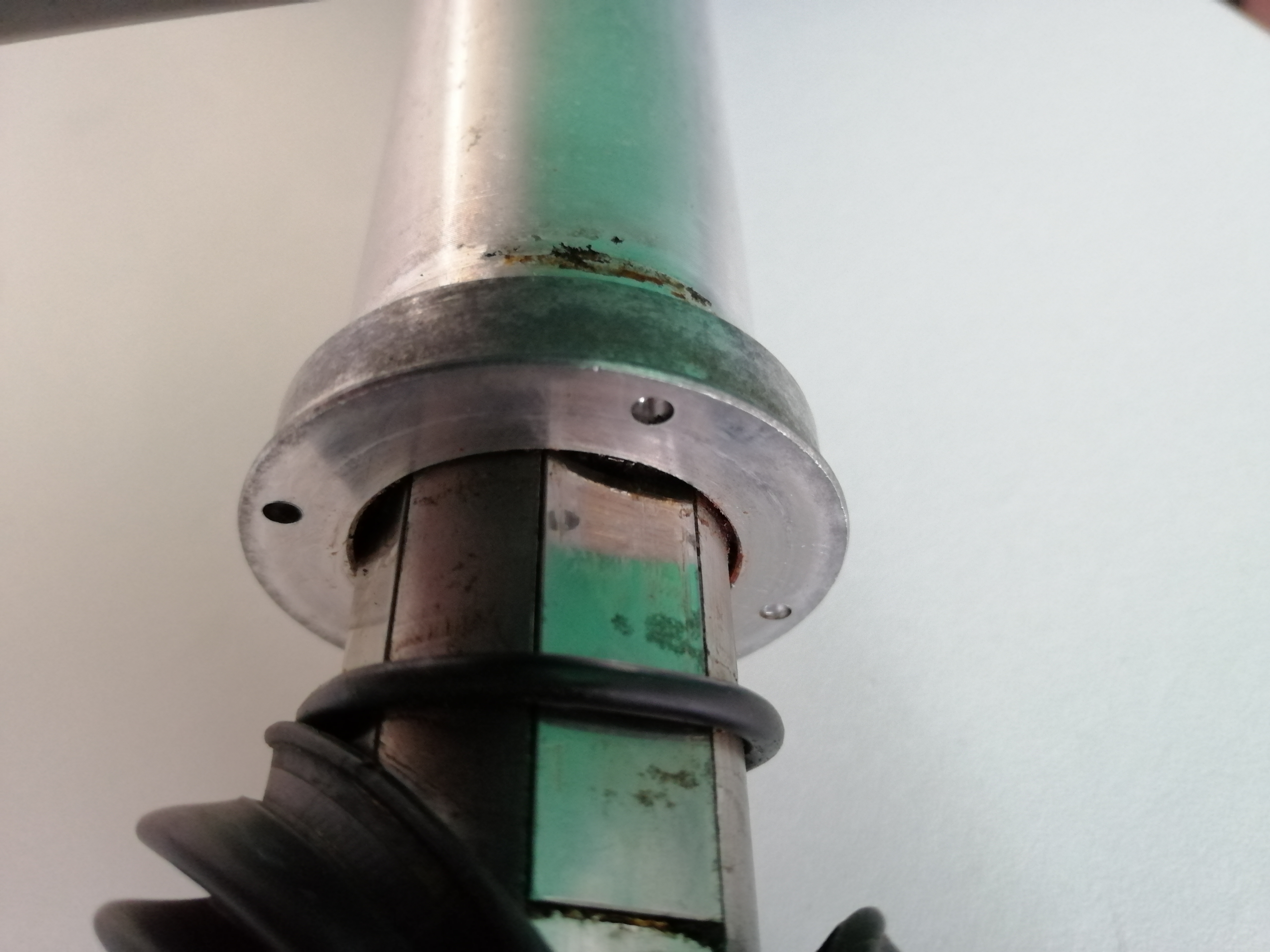

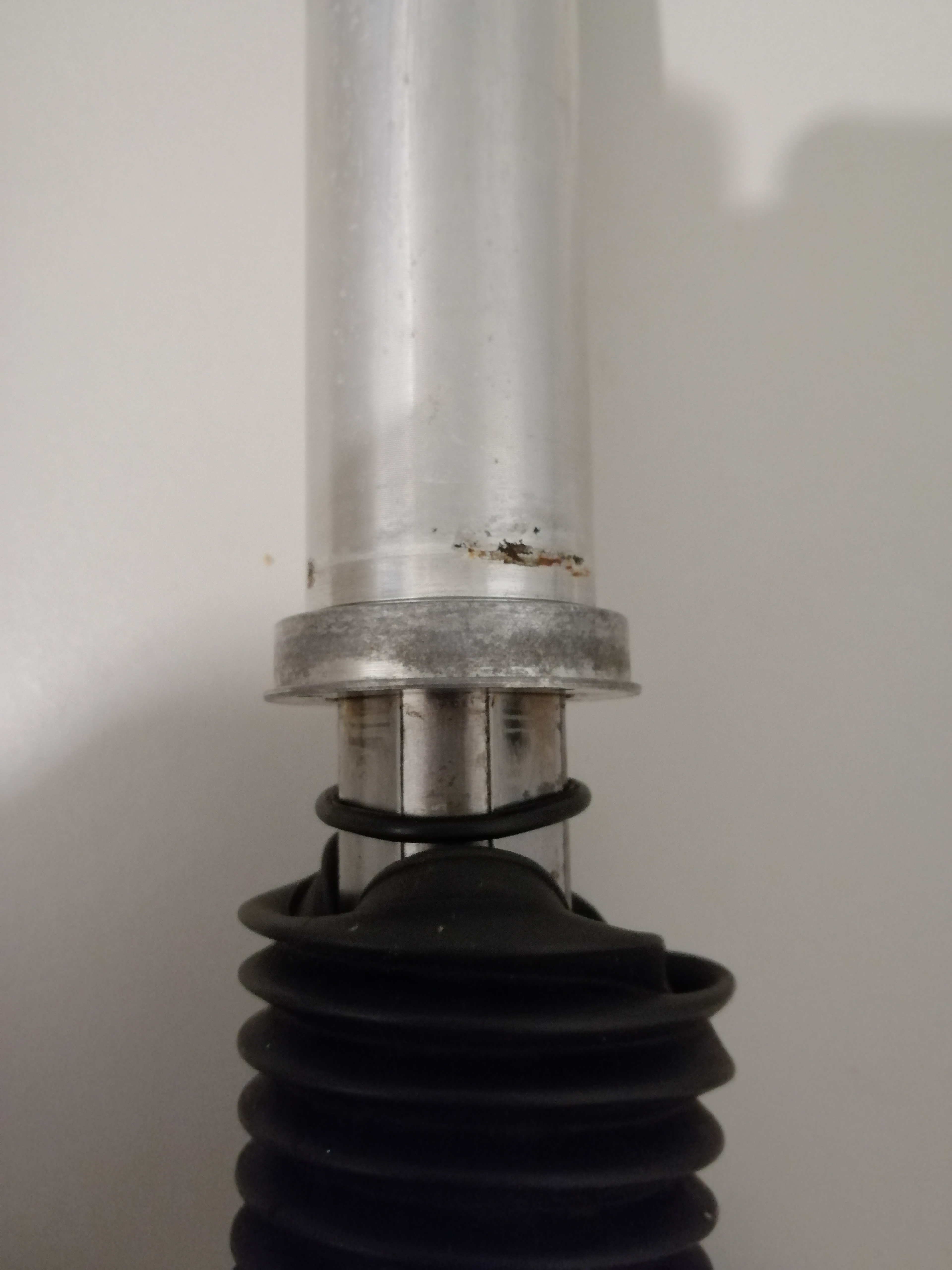

What is the loose o-ring for?
Regards

It's held in by press fit. Once it's hammered in with the pipe tool, you're done. yours needs a bearing driven on the steerer tube first, that can be done with the pipe tool. Install the fork as shown in video. A seal then (#QSMSEAL) goes on top, then the stem.
The O ring is a bottom out bumper.

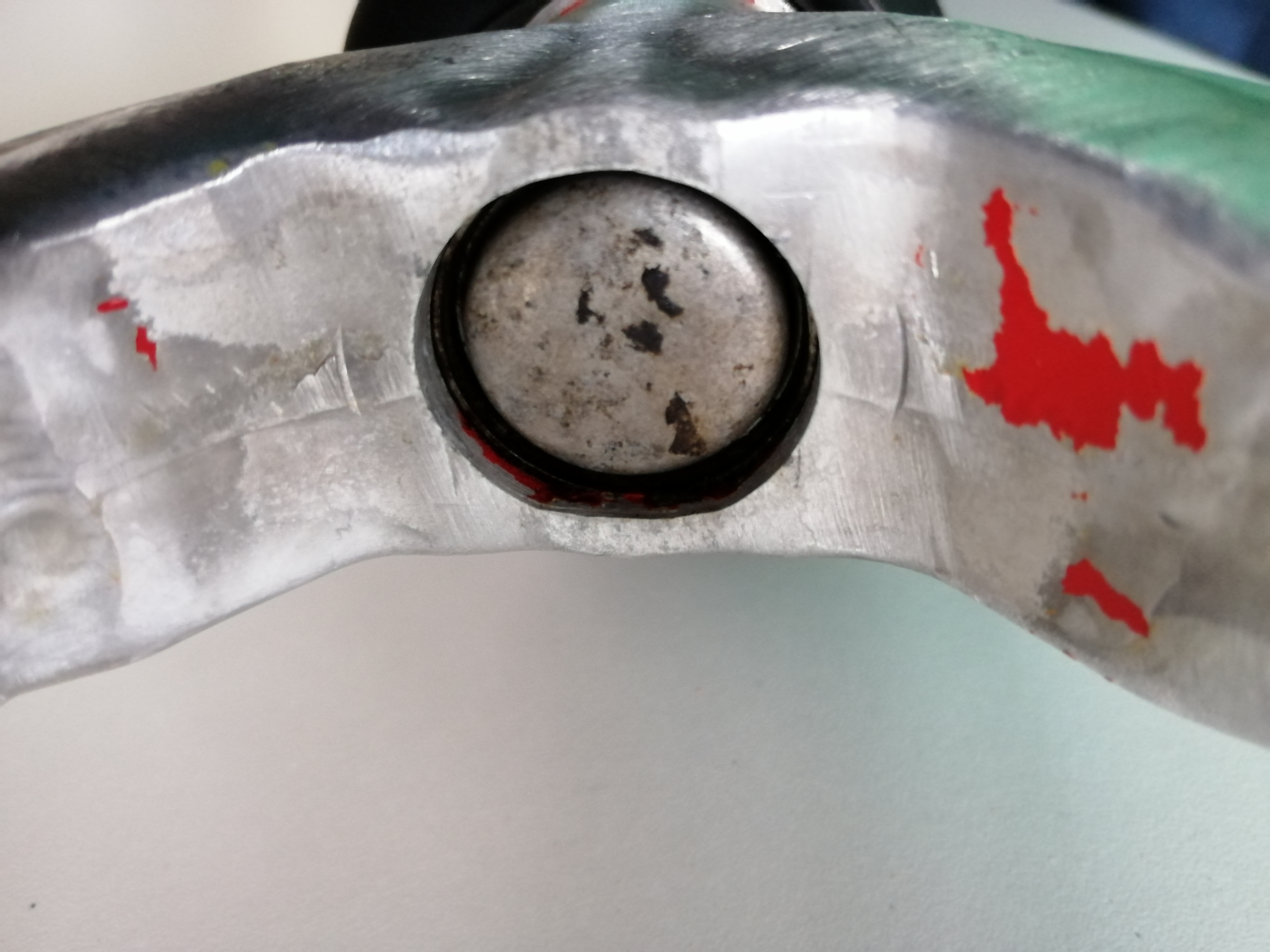

I can't tell you anything with the serial number. With the paint stripped off, It's hard to tell exactly which fork it is without pulling out the damper. I may be able to give you more information with pictures of the top and under the crown.

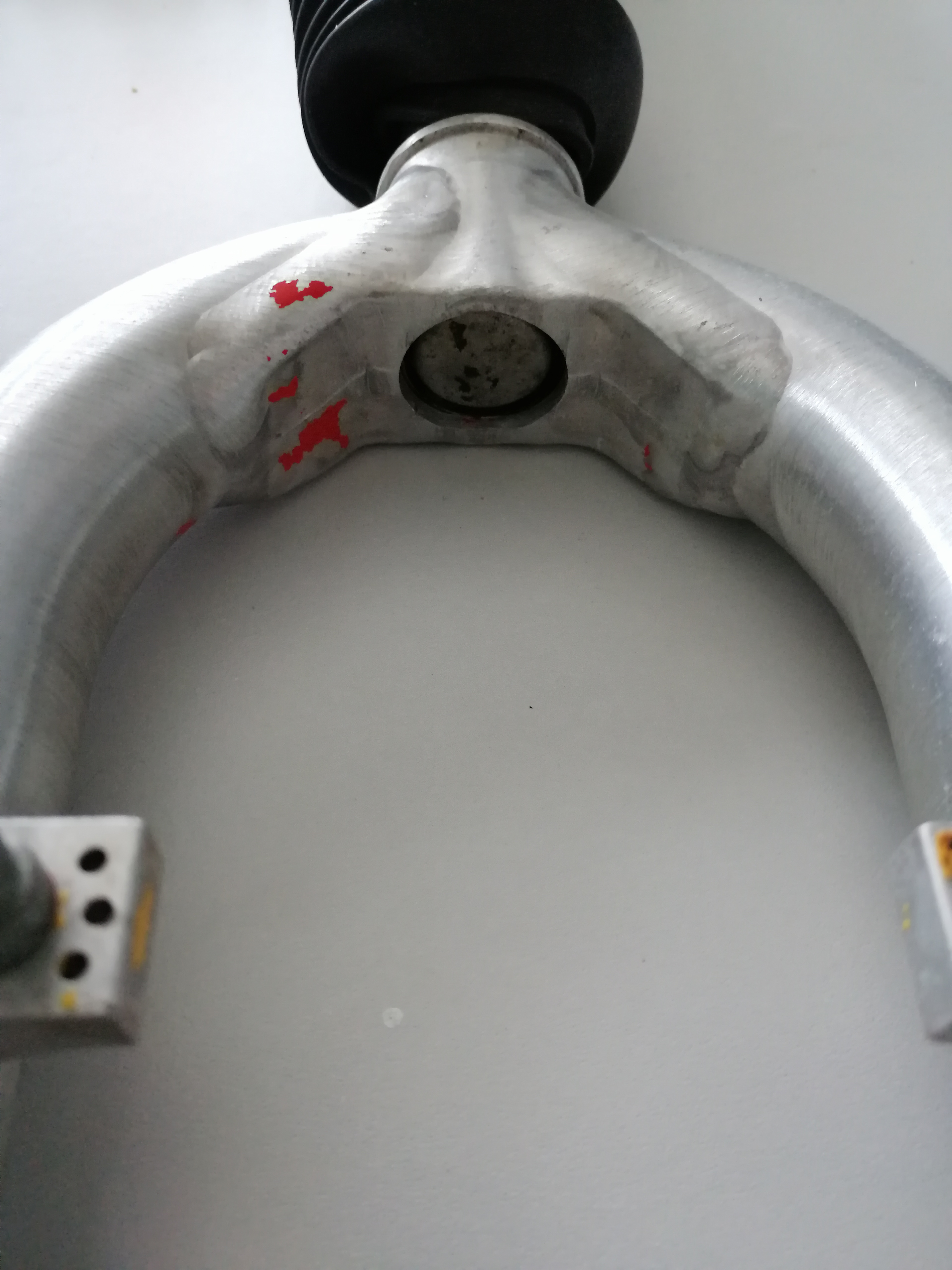

Whayne Hawkins
Hi
Thanks for the info.

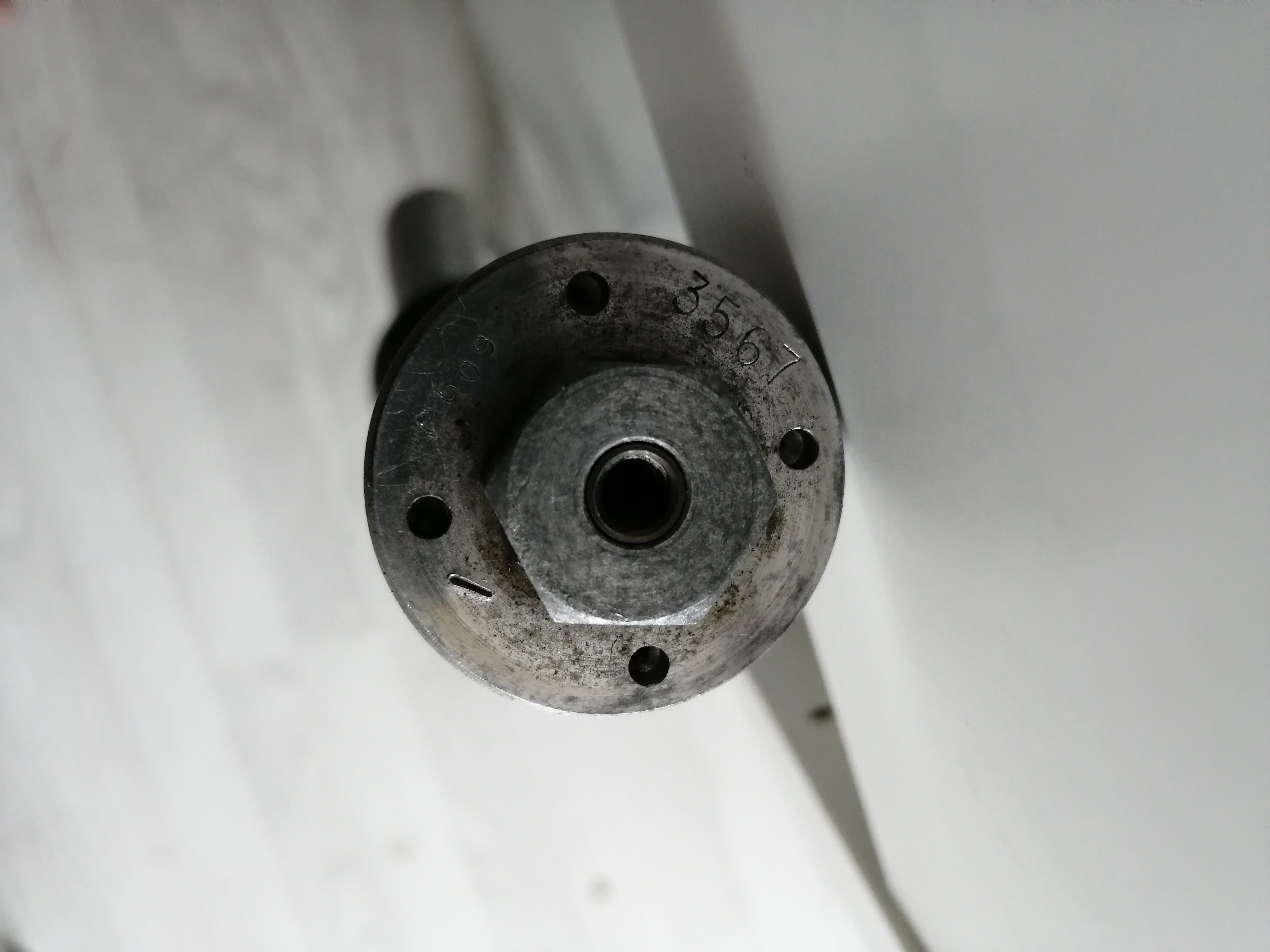

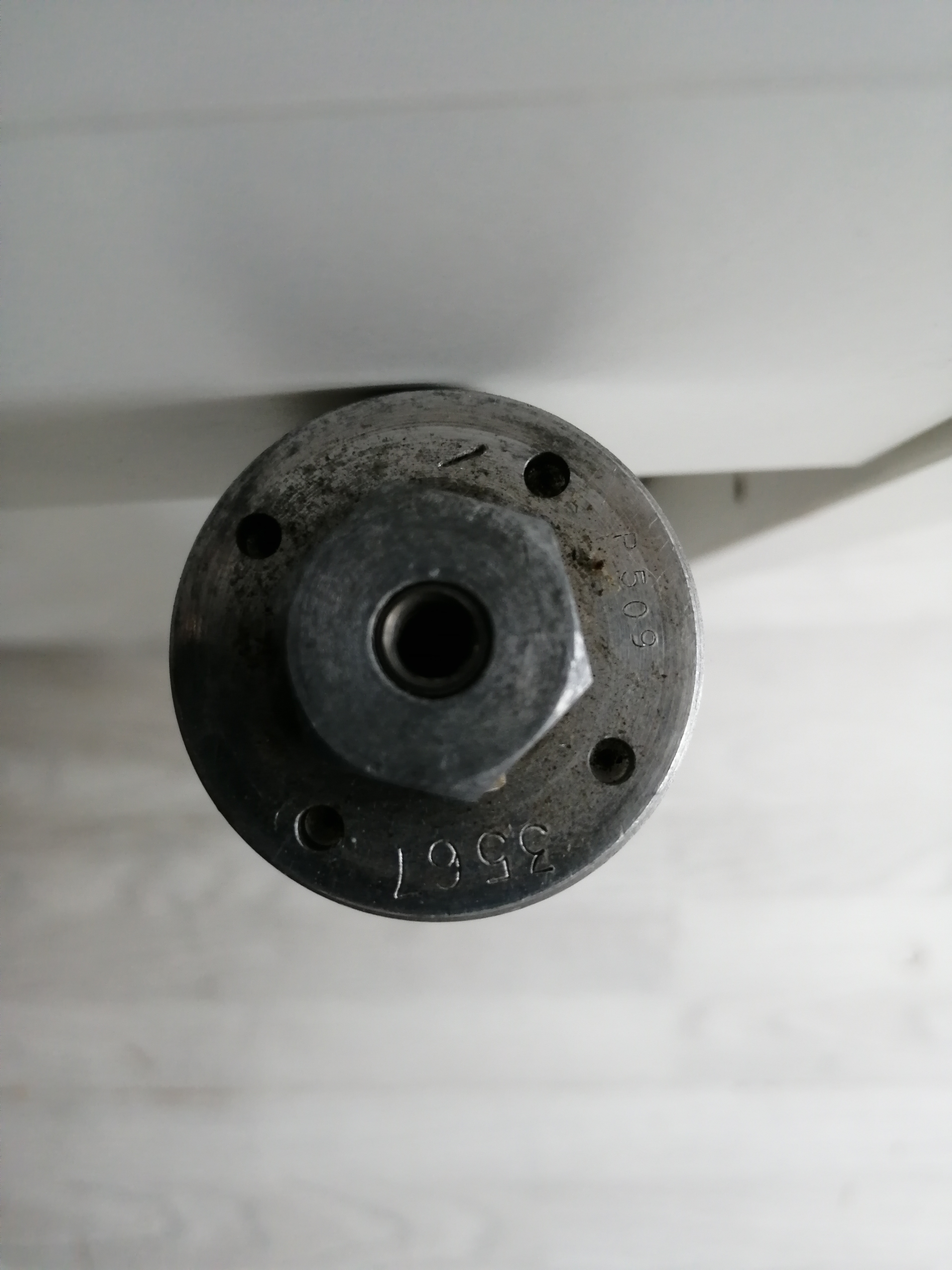

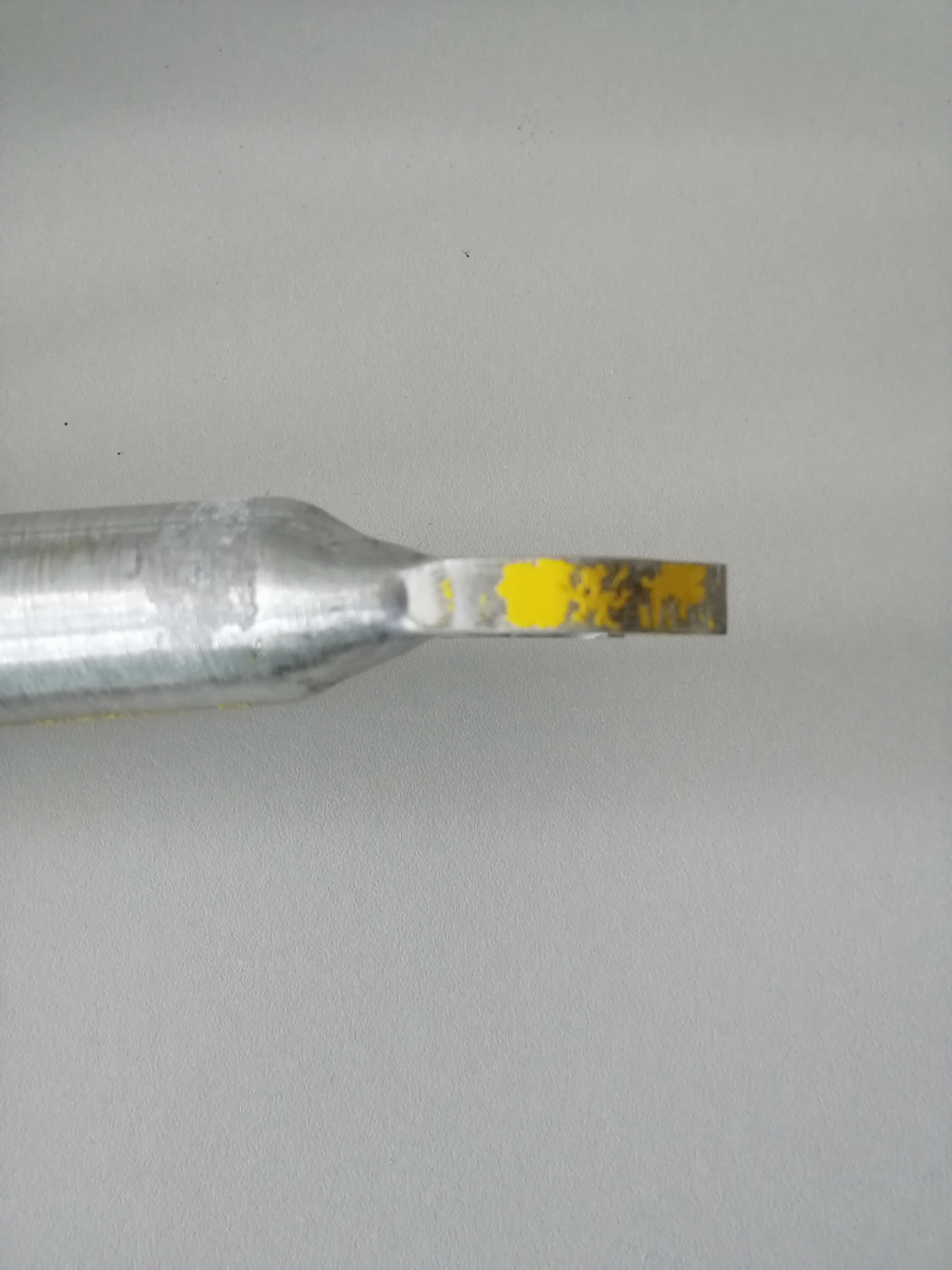

The fork was red and yellow as paint is still on fork legs.
Looks like a mc60 fork maybe.
More pictures attached
Thanks for your help

MikeA
Ok, It's not an MC60, which is good, that was just a cheap friction damper. You have an oil damped cartridge with lockout. You are missing a knob or lever that attaches to the hex on the top, that's your lockout knob. It's not an air sprung fork, and it looks like it has the tapered blades, so my initial guess is you have a Fatty D. It's an oil damped DD60 cartridge and is coil sprung with an MCU slug nested in the coil, 60mm of travel.
