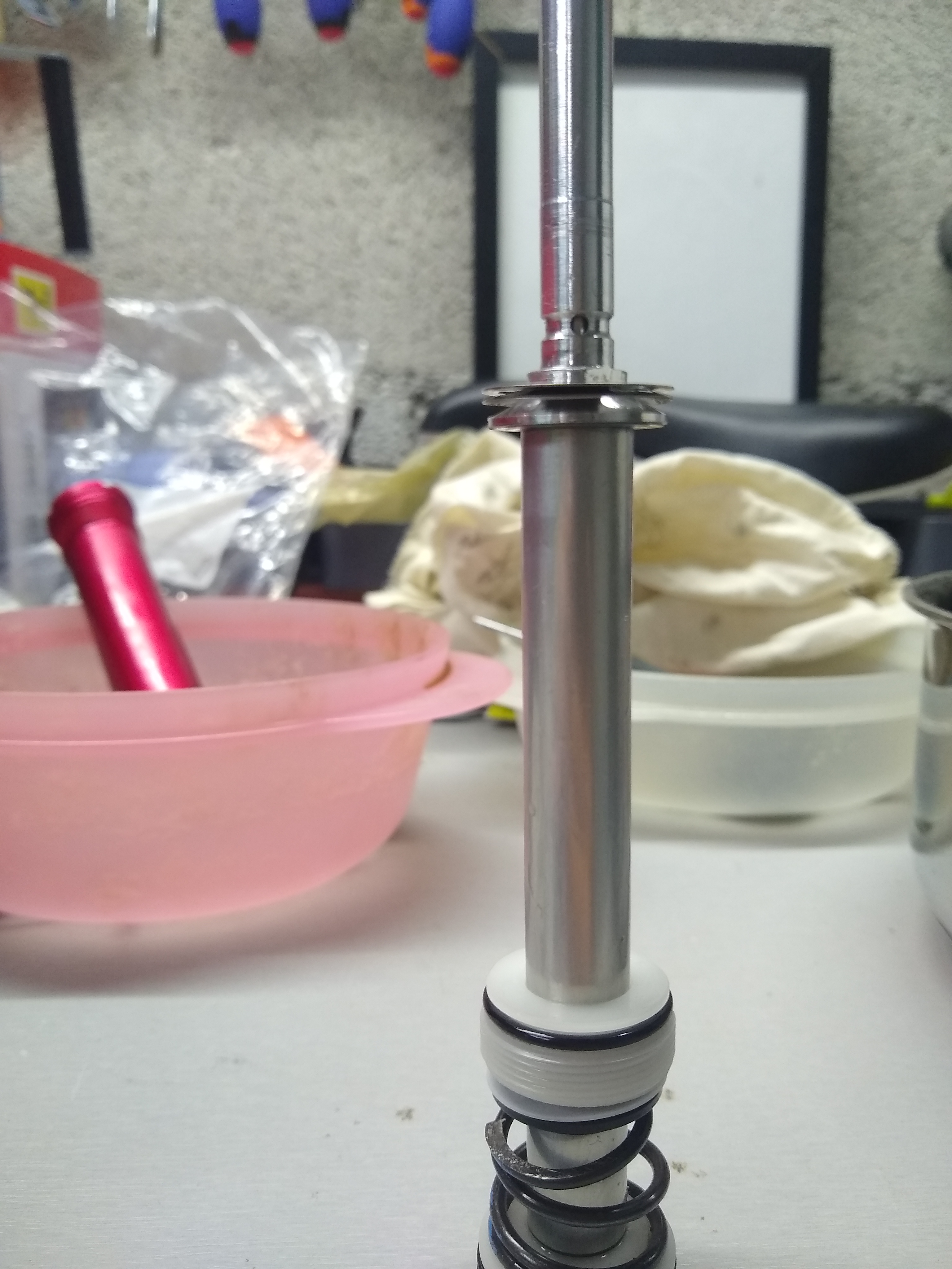

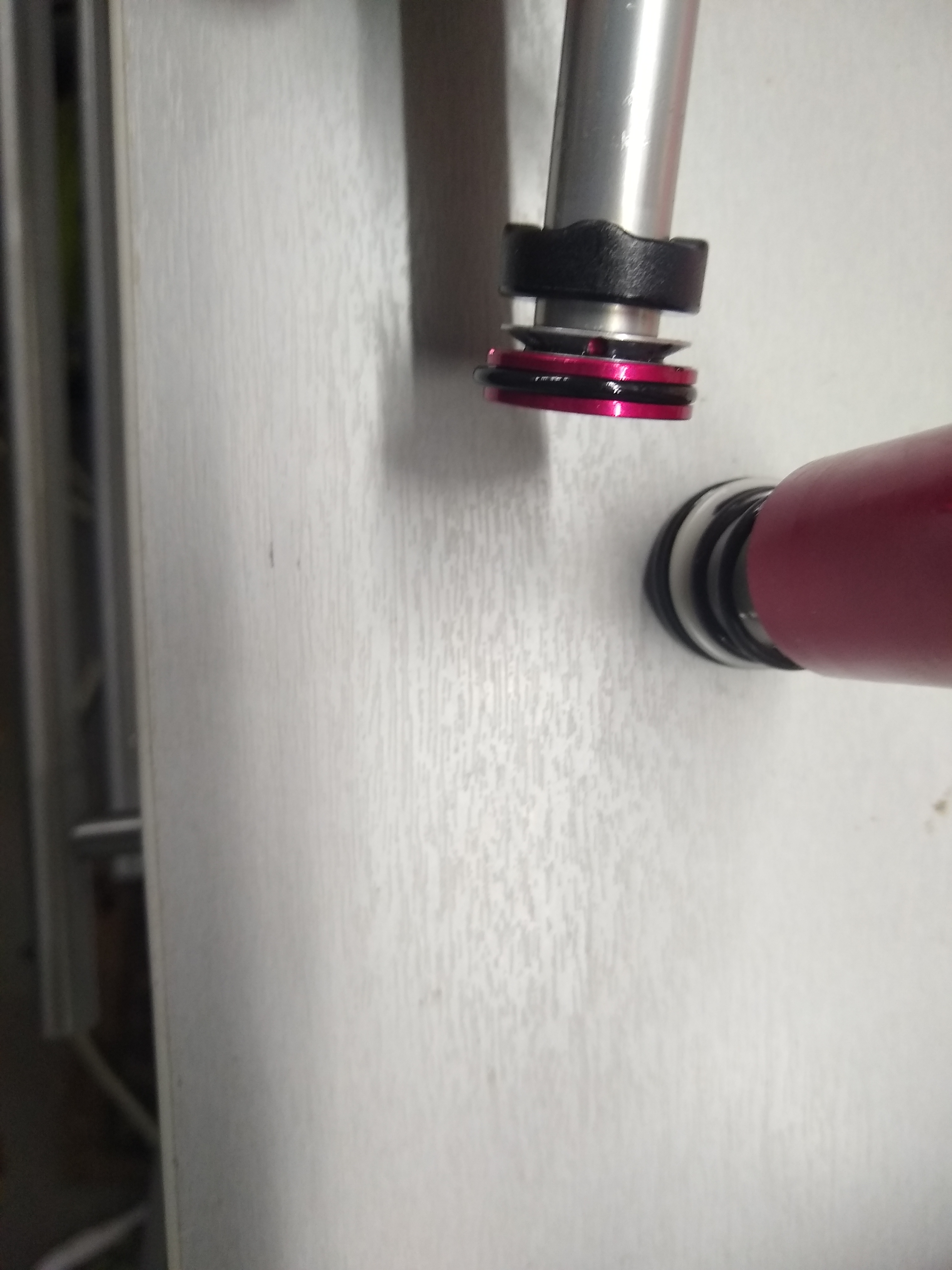

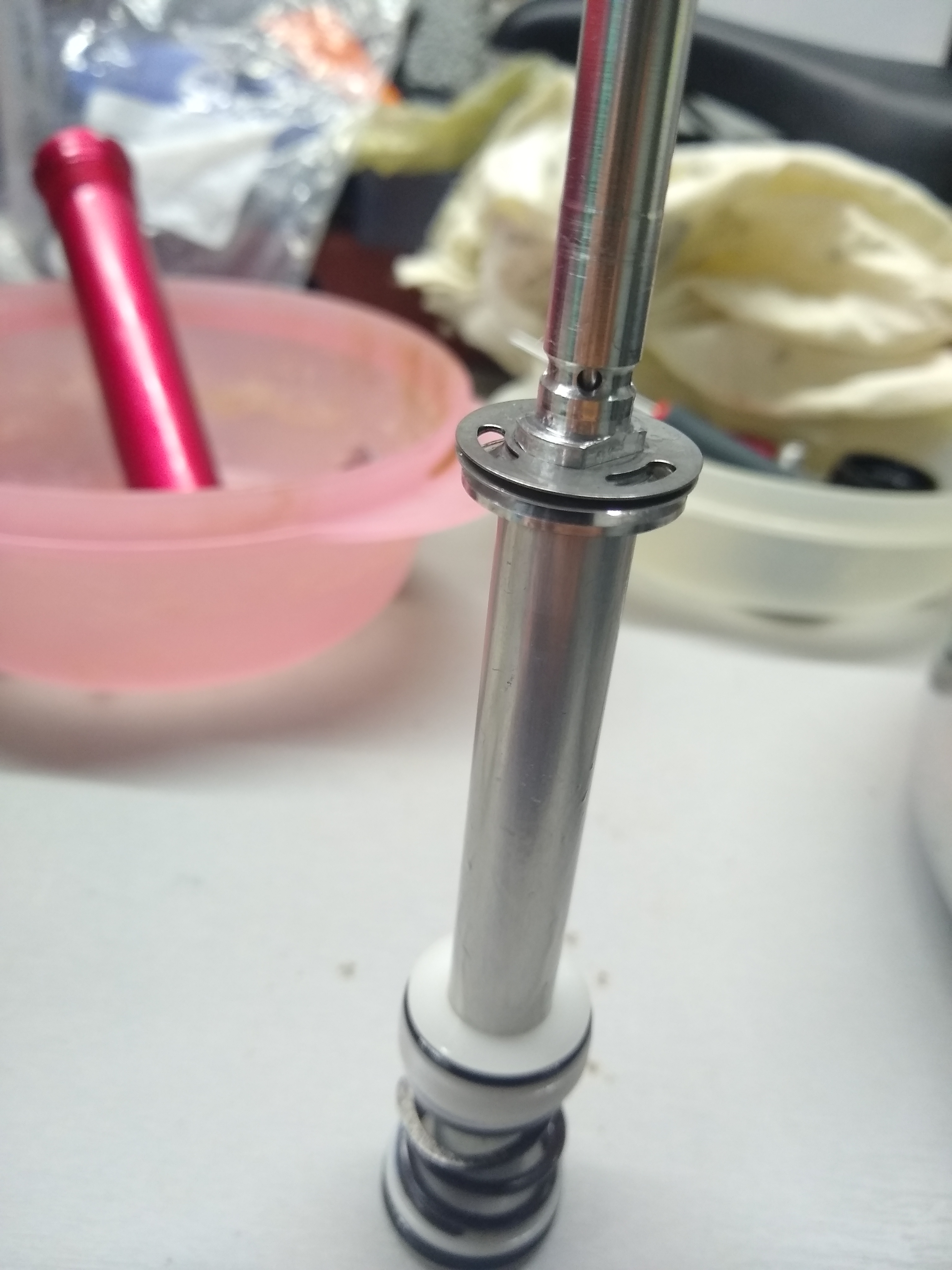

And here are some pictures for next newbies who will try to repair the fatty wiithout any pictures of the proces... :D
The flat washer is in contact with the red "piston" and the convex washer under it.

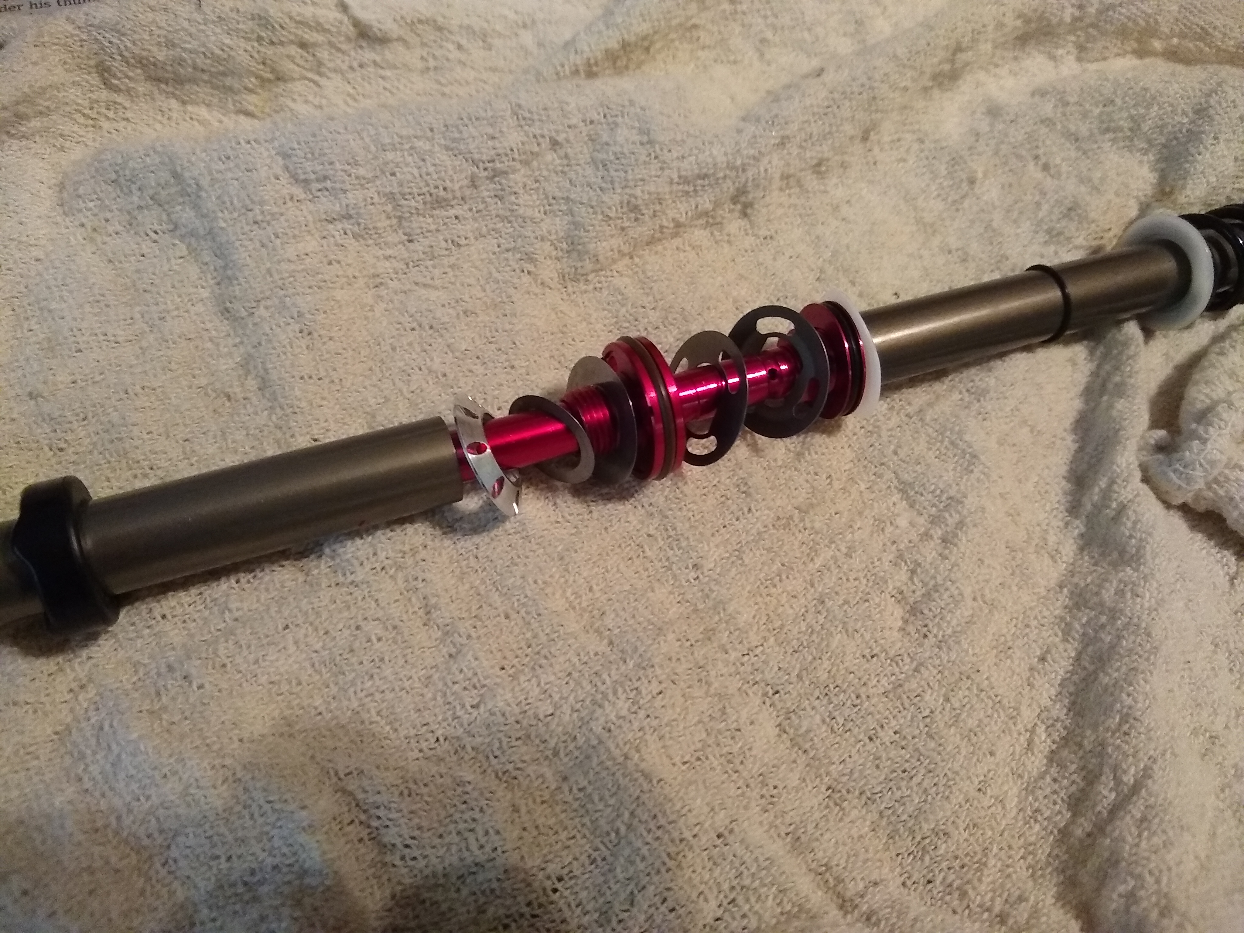

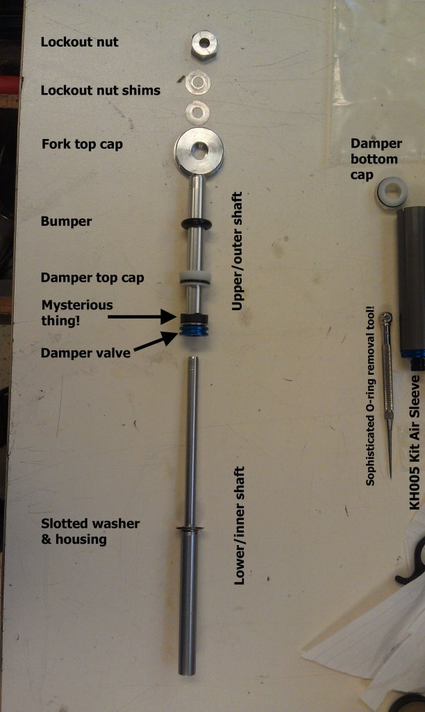

Sorry I missed this post earlier. I think you still have the lockout shim assembled wrong (the slotted shims). The concave side of the lower shim should be facing the flat shim. Here is a slightly different DLR80 showing the correct order of assembly:
Also, It looks like your negative spring is broken or bent? be careful it doesn't scratch the air cylinder.
