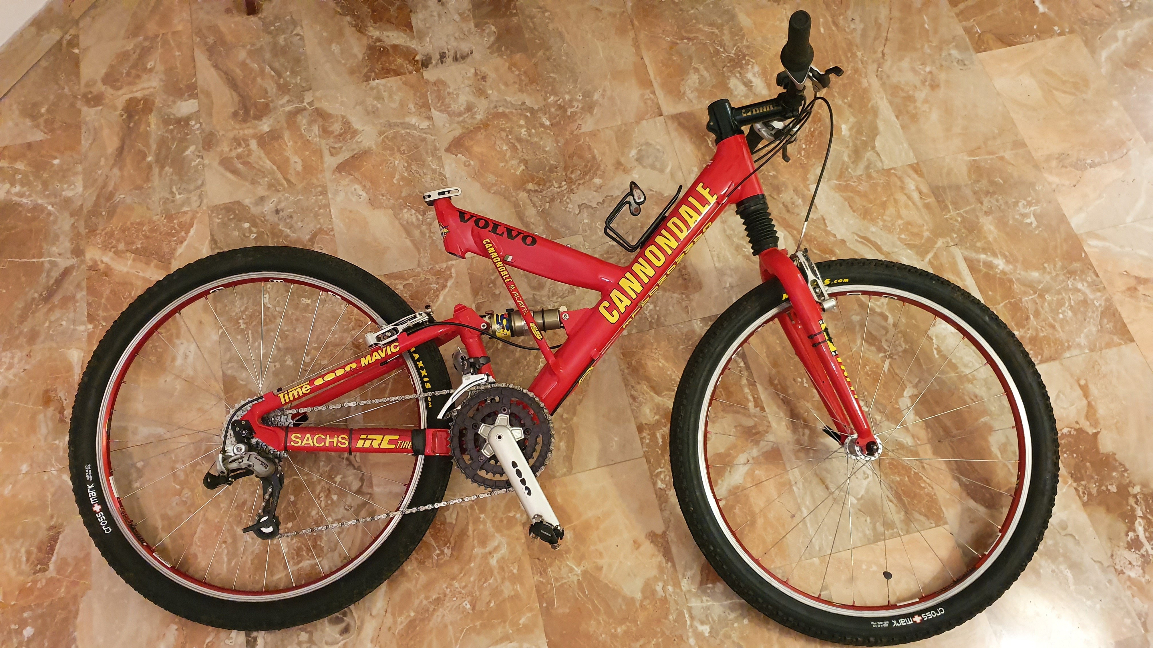

hi
i need help.

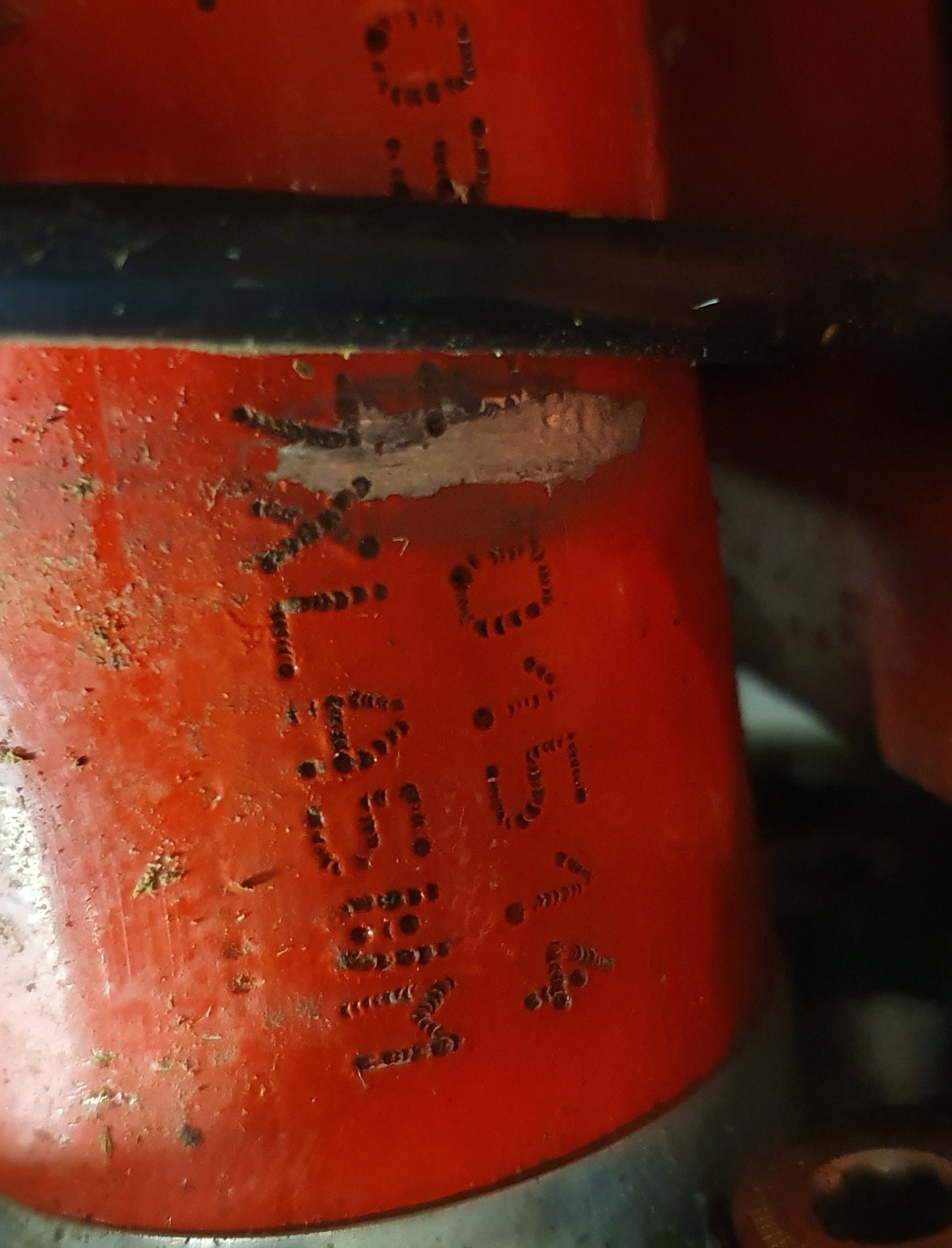

can someone help me to understand if this frame number could me of an official cannondale volvo racing team frame?
many thanks
Hard to read but looks like it may be IA upper left, which would translate to 1997, January. Team bikes were Viper Red at the time. Assume that's a Super V. If a team bike it would have had top end parts on it. Saeco team frames had the rider's name abbreviated at lower right on the bottom bracket shell, I assume the Volvo bikes did as well. The KLAS?M looks interesting but doesn't bring to mind any team riders for me.
gringo75
thanks for reply

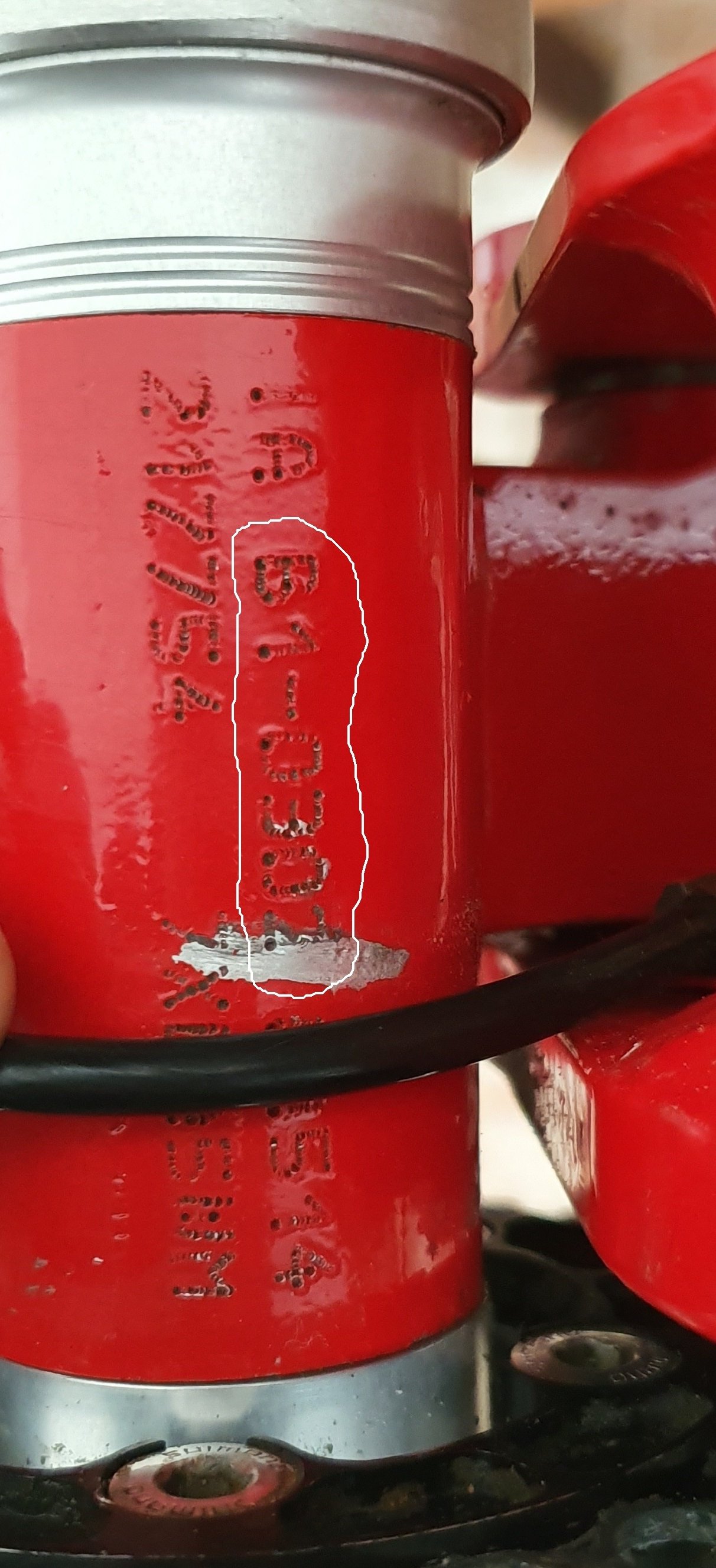

sorry picture was not very clear, i try again now, upper left is ". A ", strange!
lower right there is an X and not K.
i think that the strange point is upper left.
owner told me that is Annabella Stropparo's bike.
I think there is something to the left of the A. Looks more like a 1 than an I, but that wouldn't make any sense for the model year. I checked the closest year frame I have here, a 1995 M900. It is clearly marked FK at upper left for 1994, November. I suspect that your frame was meant to be IA even if it it is fact stamped 1A. Is the bike a Headshok Super V? Annabella was a cross country rider. The cross country team rode hardtails in the photos I've seen but perhaps rode full suspension at some events. If it has the Moto fork it probably wasn't her bike. The WM (women's medium?) is where the size is normally designated in this era, but Cannondale didn't have women's specific sizing at the time. My frame is clearly stamped 20 there as the 2.8 M series frames were sized in inches. The W on your frame looks to be hand engraved. Perhaps they did special sizing for the team. I think the only way you can get a good idea of the bike's history is to look at the parts and decals and compare them to photos of team bikes from the period.

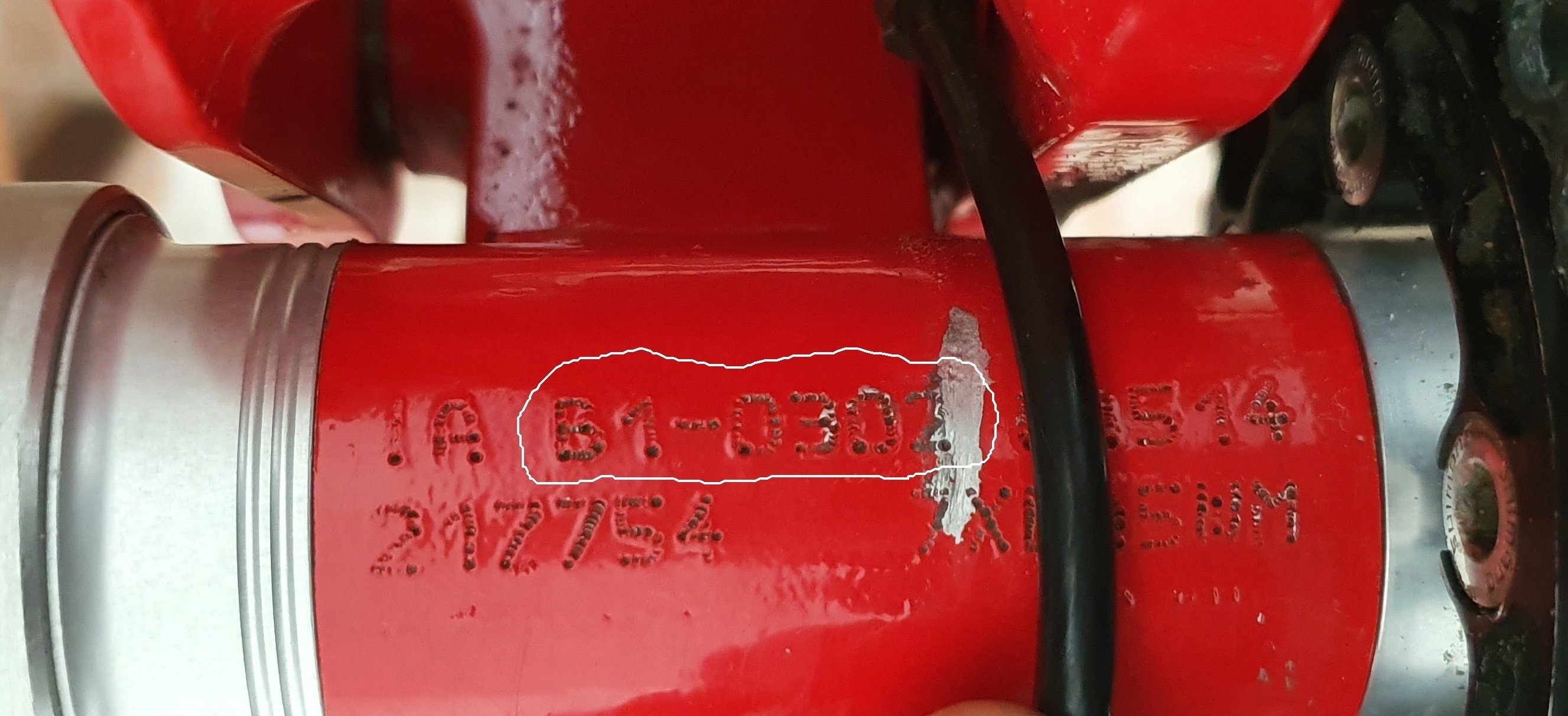

To the left of the A i'm quite sure that there is a dot.
Bike has a fatty 70 fork.
I will try to get some pictures of the complete bike.

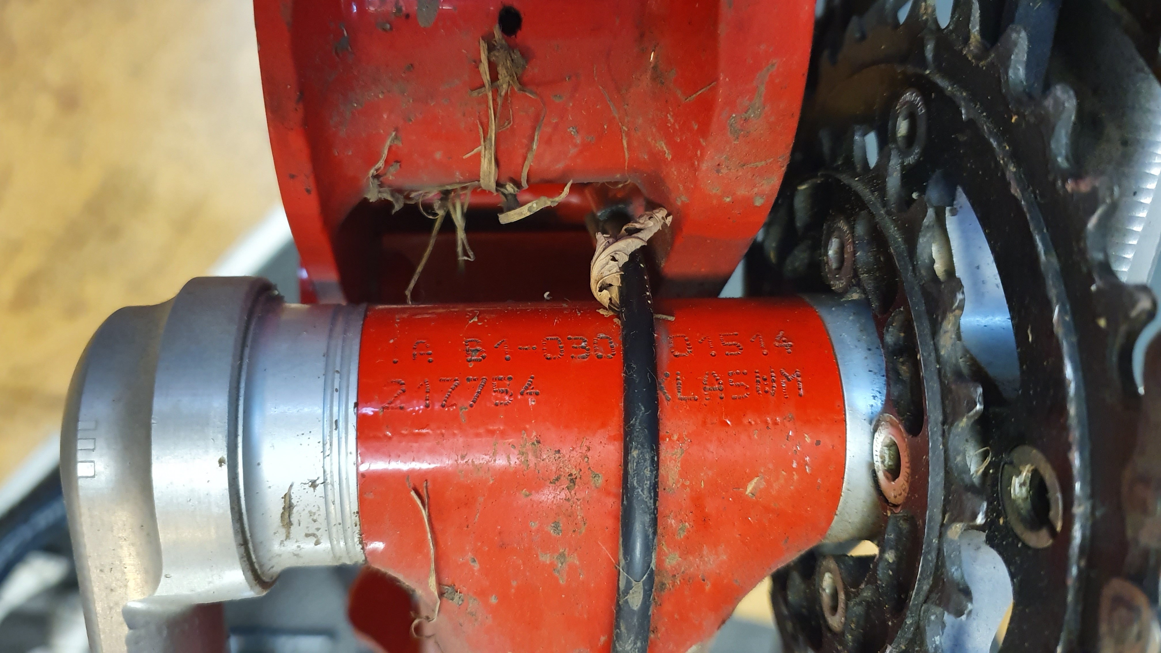

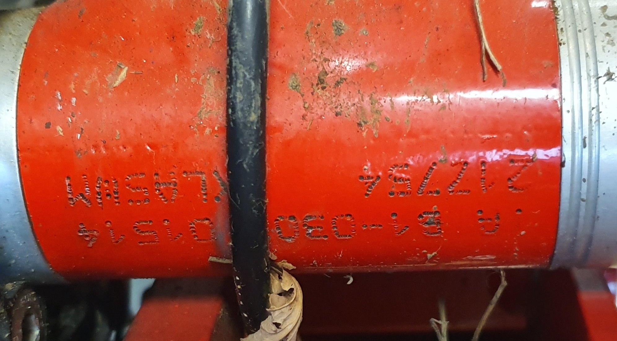

gringo75
i think you were write, looks like that upper left is written "IA"
seems like the difference between a usual frame number is this part shown on this picture.

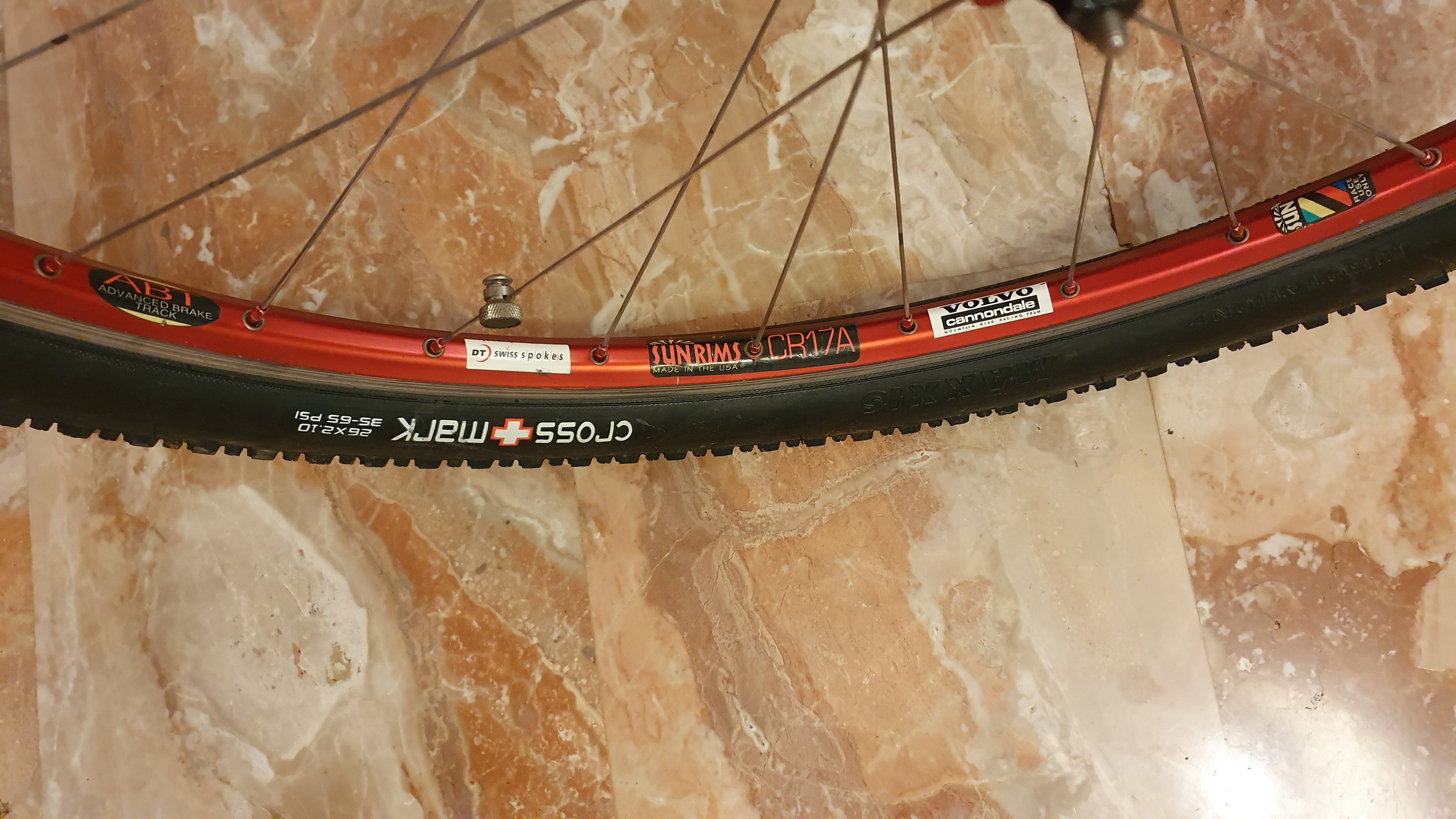

I can't tell if my frame has a number in that spot as it is mostly covered by the cable guide. Yours may have extra numbering related to it being a team bike, which it certainly looks to be. It's missing some original parts though, and I don't know exactly what the team used. I'm guessing that your bike would have had Mavic rims but I believe that the team used Sun rims in previous years. Suns were still being supplied on most 1997 production models but the top end MTBs came with Mavic 220 rims. The Sun wheels were probably substituted for the Mavics when the bike was sold. I've never been clear on what Sachs parts the team used but it may have been only the shifters and chain. I probably have the correct shifters and a new chain here. Since your bike has an XTR front derailleur I'd guess that is what it should have in the rear. I'm not sure about the stem, kind of surprised to see a Headshok Uno. Production models at the time used Coda stems but could well have been made by Kalloy and the Uno stems supplied to the team for advertising.

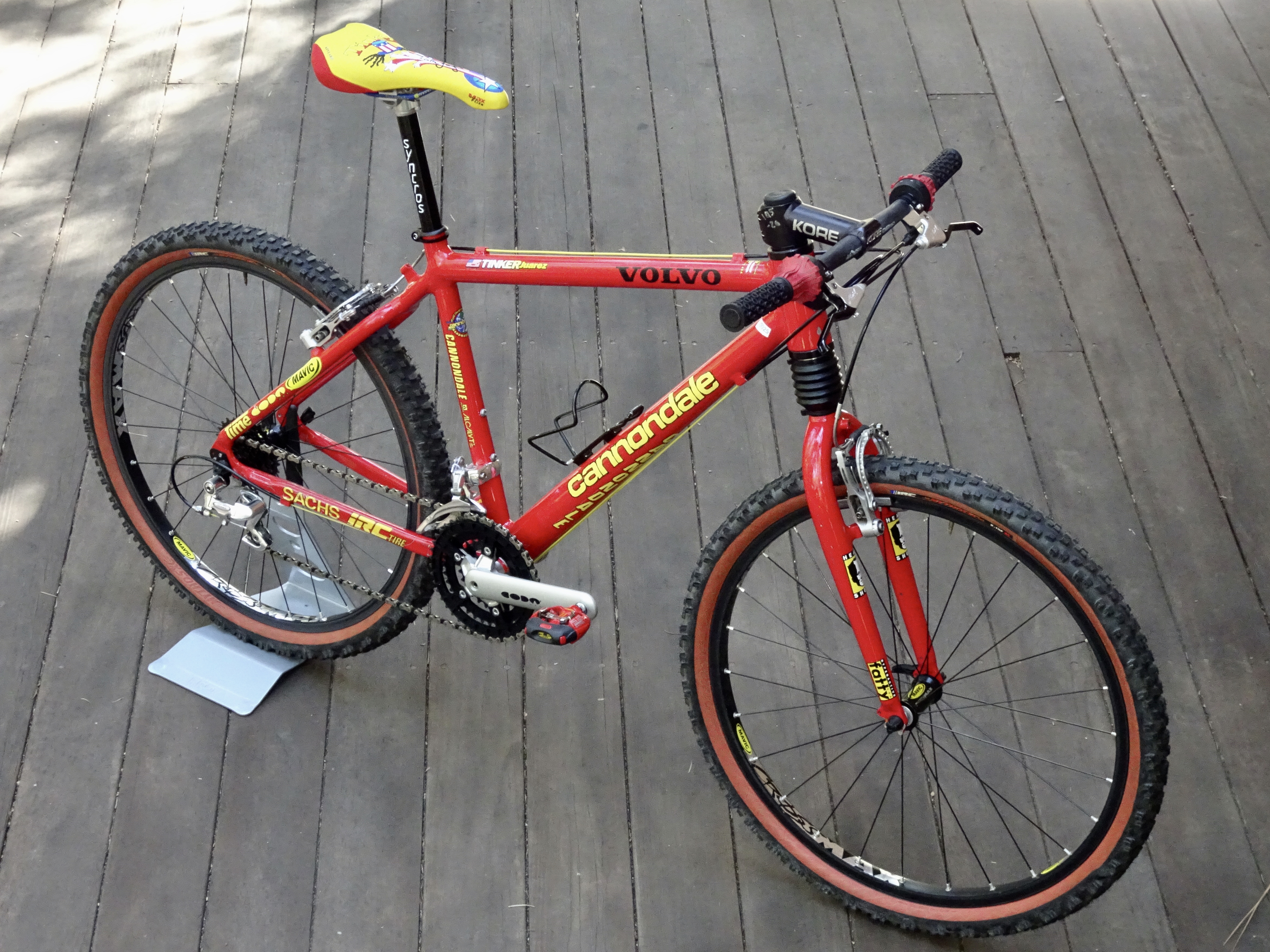

Tires should be IRC Mythos 2.1 K, seat post Syncros Ti or blk alloy, saddles varied by rider ..Vetta, Flite Tech4Fun etc, Sachs Quartz derailleurs (could also be the older new success), Sachs Powerglide 8s cassette and chain (early 97 and before riders were able to choose their components, some used M950), Sachs Powergrip or Wavey shifters, Club Roost bars most likely, Sun rims were replaced during 97' with Mavic Crossmax.
Also Mavic logo on "seat stay" should have a sticker over it with the newer oval logo as this changed mid 96'
For some reason they kept painting the bikes with the old logo and just "updated" it with a sticker. The 98' models finally came with the new logo.

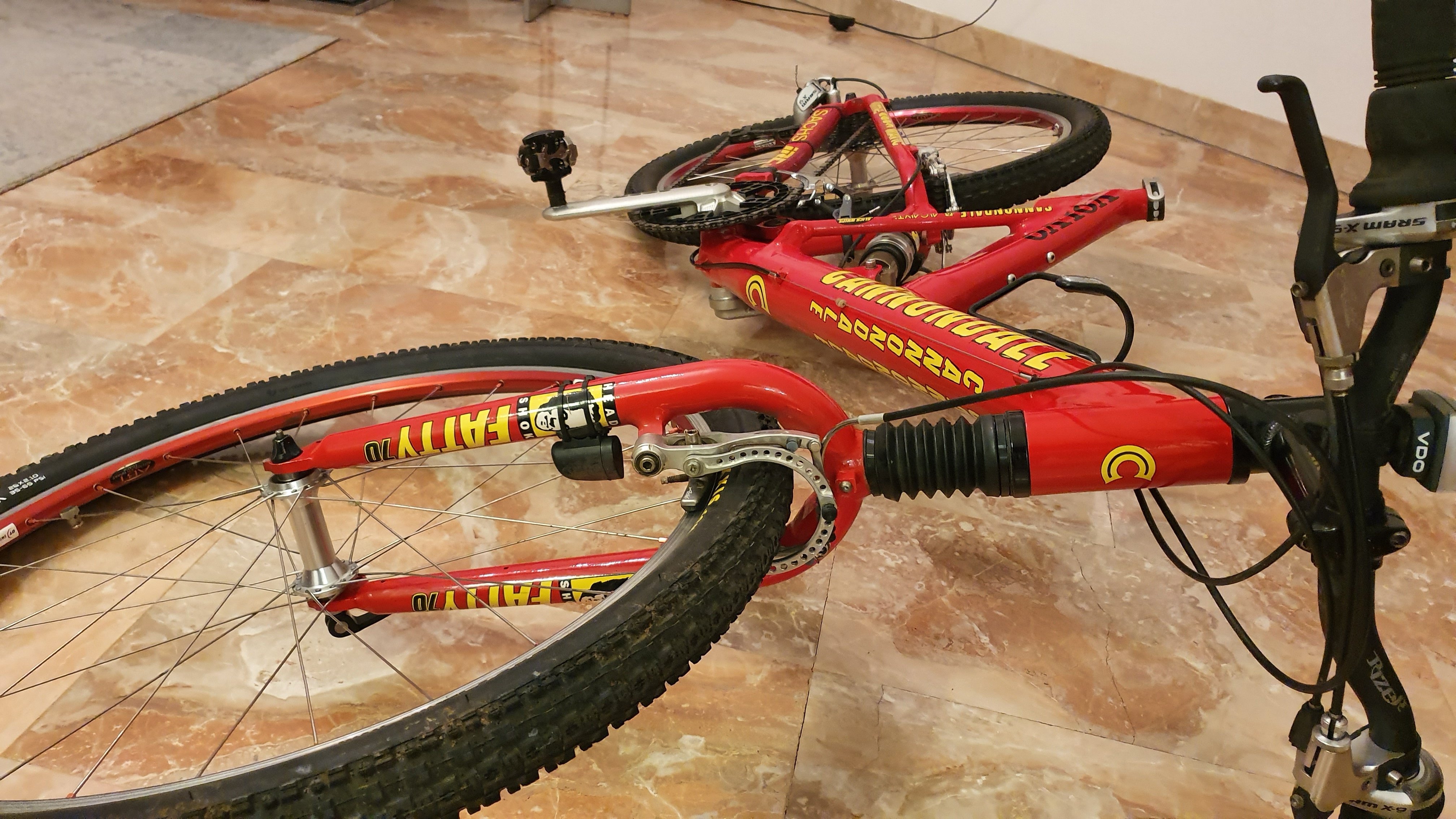

I have or had 4 of the 97' team bikes/frames. 3x CAAD3 and 1x SuperV Libor Karas.

Stem is OG, Avid Arch are a very early model (possibly prototype). I have the same on a team bike, the levers are matte black and the center adjusting knob on the brake is made out of plastic? Never seen those anywhere else than on team bikes.
Housing was usually Gore Ride On with the yellow inner liner. Standard pedals were Time ATAC Ti, but riders could choose to use their own pedals.
