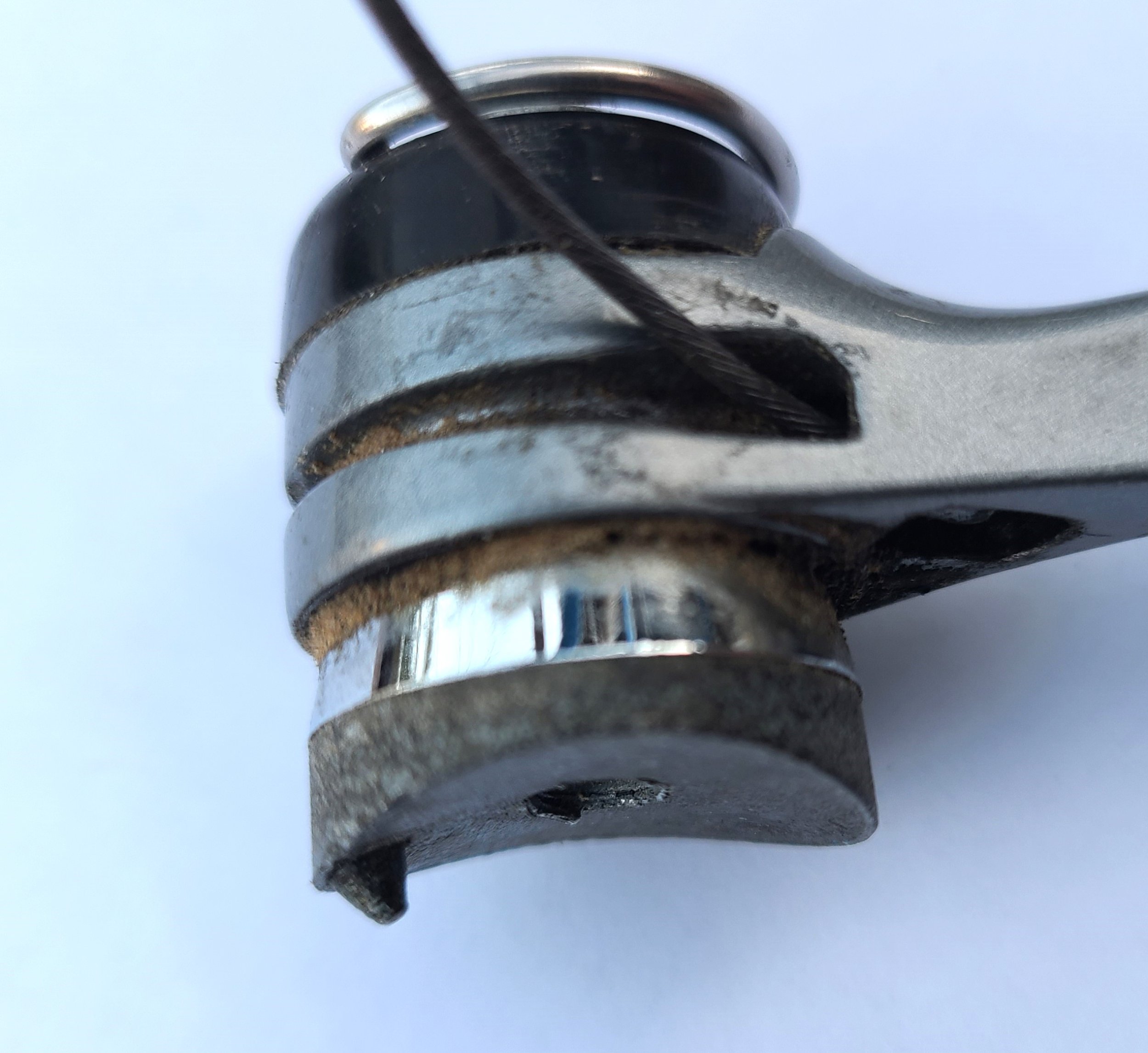

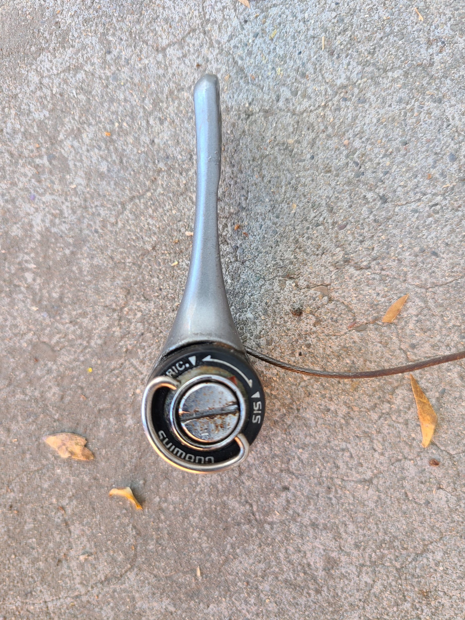

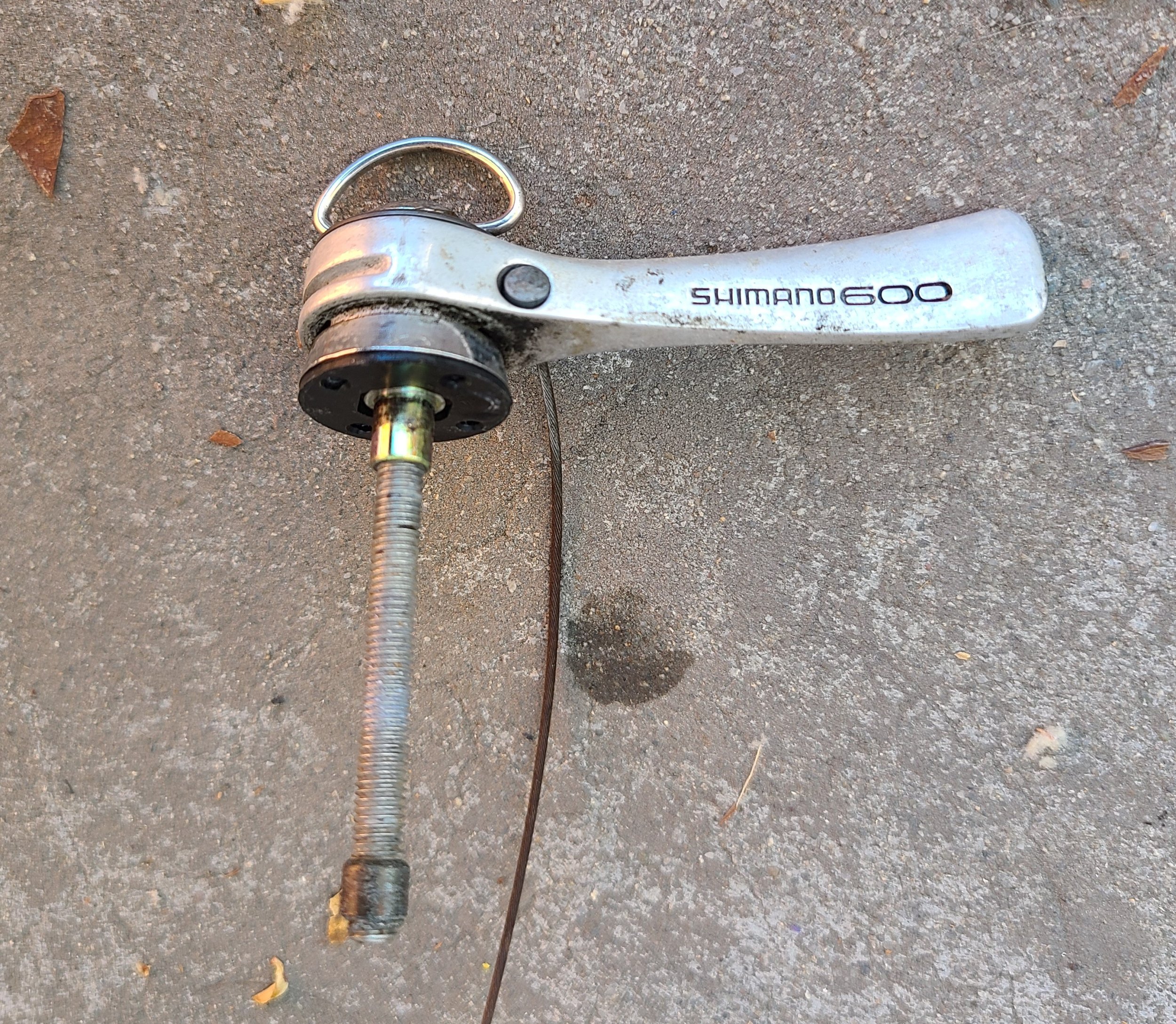

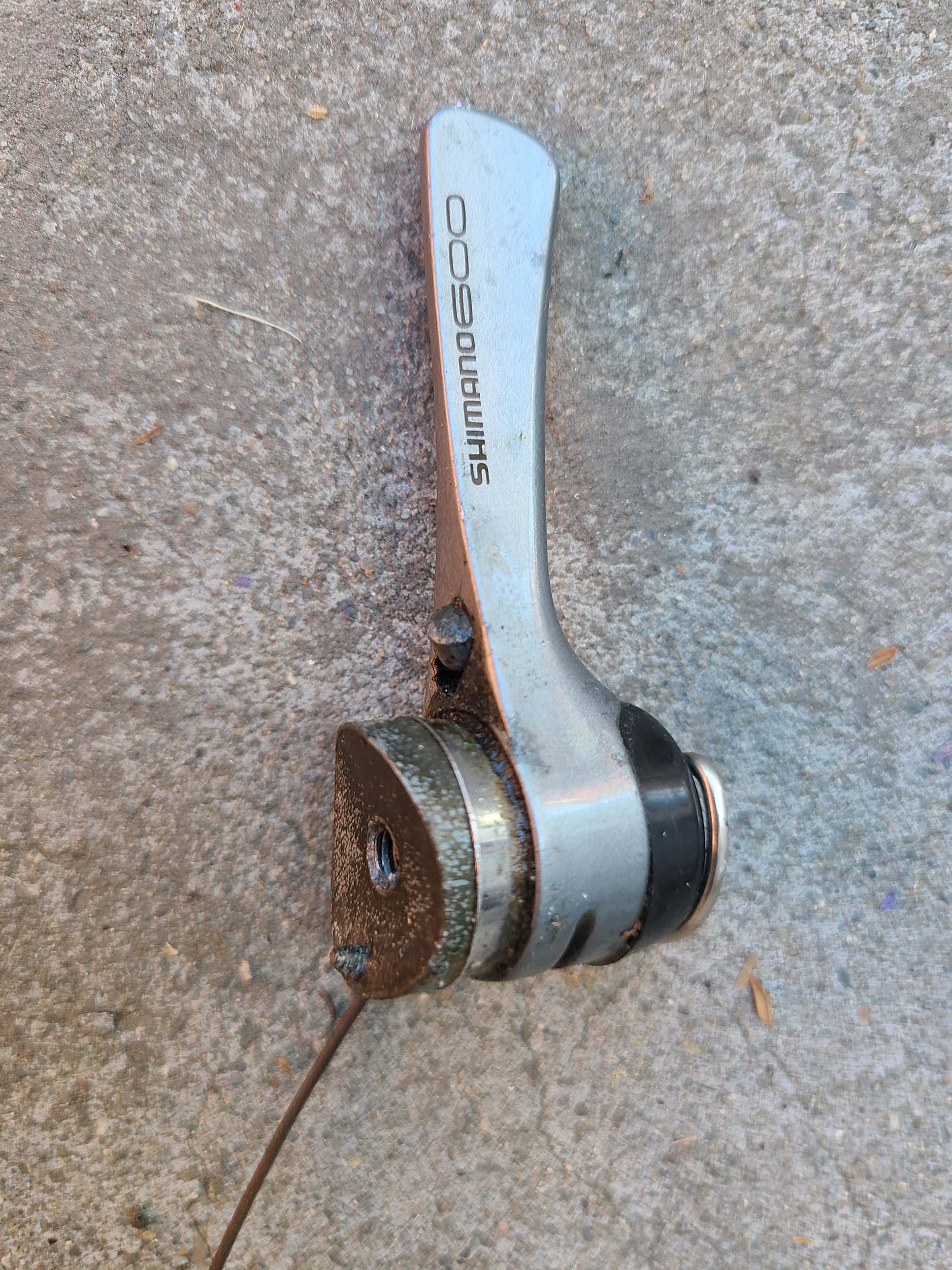

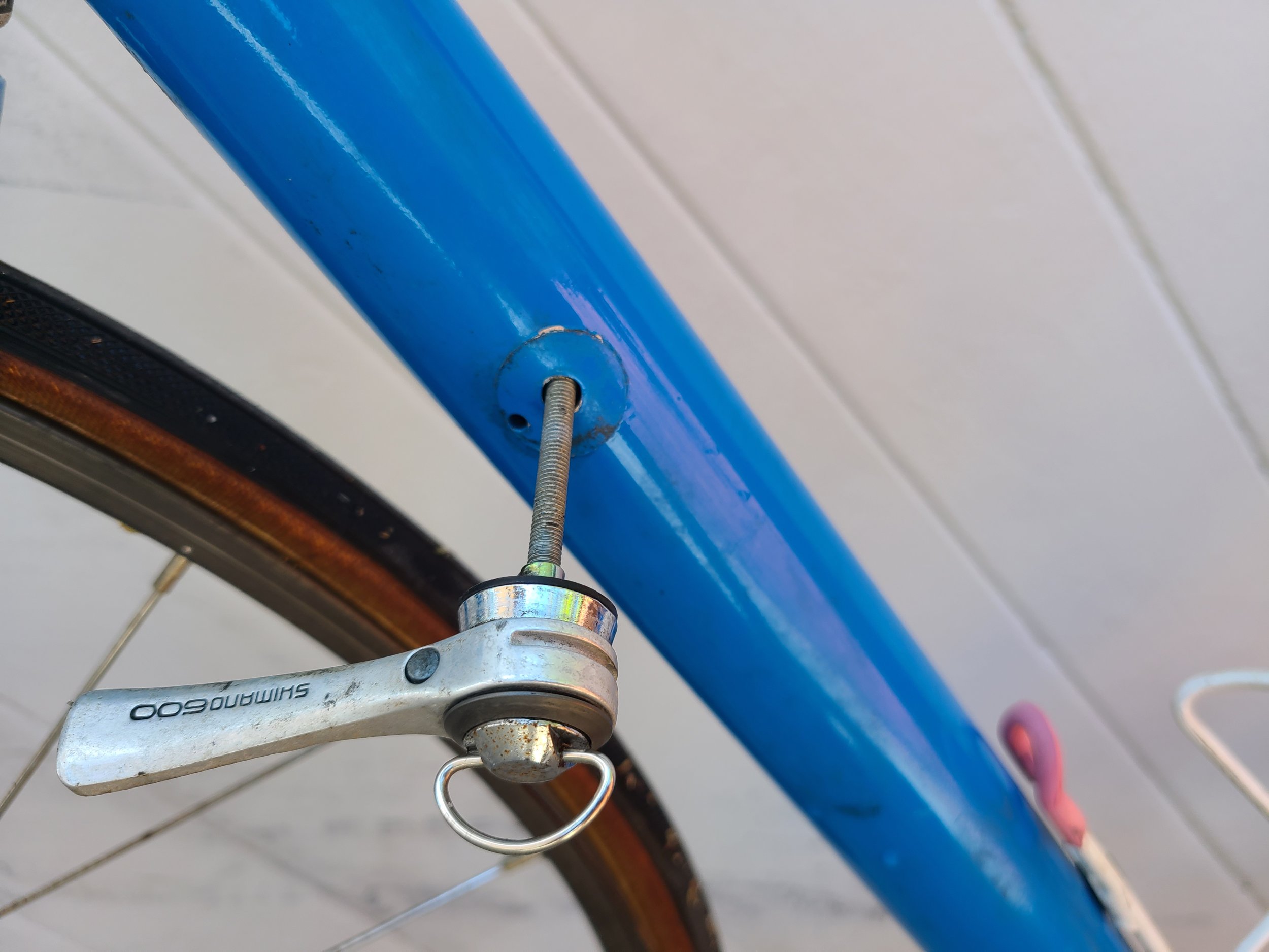

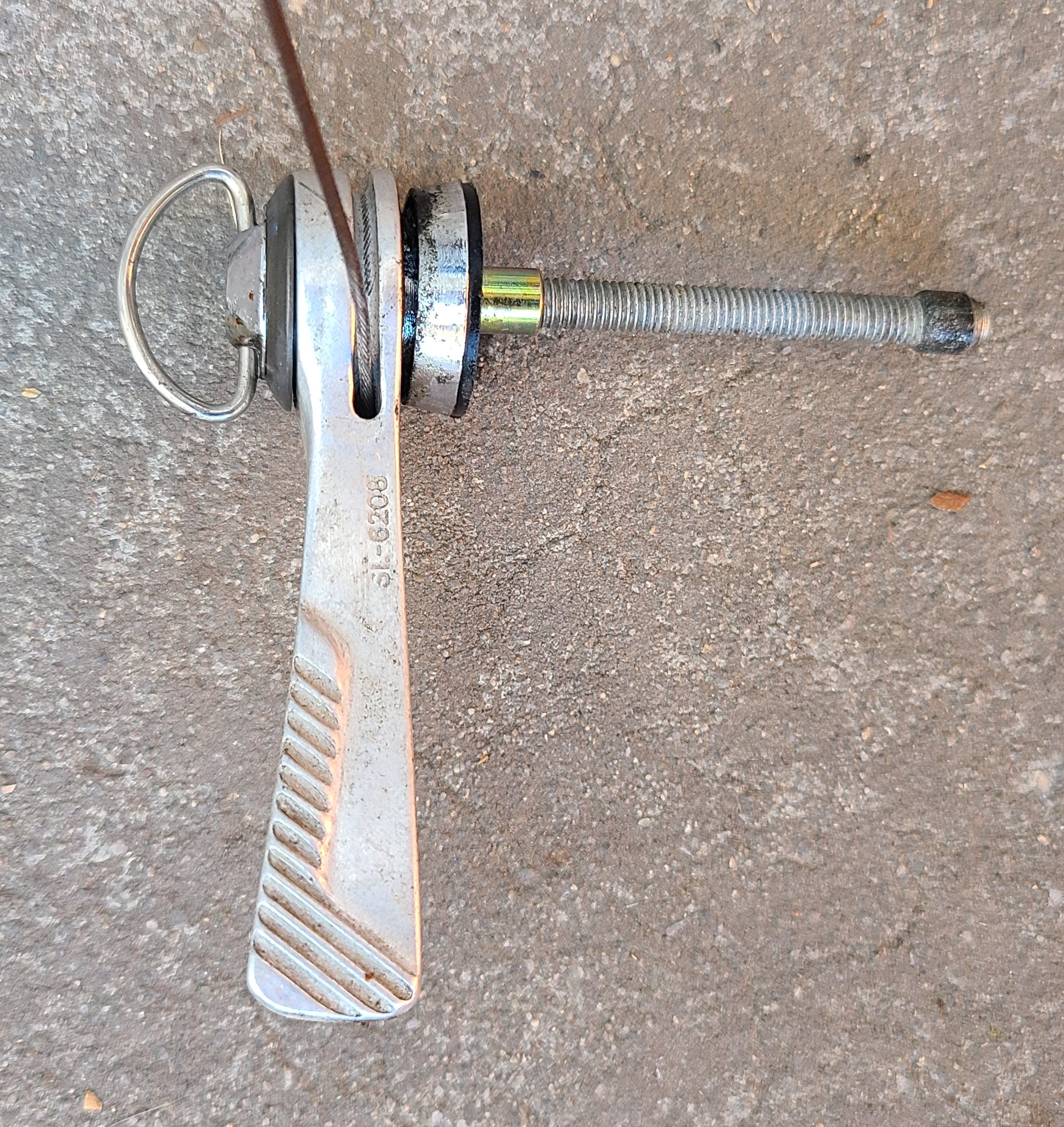

I got this 1987 SR600 from a guy on CL for FREE. The shifter is broken and I can't figure out what shifter model is correct for this model. I've searched on EBAY and other classified but can't find a VISUAL match.
The Right shifter looks to be correct because its mount plate aligns with the small hole on the tube.
The left shifter is a slightly different color and doesn't have a curved plate to mount to tube. It is labeled SL-6208
I've labeled the pix of the shifter LEFT and RIGHT. Can anyone please advise me as to what shifter model I will need to repair this.
Thanks
FYI: This is my first post on this Forum and I hope I chose the right place. Let me know.

Jon K.
Those curved boss covers, I think they're called, are available on eBay. Just search for the model number, SL-6208.
Those are one of four variants of the Shimano 600EX six-speed SIS indexed downtube shifters. The finning/ribbing on the left lever looks like the ones I saw on eBay, though there may have been smooth versions too.

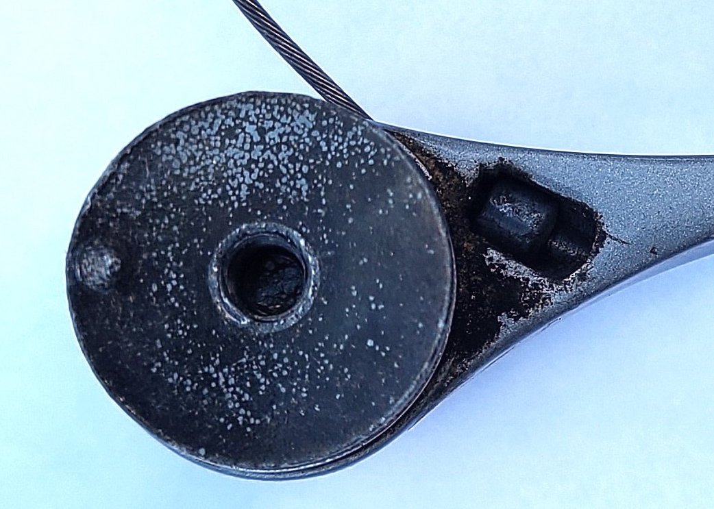

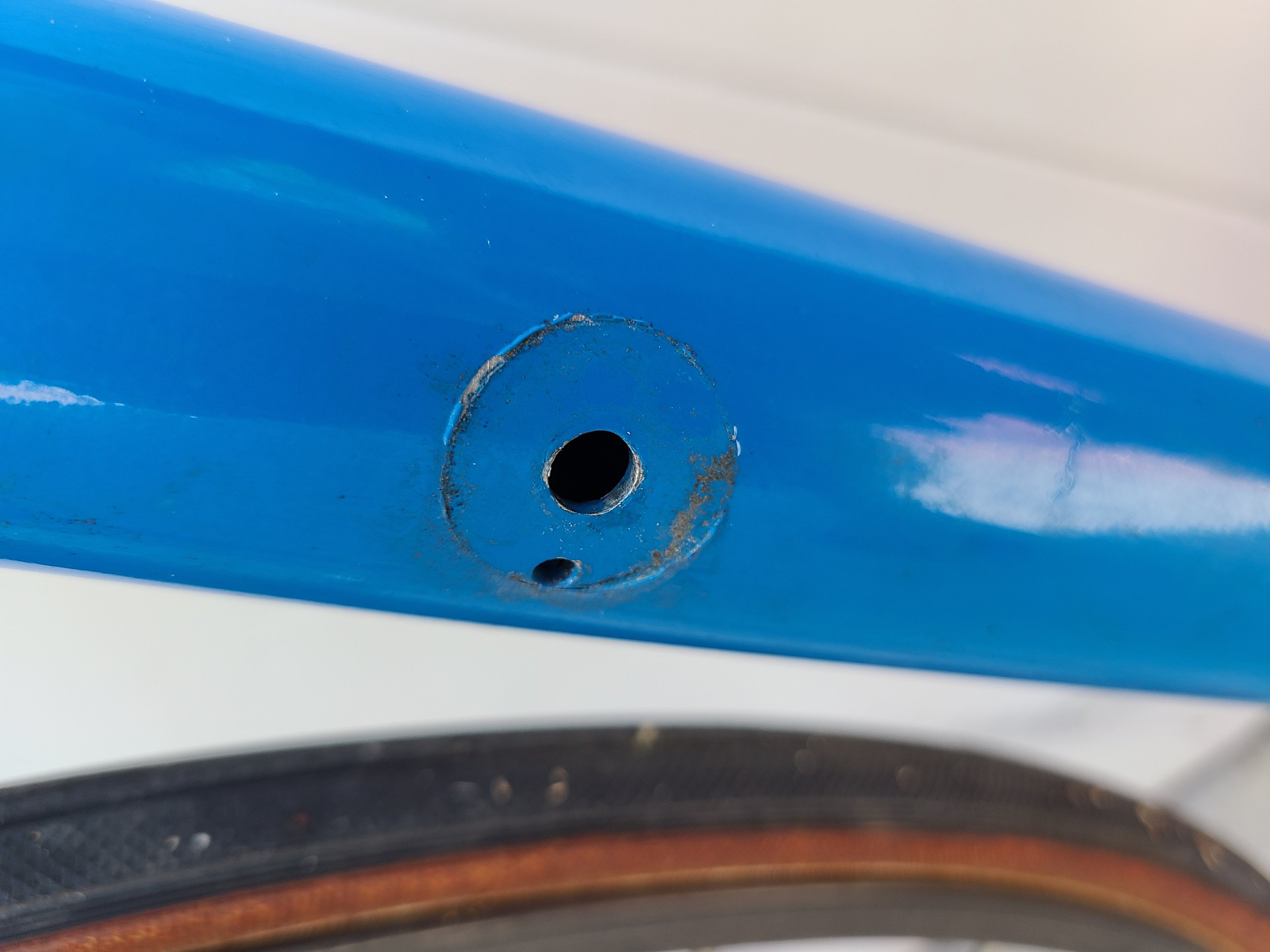

Jon, that Braze-on Boss cover is not the right part.
I've taken 2 Close Up Pix of Right shifter curved piece and you can see the difference. The protrusion fits into a hole on my frame. Also, there is a threaded Rod that passes thru the frame and connects the Right and Left Shifters. Also, you will see my curved piece is solid.

Jon K.
The South Salem Cycleworks link I posted says something about a set of "Shimano 600 SL-6208 6-speed braze-on downtube shifters with Keyhole braze-on adaptors." I don't know what a "keyhole adapter" is, and the photographer didn't bother to take a picture of said adapter.
There's a Shimano catalog from 1987 on the website here; it's a bit hard to read but it may have some information. The SL-6208 was the SIS indexed downtube shifters, the SL-6207 were friction only, it appears.

ricogonzo
Thanks Jon. You've solved the riddle! Keyhole Adaptors.
I was able to check out the EBAY links and now I know what to look for.
Jon K.
Hey Jon, South Salem Cycleworks has what I need in stock. It is original to my bike.
Cannondale 47mm Shifter Boss Kit. Used, $65.00/each
