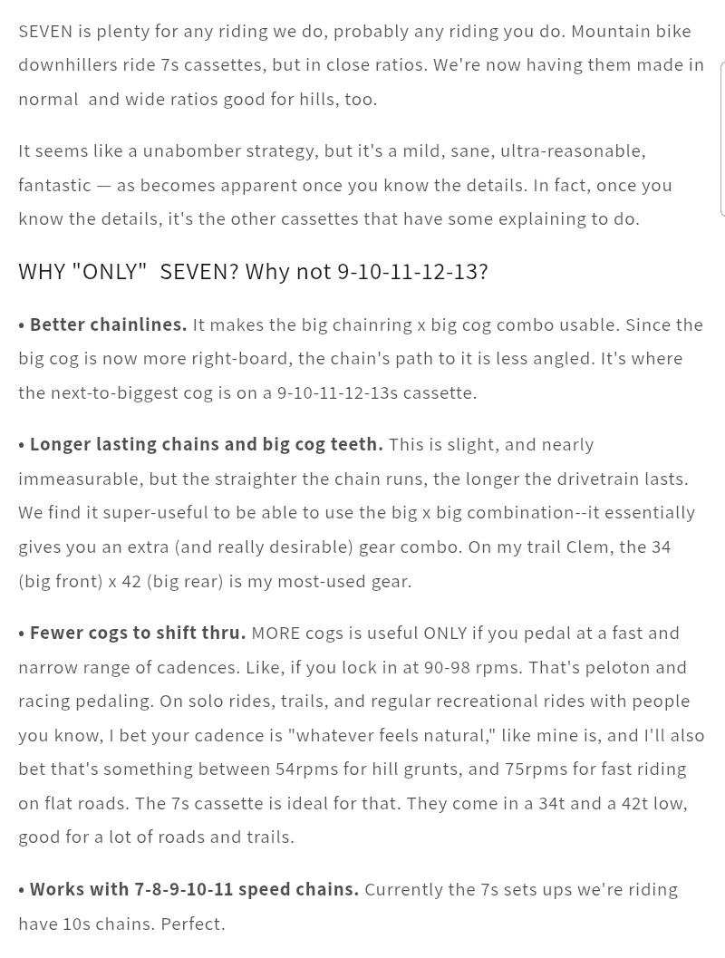

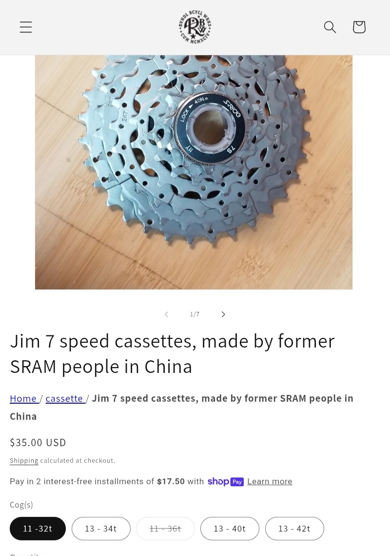

Just for fun I went looking for 7 speed cassettes and found these at Rivendell in California. I've never seen anything like these sizes. Probably a vintage derailleur would be only capable of the 32T sprocket.

That set up of a 22T chainring and 28T large cog will give you a 21.2 gear inch low which should suit your needs. If you can find a cassette with a 30T rear cog that will get you down to 19.8 inches. Two things of note: The smaller a chainring is the faster it wears (although you just use it for steep climbs). Also 7 speed and 8 speed cassettes are disappearing. Any 7 speed cassettes on the mass market are intended for inexpensive recreational bicycles.
letsbike, Just saw this post of yours, for which I thank you. Since the cassette would give a lower gear than the 13-32, I am changing my thought about the latter in favour of the 11-32. What derailler would you suggest to go up to a 34?

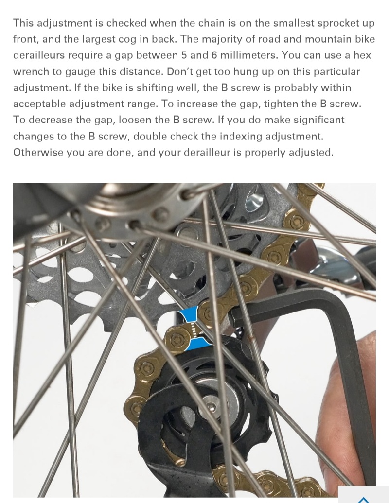

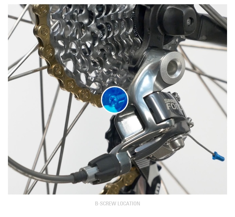

If the bike you are looking at has a Shimano XT rear derailleur it should handle a 34T cog. I am running a vintage 2005 Shimano 105 long cage derailleur and it works fine with a 34T low. Just make sure your B screw is properly set.
The following pictures are from the Park Tool website.

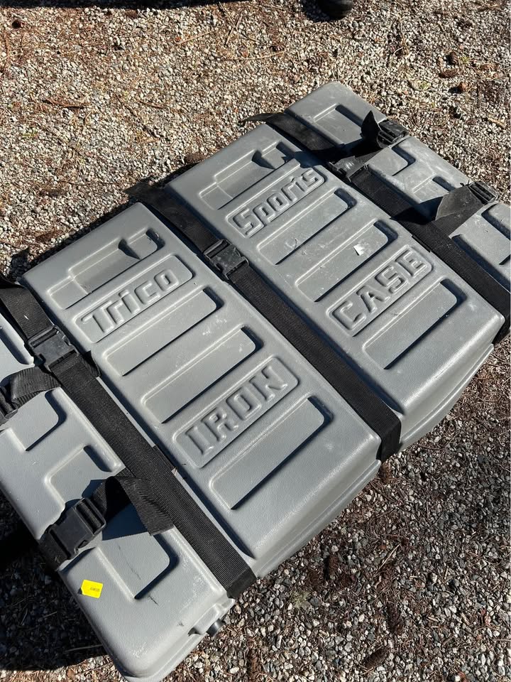

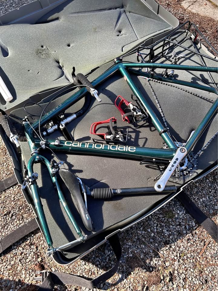

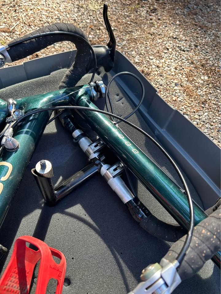

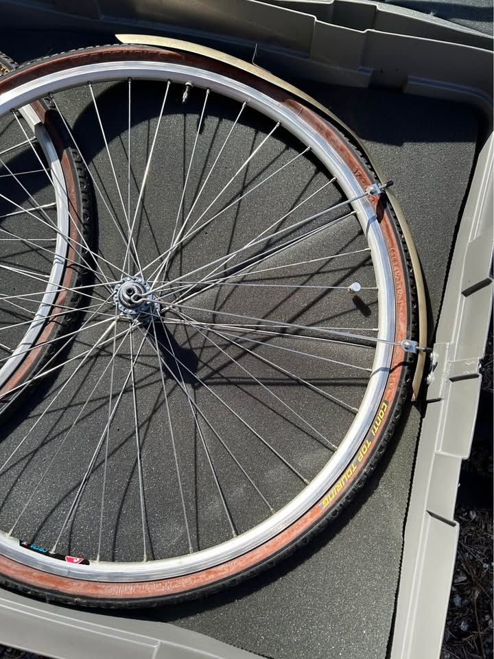

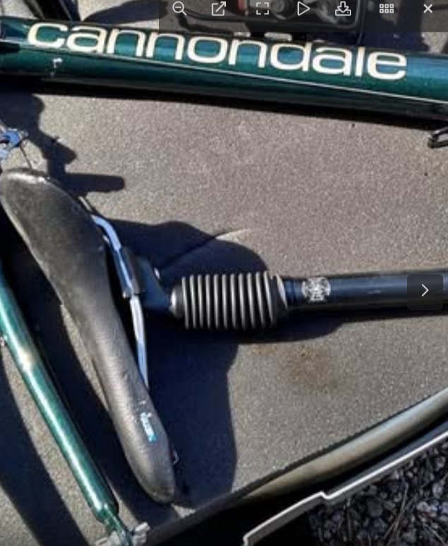

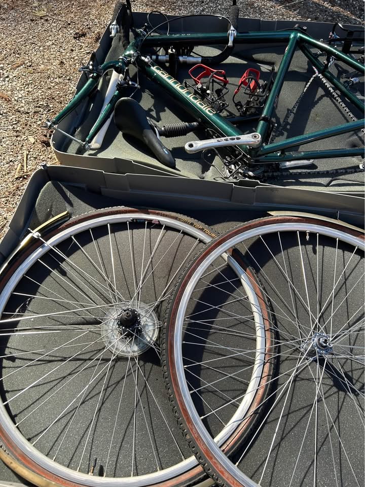

Letsbike, Thank you for this. I just made the deal on the bicycle today and will check out the rear derailleur once I actually have it in hand. Here are a few photos from the seller's ad - Cheers!
The frame looks very good, and that's the heart of the bicycle. Everything else is just a part. I am looking forward to the assembled pictures in your driveway that I am sure will follow soon.

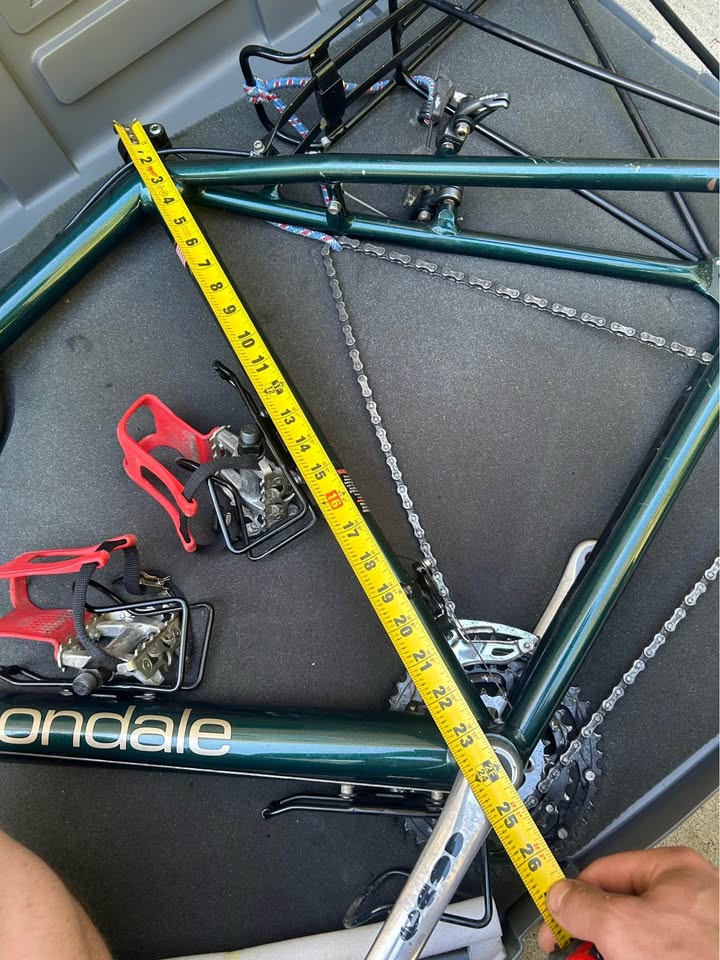

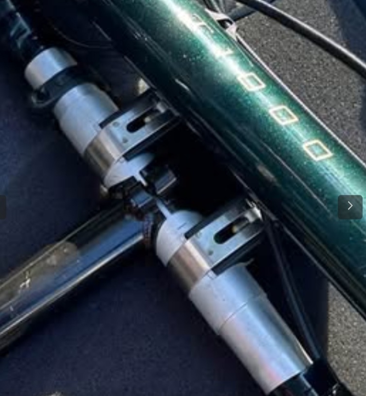

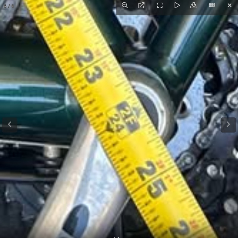

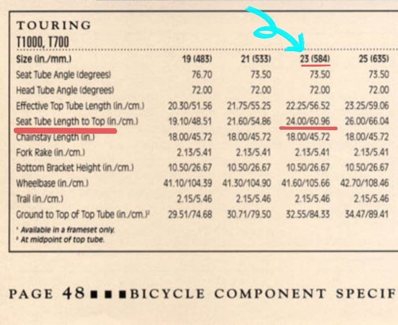

I wanted to point out a few things on that T1000. First someone added a shock post (nice). It has a bracket for a Cannondale brand bag (very nice). But I am afraid that it is also a 23" frame, not a 25".
Don't think that size is a deal breaker though. On the next version of the Cannondale touring frame, the CAAD3, that dimension shrunk an inch. So my 25" 2001 touring frame, which I find comfortable, has a seat tube that is 25" long. That is only an inch difference to what you have. You could probably easily overcome that by raising the seat and stem, which is a lot easier to do with a quill stem such as that 1994 bicycle has. You might find that the handlebars are closer also. Not a bad thing. You'll just have to see in person.
Swell
Letsbike, thank you for your posts, particularly identifying this as a 23" frame. Given that is identified, it can be dealt with as you stated. It is a bit of a disappointment that the frame turns out to be 23" instead of 25, and I shall just have to see how it can fit. My F1000 is a 23" frame, and I do enjoy it but sometimes it seems a little small. A concern I have is the distance between crank centre and front axle, as I don't want to hit the paniers with my toes, but I will just have to put it together to find out....who said things are supposed to come easy in life? All the best!
I think that you will find your clearances to be just fine. It is the fenders hitting your toes that might be a concern, but less of a issue on a long wheel base touring frame than on a road or recreational model. As I said earlier, it is a great looking bicycle. Bring it down to the states and we'll try it out.
