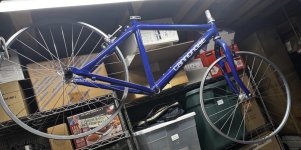

This blue frame ialso has the 1.25” steer tube and I used the Nitto piece. Now I need a winning lottery fund that build.
